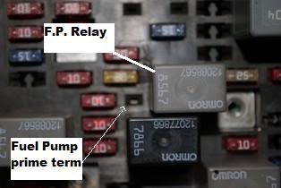

Not surprising at all to have fuel pressure increase when you shut the engine down, in fact, it's perfectly normal. Checking fuel pressure at idle is the lowest pressure you should see. We're not concerned about the lowest pressure, we need to know the highest pressure. There are no "engine running" fuel pressure specs for this engine. All tests are made with the engine off.
In the underhood fuse panel, (on 1998 and newer), there is a vacant terminal next to the fuel pump relay. It is commonly referred to as the pump prime terminal. The circuit goes directly to the fuel pump.
Connect the fuel pressure tester to the service port next to the distributor.
Connect one end of a fused jumper wire to battery positive.
Connect the other end to the pump prime terminal.
When fuel pressure stabilizes, write down the reading.
Disconnect the jumper wire.
Wait 10 minutes and write down the fuel pressure again.
Post both readings.
The results will determine if a problem exists with the fuel delivery system. If there is a problem, they will not tell what or where the problem is; Further diagnosis is necessary, and we can explain how to pinpoint the problem.

Ok, after preforming the test as described above i go tthe following numbers:
fuel pressure at 58-59
after disconnecting the jumper wire for 10 minutes the pressure dropped to approx 56.
