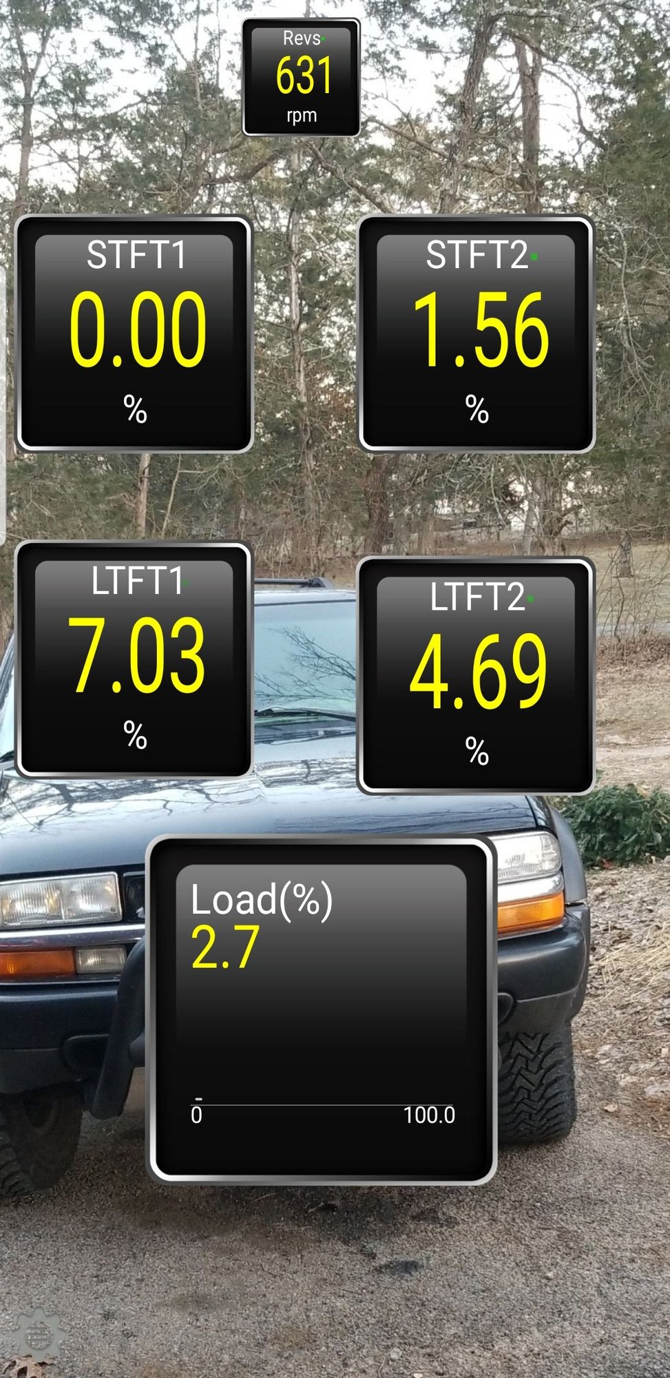

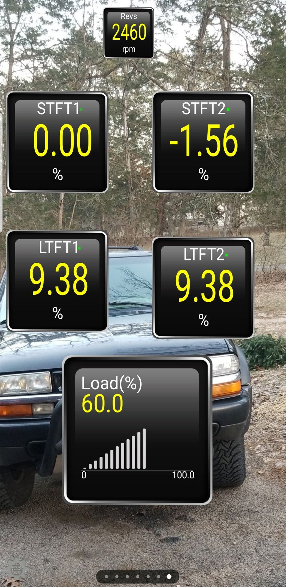

Does this help any. I tried making it as best as I could using torque pro so let me know if this gives you any different info. From what I see they all seem to balance with each other

In either case Your fuel trims are around 9%. That means ECU is prolonging the injection time for 9%. If it was only on idle, I'd say You may have a vacuum leak. But, as it occurs on wide variety of RPMs I'd convince to a fuel pressure regulator producing slightly lower fuel pressure than needed.

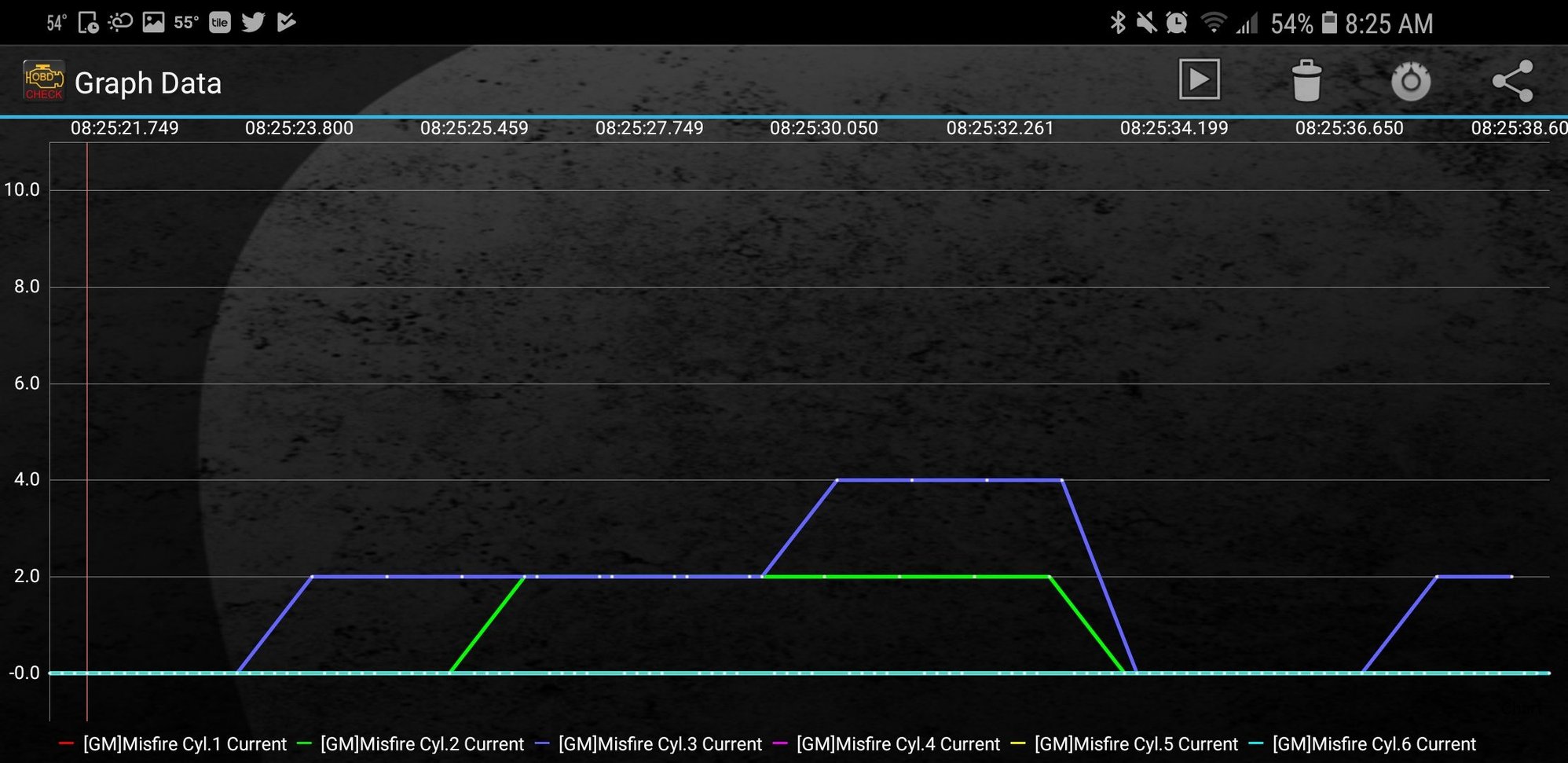

Idle. Cylinders #'s 2&3 misfire

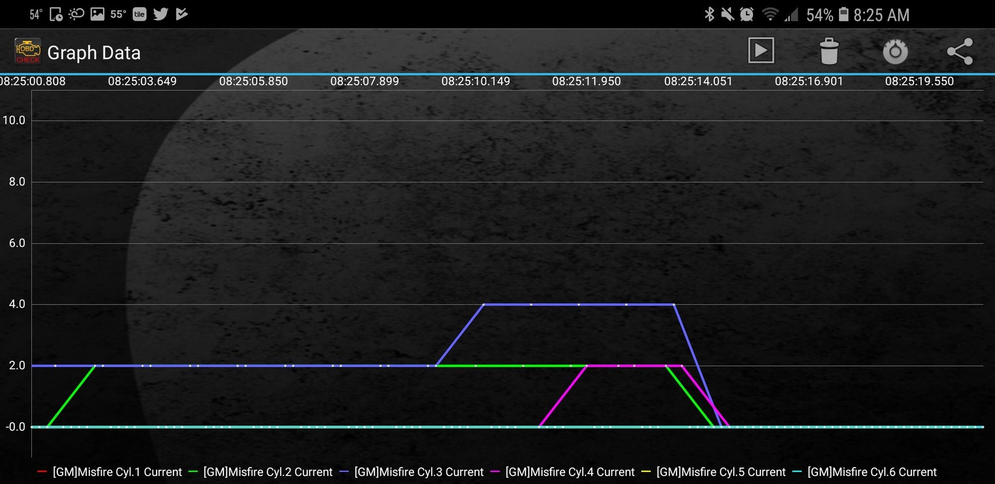

Few sec. After that caught cylinder 4 misfiring at an idle aswell

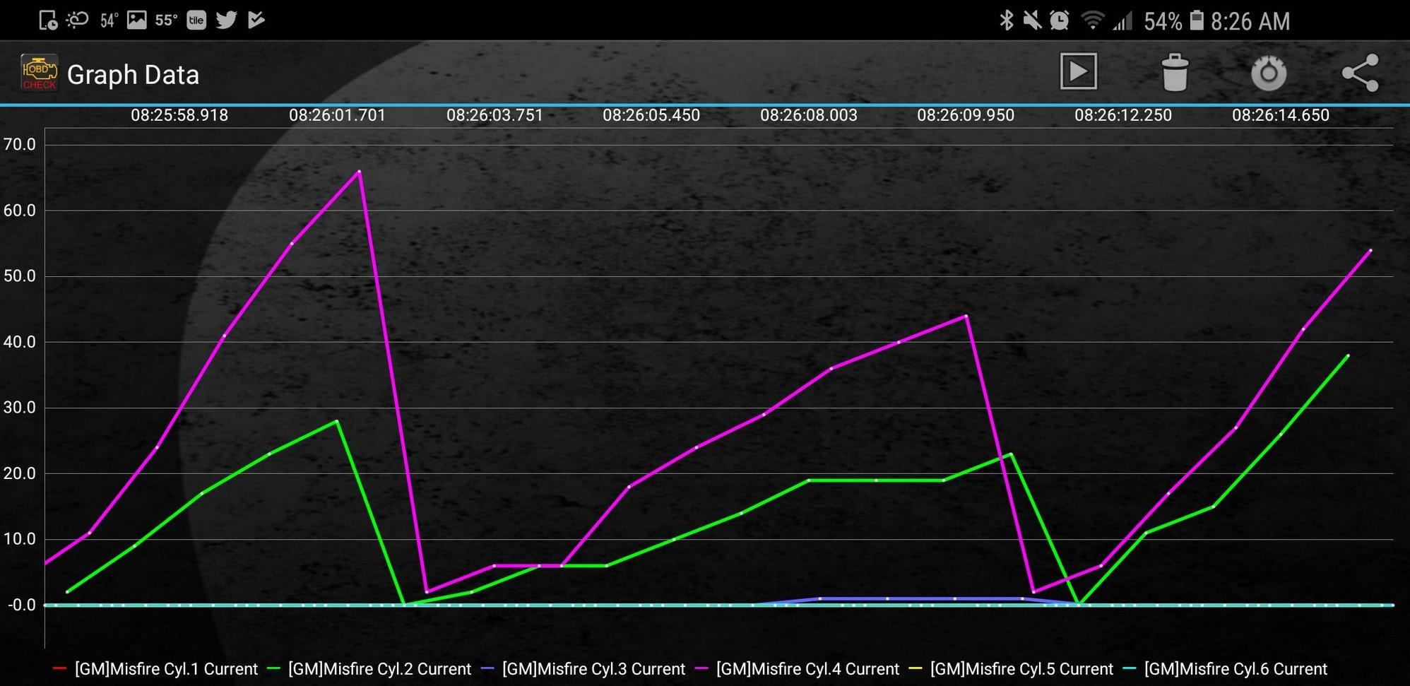

1500 rpms for the entire 16 sec you see here. Mostly cylinder #'s 2&4 but also was reading 2 count on cylinder #3
*note x axis changes derasticly*

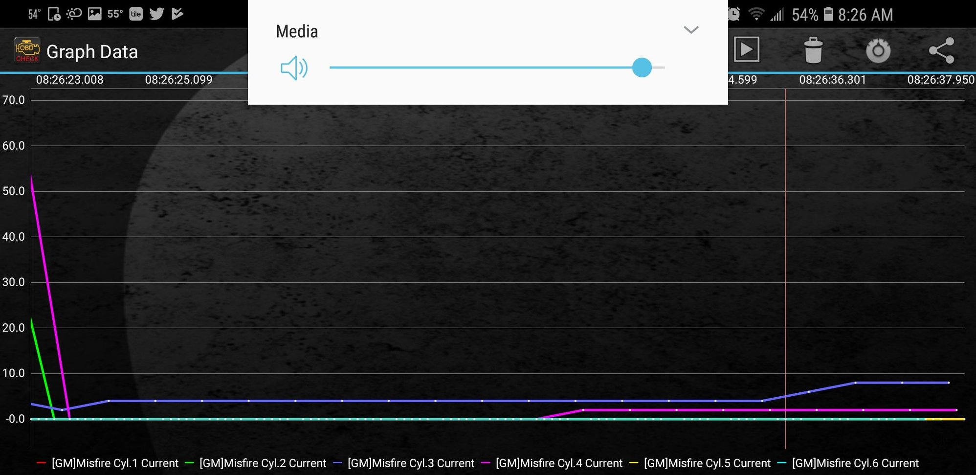

Letting it go back to an idle just after the 1500 rpms

Counting up to 2 or 4 misfires before counters reset is pretty normal behavior. What you are seeing on cyl #4 and cyl #2 misfire counters is not normal, and this is happening only at speed and not at idle.

Another thing you should know is that both Torque Pro and Car Gauge Pro get two of the cylinders on the Blazers switched in the misfire counters. #1 cyl is one of them, but I can't remember the other. You should test your misfire detection anyways by pulling a plug wire on one cylinder at a time and starting the vehicle. If it is working correctly, misfires should rapidly count up on the cylinder where you have pulled the plug wire. If it doesn't your misfire detection is inoperative and cannot be trusted.
