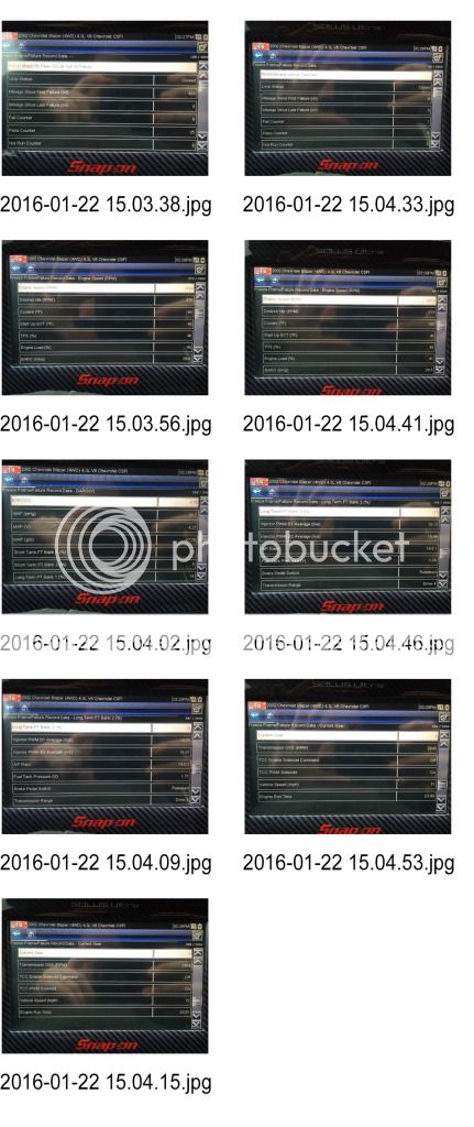

I went 2 weeks with out the light coming on. Here in MN those were a few very cold weeks. This morning driving into work I got a P0101 and P0300. I checked the data that was stored and this is what I got. Could the mass air flow sensor be bad which fired the P0101 code and in return cased a misfire?
https://www.dropbox.com/sh/309f9crtf...5vTSp6CRa?dl=0

Then, just for grins and giggles, plug in that Solus again, only this time, don't cruise down the freeway while you're testing Engine at idle, normal operating temperature, (195F - 200F), PCM in closed loop, Transmission in park or neutral, all accessories turned off. Post images just like you did in your previous post.
