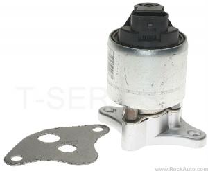

You may not have an EGR on your vehicle...'02 is the year they transitioned to NOT having one...and I think they didn't have them through to '05.... IF you do it looks like a mini soup can with a connector coming out of it, sits on top of engine. I'll try to find a pic to post for you.... and if you don't have 1 the chances are 1 or more of your spark plugs are walking out. Probably a good time to pull a few and check them anyway see how they look, especially if you haven't had a tuneup in a while.
I hope this helps, post an update, let us know how you make out.

I can check the spark plugs. I did a tune-up a few months ago. The info I found said one issue could be that one or more valves that lead to the charcoal canister are stuck and just need to be cleaned. Is the EGR valve one of them?

P0400 is a problem with EGR flow. 2002 does in fact have an EGR valve. 2003 through 2005 "X" engines do not. The valve is located top, front, center of the intake manifold. In between the thermostat housing and the serpentine belt idler pulley. Might be worthwhile to remove the valve and clean it out with spray carb cleaner. DO NOT move the pintle valve, unless you want to buy a new EGR valve Install a new gasket with a screen. Most auto parts stores have them in stock.
