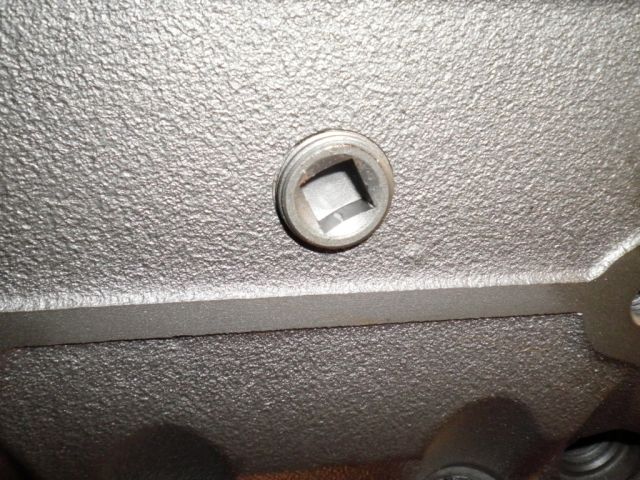

I've done it again! I mounted the heads on the opposite side. This plug is on the wrong side now. I need to know the name of the tool used to install and remove it is. Where to get one?

Sometimes its just a 3/8 extension. just stick a extension in it and see if it fits

yea an 3/8s extension should work
I wonder if they got a tool to remove those tho
I never seen one before

Nope, 3/8 does not fit.

its smaller ?

3/8s to big

Default Last time
Last time I used the wrench in my piston ring compressor. This one is in there.

how about a 1/4 extension ?

That would be way to small. I just called my machinist and he does not have one. He did not know what to call it either.

i was looking at a craftsman catalog and cant find any thing to remove that
I tend to still search for ya ill post if i find any thing
edit: i was looking on an other forum and found that someone used this
it was 5/16s and they used a open end to turn it
they tend to call it a key stock
