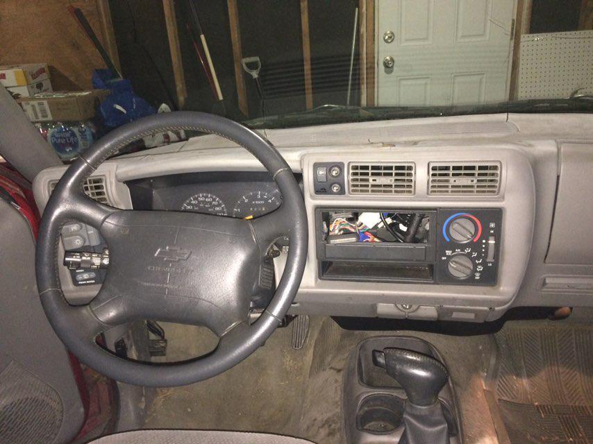

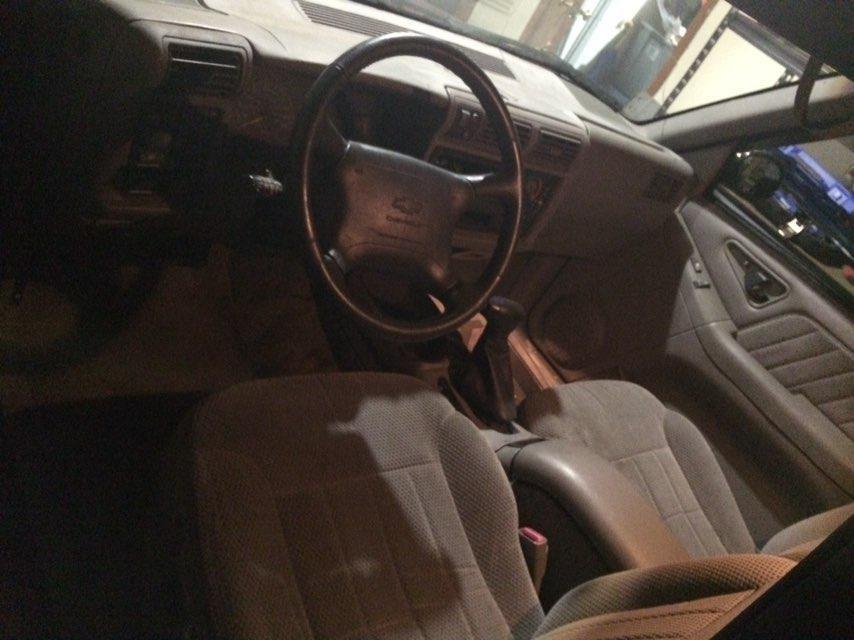

Some images of the interior. Other than being dirty, mostly in good shape!

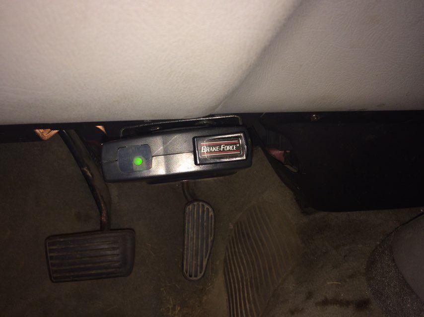

Bonus: Has a Trailer brake controller!

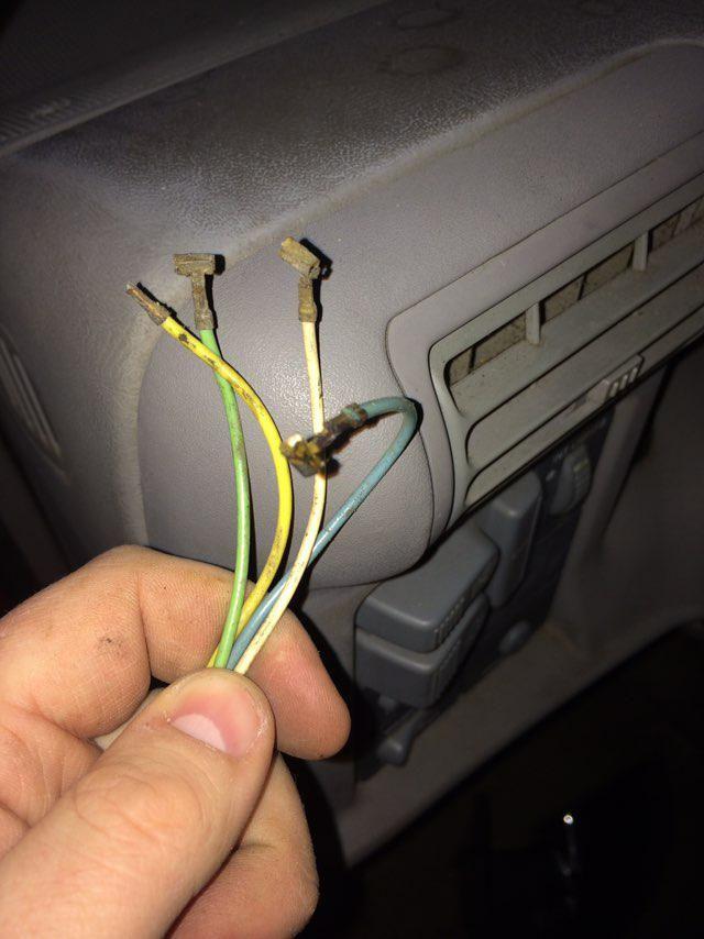

Next Question! The previous owner installed some janky aftermarket mirrors that are WAY too small for this thing. I plan to reinstall original factory mirrors. Thing is, I keep finding options of "Powered w/o heat" and "Powered w/ Heat". How can I tell which I have? I know they're powered because I have buttons on the driver door for it. But when I cracked into the panel to find the wires, all I found was what I will post below:
I'm assuming these are the mirror wires, as they were near the area and the only ones disconnected. Can anyone inform me which mirrors I had by these wires, maybe?

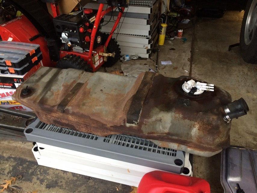

  • The Fuel tank, Fuel Pump, and that annoying valve at the front of the tank. This was the repair that nearly broke me. Having to replace that valve SIX TIMES because of the plastic breaking constantly, and then damaging the tank in such a way that fuel would pour out from it if filled too much. She now has a brand new tank and everything to be safe. Fuel filter also replaced.

Old fuel tank.
New Fuel Tank.
