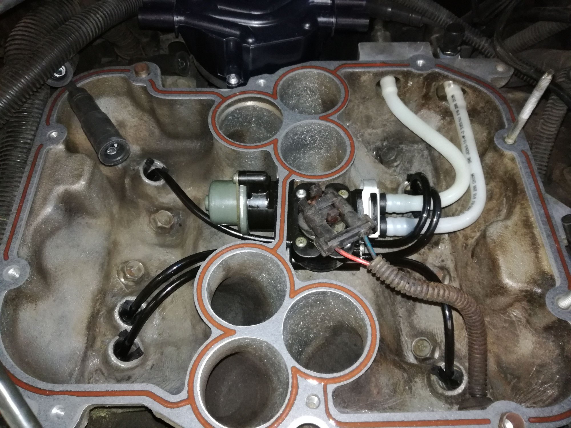

After several years I manage to find the solution by accident seems that the injector spider started leaking some time later after changing the fuel pressure regulator, so I ended replacing a lot of things again:
Spark plug cables
Rotor and cap
Complete injector spider
fuel filter
And completely cleaning the upper and lower intakes, seems to be running rich but I expect for it to settle after a while.
Just cleaned upper intake
Just cleaned lower intake, new AC Delco injectors, new cap, rotor and Ac delco spark plug wires
