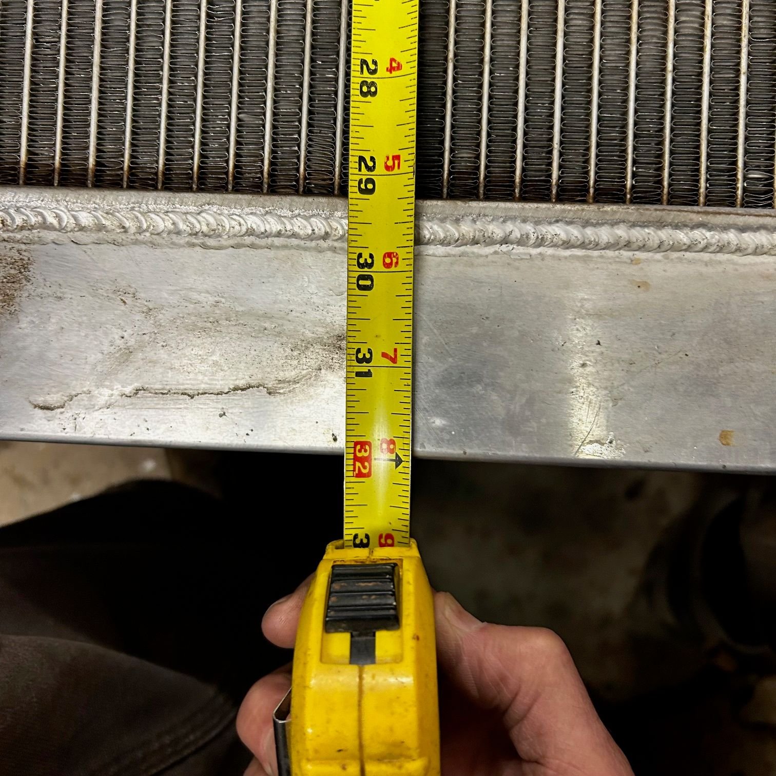

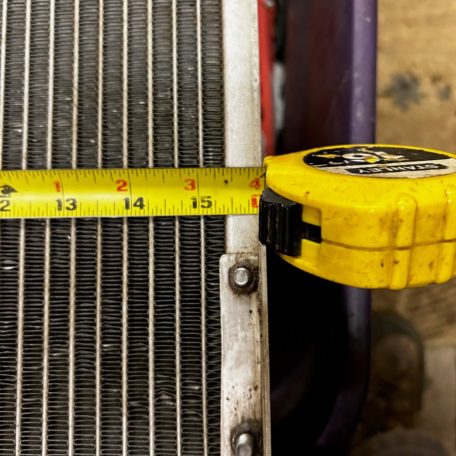

So I have a cracked tube on my all aluminum radiator. If I can;t get it fixed I am hoping to get a similar replacement. All of the replacement radiators I have looked at, both OEM and aftermarket do not have the same dimensions as mine. Where mine is 32" by 16", most of the others are showing a height of 17" or better. Are they measuring to the top of the filler neck? (And the mounting tabs?) If so that does not seem to match what I have been told as far as measuring overall dimensions. Mine has electric fans and the housing fits perfectly on the 16" frame. Do I have a "one-off" radiator? My concern is the upper radiator support and the clearance for closing the hood and the AC hoses. I would prefer to keep it all aluminum or brass and copper and avoid the plastic tanks. Also my thickness is 1 3/4" so guessing 3 rows but not sure. Have also seen super thick ones that won't work either. It goes in a 2001 ZR2. Thanks...

That's definitely not a factory radiator.
Oil cooler needs to be flushed because the oil going through it subsequently gets circulated inside the engine. Otherwise the rest of the radiator doesn't matter.
Mounting them solid like that one is, can definitely crack the tubes when the body flexes.
I would go to the pick and pull and get what you need to put a new factory style radiator back in, along with a shroud and a normal clutch fan. I'm running a $80 plastic-tank factory radiator since 2014. These Blazers don't have any trouble cooling in 100+ with the A/C on (at least mine doesn't).
If you want to chance another solid mounted cheapo aftermarket radiator, try something like this. Seems to be exactly what you have. Remember that dimensions listed are for the core, not overall.
https://www.amazon.com/EGINCOOLER-Aluminum-Radiator-1996-2005-Radiators/dp/B0DZ5QH443/ref=asc_df_B0DZ5QH443?tag=bingshoppinga-20&linkCode=df0&hvadid=79989672439756&hvnetw=o&hvqmt=e&hvbmt=be&hvdev=c&hvlocint=&hvlocphy=101385&hvtargid=pla-4583589137908314&psc=1&msclkid=37b95a71ac321bf296823310a2674b0d https://www.amazon.com/EGINCOOLER-Aluminum-Radiator-1996-2005-Radiators/dp/B0DZ5QH443/ref=asc_df_B0DZ5QH443?tag=bingshoppinga-20&linkCode=df0&hvadid=79989672439756&hvnetw=o&hvqmt=e&hvbmt=be&hvdev=c&hvlocint=&hvlocphy=101385&hvtargid=pla-4583589137908314&psc=1&msclkid=37b95a71ac321bf296823310a2674b0d
