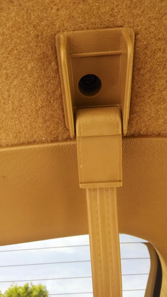

1. Remove the back hatch trim. To do this locate the one bolt located under the pull handle. I think I read somewhere that it is a T27 but I found a flat head screwdriver that fit perfectly since I don't have bits up to that size (If you use the flat head method be careful not to strip the head)
After removing the bolt (it has lock-tight on it so it may require a bit of force to pop it) find the edges of the panel and give it a yank to pop the clips holding it to the interior body panel. Work along the edges until all are free and set this aside.

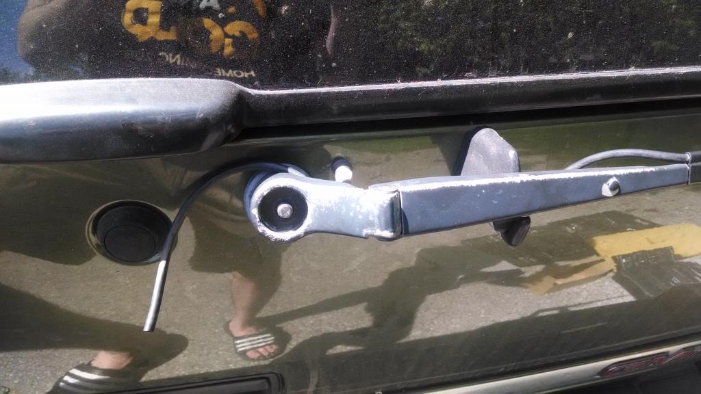

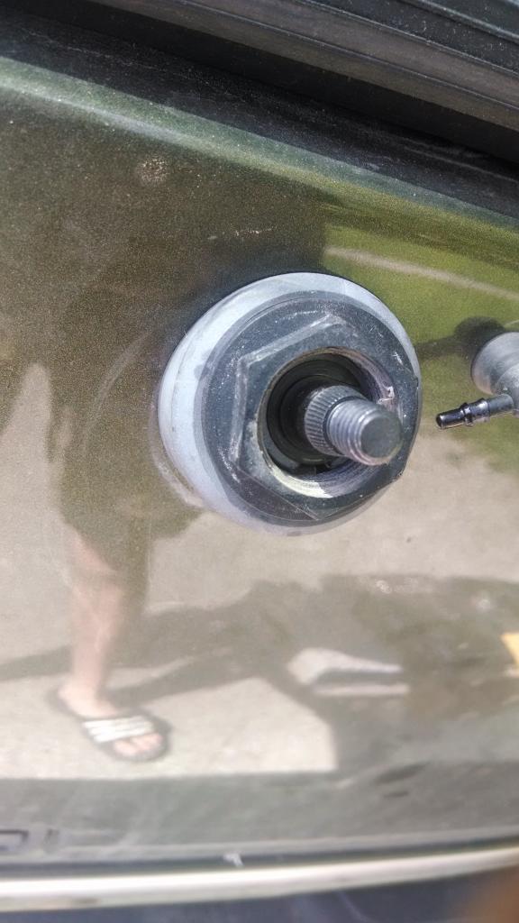

3. Close the hatch and remove the decorative/dust cap that covers the wiper bolt. and carefully disconnect your wash hose
Undo the nut inside using a socket wrench (sizes vary). It may take some effort to pop it as it has lock-tight on it. Set aside the arm and bolt if you plan to reuse them.
4. Next you will need a 1" socket head to undo the plastic threaded fastener that is around the wiper motor head. Be careful not to strip the head as it is plastic.

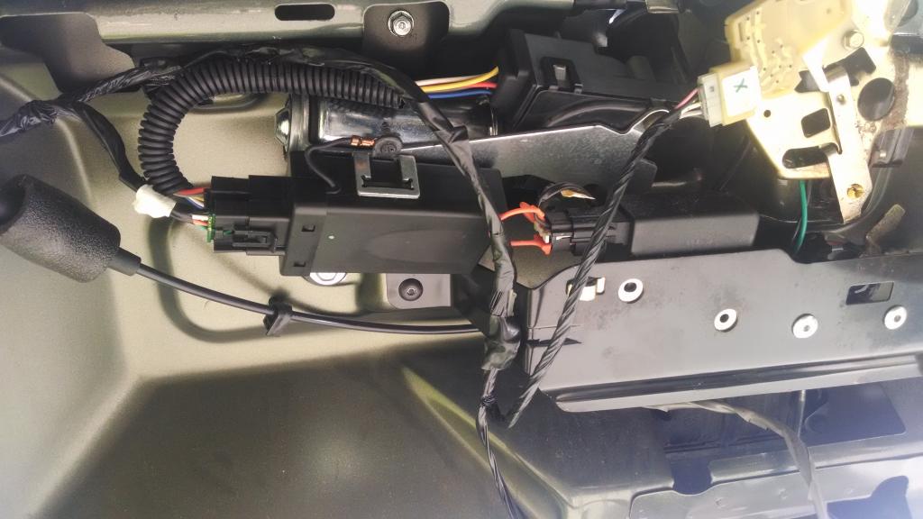

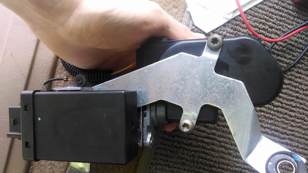

5. Open the hatch and find the two 10mm bolts holding the silver metal bracket to the hatch. This will have the wiper motor and wiper relay attached to it. Use a small socket wrench to get under the black riveted bracket
6. Carefully remove the wiper motor assembly from the hatch. Remember your washer hose is plumed near the wiper so its feed hose is up in the same region you're working. You may also need to detach the back glass hatch actuator to have enough room to slide the motor assembly out past the bracket and wires
7. Assuming your relay is good (as in my case) detach the motor from the bracket with the two screws they are T27's so again I used the flat head screwdriver trick.

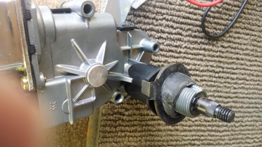

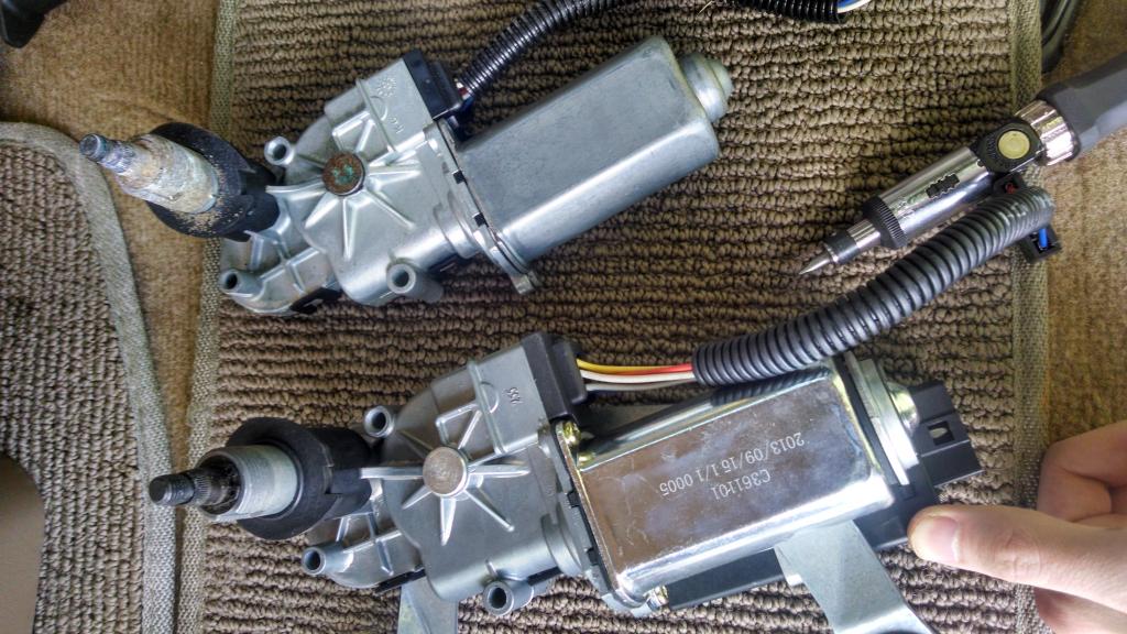

8. On the new motor, remove the protective rubber and plastic from shipping. Take the rubber seat from the old motor (if they are in good shape) from the end of the motor as well as where the wiper arm attaches. Clean them before putting them on the new motor
Here is new and old

1. Attach the new motor into the bracket of the old motor using the same hardware.
