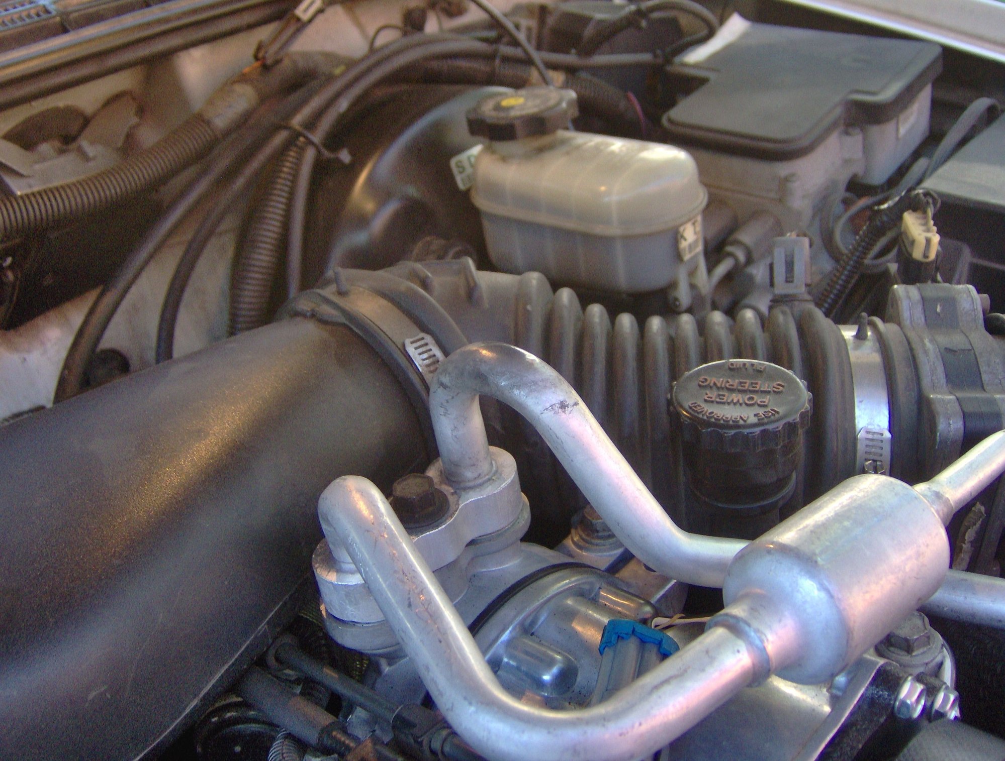

Today I finished installing the GPD (Global Parts Distributors) pn 9612779 A/C Compressor & Component Kit and other parts. The compressor in the kit is a Sanden style kit that many like over the OE HT6 style that is prone to leaking at the middle of the body. Since the core component, the compressor, is not an OEM style part I thought I'd report my experiences with the installation.
In principle the the job is easy but there were a few things that make it more difficult than I anticipated. This job was done on a 1999 Blazer with the Auto Climate Control.
Something not mentioned unless you dig a bit is that the compressor tubes/hoses must also be replaced since the muffler, the can in line with one of the lines, cannot be flushed. Also it is strongly recommended, and likely necessary to have the warranty to be valid, to also replace the condenser.
Of the major tasks, physically it was the condenser that was the biggest pain to do since you have to remove the radiator and disconnect all the hoses and tubes that go to it. This also was the messiest part.
It is also worth noting that most instructions mention pouring out the oil from the old pump to know how much to put into the new one. This advice is only valid for when no other component is being replaced as the balance of the total charge of oil will be in other parts of the system. For a complete rebuild with flushing of the evaporator and evaporator tube (no other parts are flushable) you have to put in the total amount of oil as designated on the label on the side of the pump. For this pump it is 6.4 oz, not the 8.0 oz as the manual designates. It is recommended that when the evaporator is flushed, it is best to pump on it with the vacuum pump for 3 hours. This rids the system of any remaining flush liquid by having it evaporate into the vacuum created by the pump.
Regarding the serpentine belt; you will need to get a new slightly longer one. The one suggested in the instructions that came with the compressor was too long. I determined the appropriate length by the marks on the tensioner pulley. For new belts, the mark on the fixed part should line up with the wide mark, and for a used belt the mark should be between the wide mark and the narrow mark. The new recommended belt was at the outer mark with the used OE recommended belt being just inside the new belt band mark. I split the difference on the lengths and used a 960K6 (96.0 in inside length) belt which when installed had the fixed mark just a bit above the wide new belt mark. I suspect a 955K6 belt could also work. If you don't turn on the engine, your parts store might let you return the belt if it doesn't fit. (http://www.s10forum.com/forum/attach...etch-limit.jpg)
As for what happened to my system that prompted the fix; I thought I had a leak but actually what I had was a compressor disintegrating with small black bits creating a sludge that blocked the orifice tube. Even if you think your system has leaked, I would still recommend you take it to an auto AC shop to have the system emptied.
Below is a bullet-point listing of the parts, tasks, advice, and tools that I used and/or thought anyone else who would do the same job might benefit from seeing.

UPDATE 2018-06-24: I noticed that one of the rigid tubes on the the GPD compressor hose is rubbing a hole in the insulation on the underside of the hood. I'll be contacting GPD to complain.
UPDATE 2018-06-28: I've been in contact with GPD and they are going to send me a new hose set. I also sent a quote to get a pre-emptive reimbursement for having the part swapped out at a local shop so I don't have to do this. I suspect they are willing do to this since they are appreciative of learning how to modify their part. The new part does not have a muffler and has a smaller arch. (With no muffler, the hose could be flushed.) Pictures of the older and now redesigned part are included in a later post.
UPDATE 2019-05-31:
  1. Turned out I did not need to install the new hoses as I was able to gently bend the over-tall arch down to clear the hood with no leaks since then.
  2. I had the low pressure clutch control switch go bad on me. I should have replaced it along with the the other new parts. The replacement switch seems to have fixed the intermittent cold/hot air blowing through the vents problem with the system still working fine.

Quick update: I noticed that one of the rigid tubes on the the GPD compressor hose is rubbing a hole in the insulation on the underside of the hood. I'll be contacting GPD to complain.
(I'm adding this to the original post too.)
BTW, I suspect the stain in the insulation is from a leak in the original compressor.
