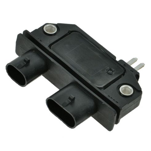

As mentioned in post#5, your engine is a mid production 1995. Some, not all, of the components are the same as 1996 and newer. You might have to tell the auto parts store that you have a 1996 when it comes to primary ignition parts. The [camshaft position] sensor in your distributor should look like this:
The ignition module next to the ignition coil should look like this:

The attached link is what i installed inside my distributor.
