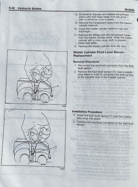

I get a brake warning light when bleeding the front brakes, every time. The scan tool says the differential pressure/fluid level switch is reading low, of course, there is plenty of fluid in the MC.
If this switch is bad, can it be letting air into the system? I'm not even sure where this sensor is on the Bravada, I'm guessing it is the electrical connector in the proportioning valve?
