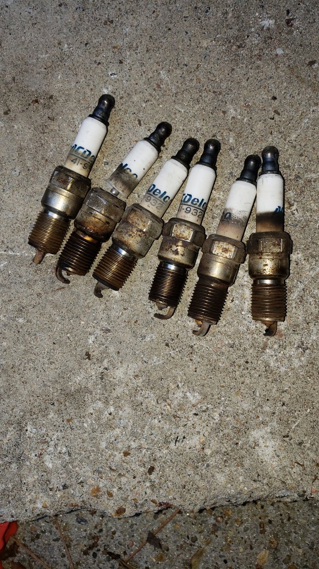

I took the EGR Valve off and cleaned it up as well. Here's my pull from today's work. Tell me which one you think was #3.

Access to #3 plug is a bit of a challenge....plug likely broke upon removal....unless you were having a lot of misfires. Even with the steering shaft disconnected, there is still not a straight shot to that plug....and the ceramic does get brittle over time/temp.

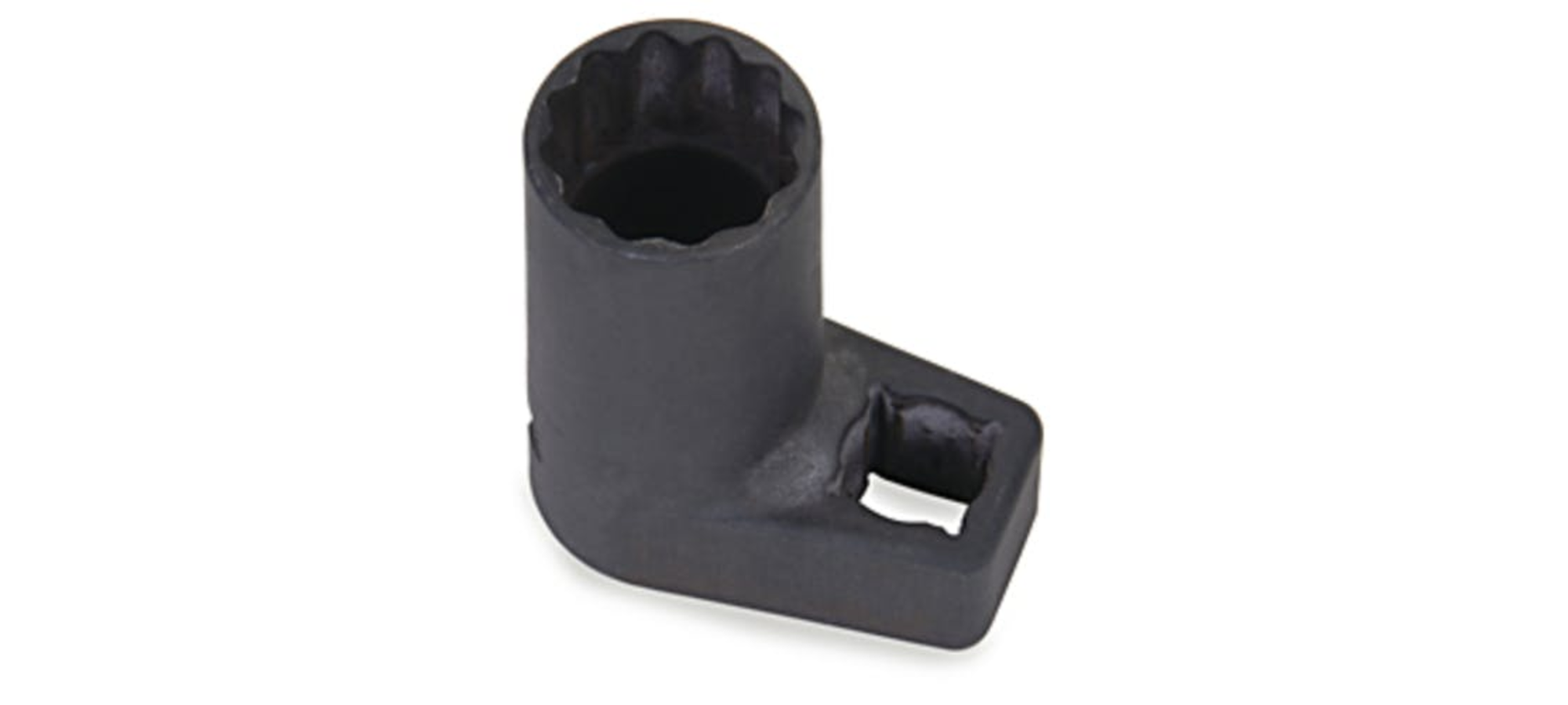

I use this Snapon tool (S9723) for the #3 spark plug. Its expensive so I waited until I found one used on eBay. Doesn't matter much if they break coming out but you don't want the same thing going in. You still need a U joint socket and being a Yoga instructor would be helpful. Some guys report that moving the shaft is not too bad but I have never tried it.
George
