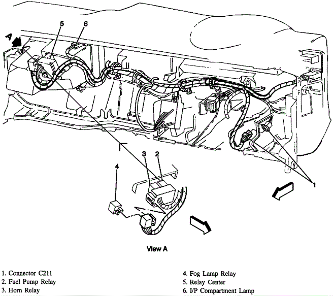

OK update: found that fuel pump is not priming with every key turn. Can someone tell me where the fuel pump relay is for 96 blazer 4.3?
Old Nov 7, 2010 | 02:09 PM
Posts: 41,341
Here's a view showing the relay center behind the glovebox:

OK so after taking the time to follow ALL of the diagnostic instructions (rather than jumping around), looks like my fuel pump AGAIN. Got the tank dropped today and guess what I found?? Any guesses?? You got it there is an Airtex Pump in there. I think I may have read here once or twice or more, that these $uck. Why am I going on... Maybe someone else can avoid this costly mistake. You may save $100 or so now, but when you are replacing it again and you will!!! You have been warned!!
