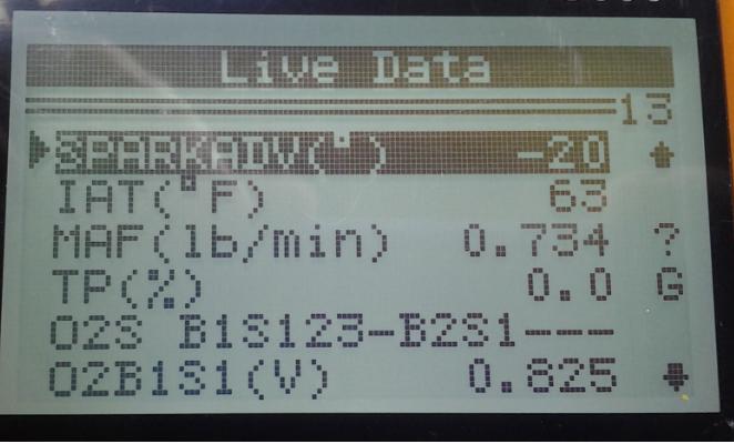

live scan update: the was taken at idle (550-600rpms) 194*F:
Attached Thumbnails starting problems-ramairblazer-71213-albums-96-blazer-6794-picture-live-data-2-25621t.jpg

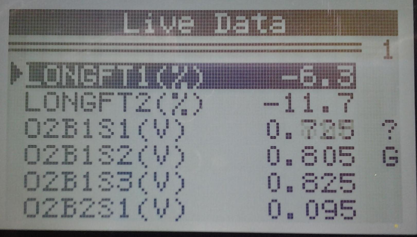

Default fuel trims
@ idle and warm 194*F
are there any other live data sensors that would help?
