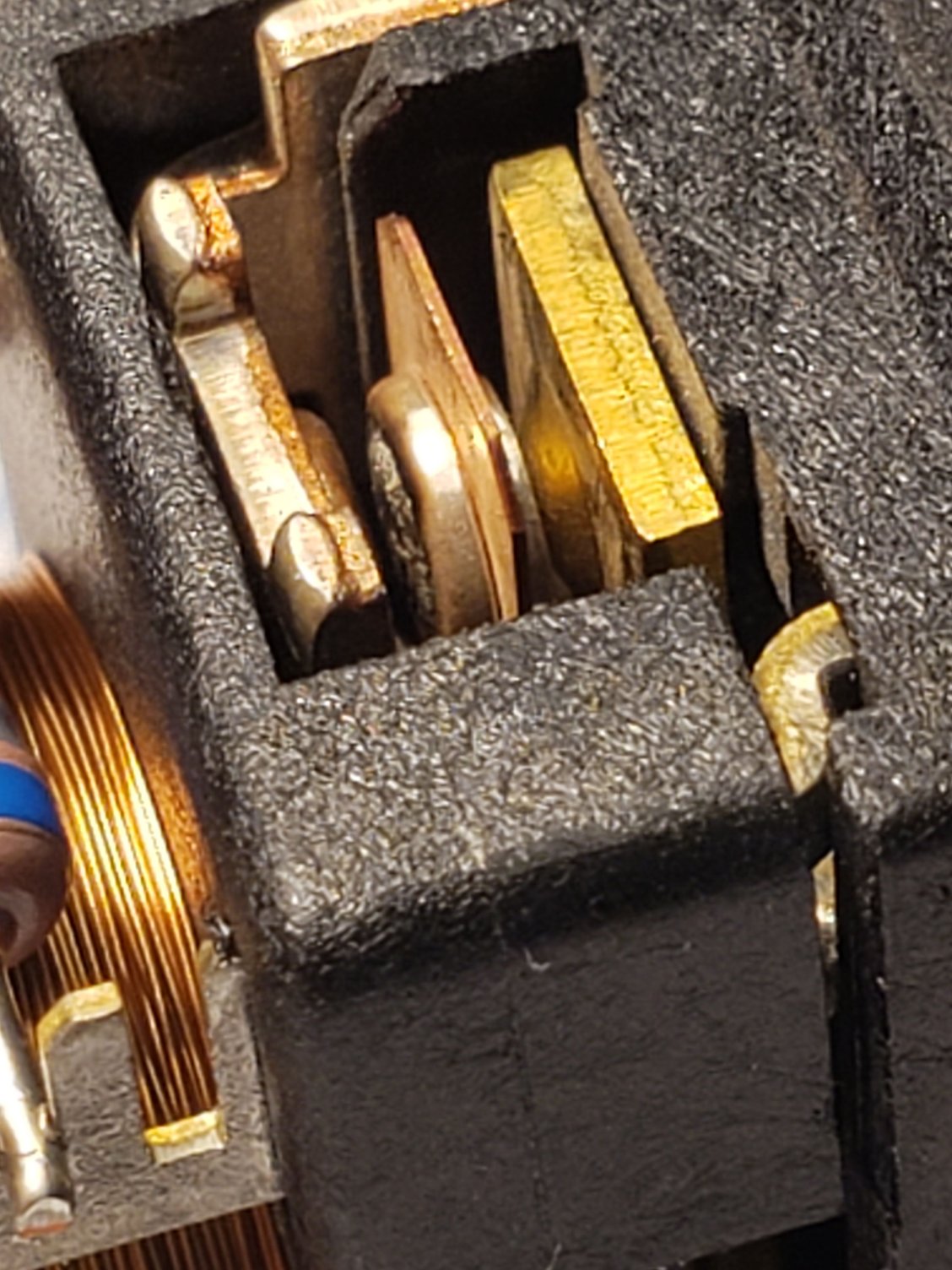

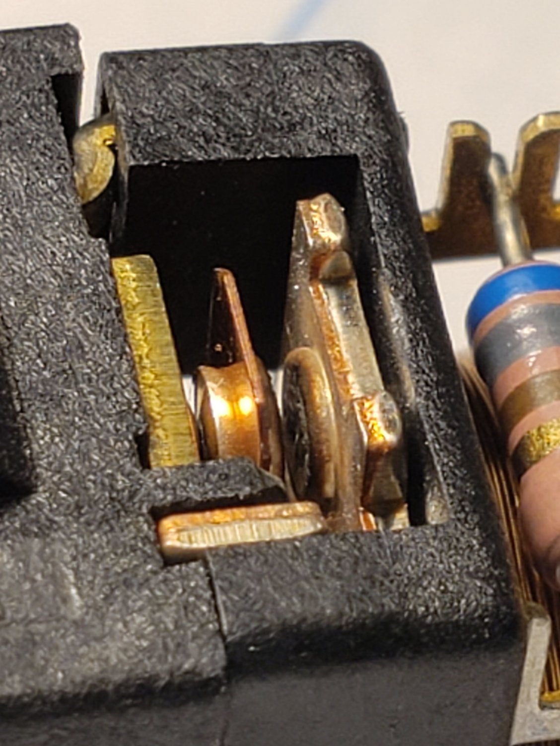

Old Aug 2, 2023 | 12:50 PM
Posts: 5,627
Default Worn Relay Contacts
Here's another quick update:
I removed what had been the fuel pump relay to open it up and inspect it. What I found was very worn contacts. (see below)
I then did some research to learn how relays fail and their expected lifetime. What I learned is that voltage drops across poor electrical contacts and reduce the voltage at the fuel pump to a point where it will not run. I also learned that the contacts on relays are expected to have a life of about 100,000 cycles. Furthermore I learned that for lamps and motors, the wear and tear on relay contacts can mean having to de-rate the relay by about a factor of five due to the large initial current spikes in these.
A quick back-of-the envelope calculation assuming that for each time the truck is started the fuel pump relay is triggered once to prime the fuel system and then a second time once the motor is started, then assuming one round trip 200 times a year over 24 years, I get a total of (4 cycles/round-trip)*(200 round-trips/year)*(24 years) = 19,200 cycles. This is about a factor of 5 less than the normal life-expectancy.
Now this calculation is pretty crude, but considering the wide error bars involved, it shows to me that it is not unreasonable that a fuel pump relay could be expected to start failing at about 20-25 years.
I have replacement relays for the more critical systems to install. I'm sure GM never expected most of their Blazers to last over 15 years.
https://www.ms-motorservice.com/en/t...check-contact/
Old Aug 2, 2023 | 06:19 PM
rockp2's Avatar
Joined: Nov 2011
Posts: 1,139
From: Pennsylvania
Once the contacts on relays start "arcing" it becomes progressively worse.
I was helping someone with a fuel injector problem and it was very apparent that they had an issue with either corrosion on the connectors under the UBEC or in the wires themselves due to the symptoms. Sure enough the terminals were corroded. He cleaned them up and all is well. A "no-parts required" fix. His issue was constant so it was a pretty easy diagnosis.
Made me think about the intermittent issue you're dealing with. You might consider unbolting the UBEC and disconnecting the connectors to see how they look. The fuel pump relay involve pins in connectors C1, C2 & C3. Or you could wait until next time it happens so you can know for certain if the fuel pump is coming on or not before you go thru that. Wouldn't want you to risk breaking any brittle connectors, etc if the pump isn't even the issue.
Old Aug 2, 2023 | 06:24 PM
Posts: 5,627
Thanks for the ideas. Just to be sure we are on the same page, is the UBEC the under-hood engine compartment fuse block?
BTW, when I pulled the relays the female connectors looked good.
