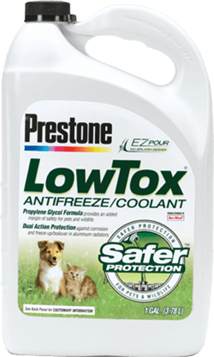

I'm running LowTox (propylene glycol) coolant in mine. It's better for animals and the environment if it leaks on the ground, and it won't immediately destroy engine bearings if it leaks into the crankcase.
