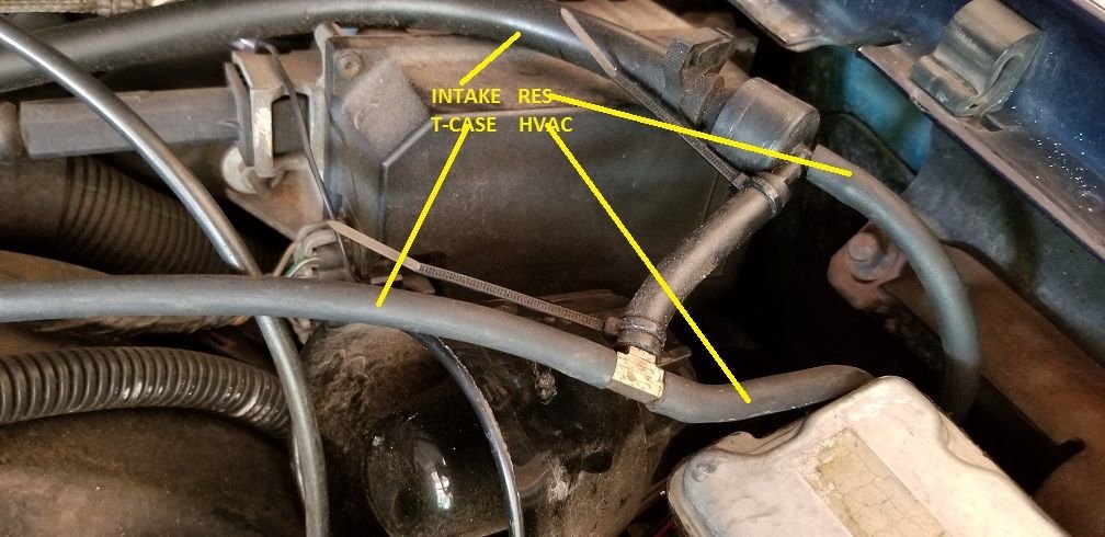

Old Aug 6, 2019 | 09:13 AM
man0steel's Avatar
Joined: Oct 2017
Posts: 176
From: Tornado Alley
man0steel is on a distinguished road
Is this correct???
Old Aug 6, 2019 | 11:26 AM
Posts: 5,624
Originally Posted by man0steel
Is this correct???
Looks right to me. The vacuum reservoir should be directly connected to the rest of the vacuum "circuit" at all times with the vacuum supply from the intake manifold being isolated from the rest of the circuit when the vacuum there is less (i.e. closer to atmosphere).
Have you checked the check valve? Could it have been a bad one?
You said you replaced all the hoses in the vacuum system too. Right? Assuming you did, I'd suggest putting on more of the zip-ties on all the nipples only because it is so easy to do. I even was able to install one on hose that goes to the nipple on the reservoir. It took a bit of effort and a mirror to make sure it was on but I was able to do it. One of the reasons I installed the zip-tie "clamps" was peace of mind but also because I suspected that the original hoses might have been specified in metric not inches with the potential of some looseness at the fittings as a result.
If putting on more zip-ties doesn't help, then you should check the check-valve. (Or check the valve first as it is not that hard to access.)
Your symptoms are definitely of a vacuum leak but I'm running out of suggestions. (I only feel somewhat qualified because I was in your same situation a couple years ago.)
If the symptoms are still there, then I could only guess there is a leak that is only present when the system has been able to get sucked down first. I'm wondering if there is something in the vacuum circuit that leaks a bit, but not too much to stop operation when there is a lot of vacuum present at the intake, but when it has leaked down and everything is in is "no-vacuum" default position, the leak is isolated so that when you pull a vacuum with your pump when the engine is off you would not be able to detect it. I'm feeling I'm grasping at straws now! LOL
