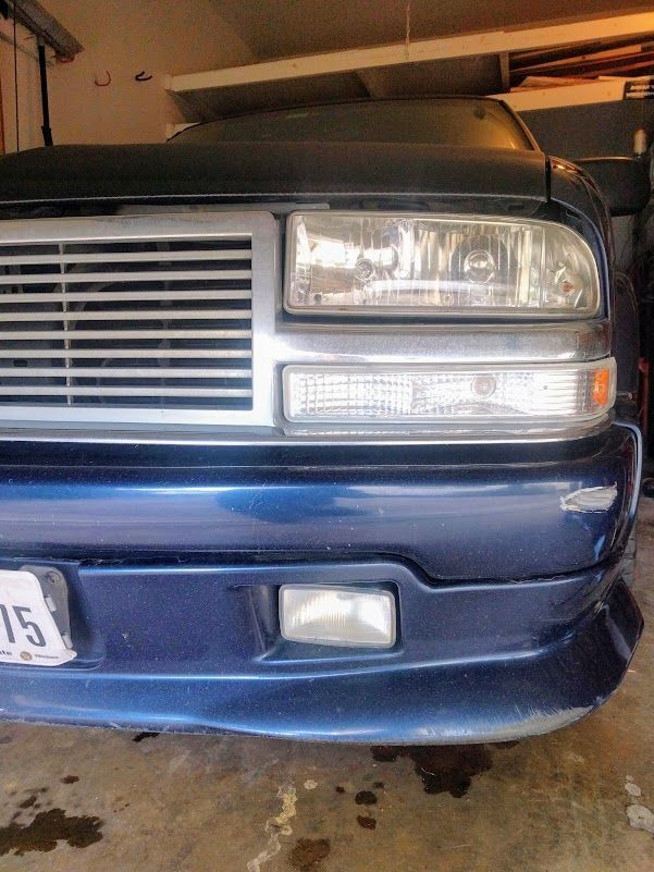

Anyone modded their fog lamps? Seems like I saw some once but can't find them now. Looking for ideas, thx.

What exactly are you looking to accomplish, just neat looking or actual better light output?
Throwing some cheap LED bulbs in them or tinting the lens is a quick and easy way to change their appearance, but it's not going to do much for the light output, probably even make it worse.
I wouldn't chance putting HID's directly into them as I doubt the housings would hold up to the heat for very long...
If you're comfortable doing some heavy modding, you could cut them open and stick some projectors in them and some HID's into those for a cool look (in my opinion) and WAY better light output. There's some pretty small projectors that you could cram into the housing like the Blazer brand (yes that's actually the company name ironically lol). I have a set of Blazer brand lights that I robbed from a Corvette, they're factory OEM lights on it, that I mounted to the front of my Blazer. They're sealed and waterproof so they don't have to be fully enclosed in a housing. I'm running 55w HID's in them with great results, they're as bright as most low beam headlights by themselves and have a nice cutt off so they don't blind oncoming traffic.

I'd be fixing them up just for looks. What about outlining the lamps with neon, maybe there's something skinny that will fit? Or cover them with a pattern of transparent colored tape?
