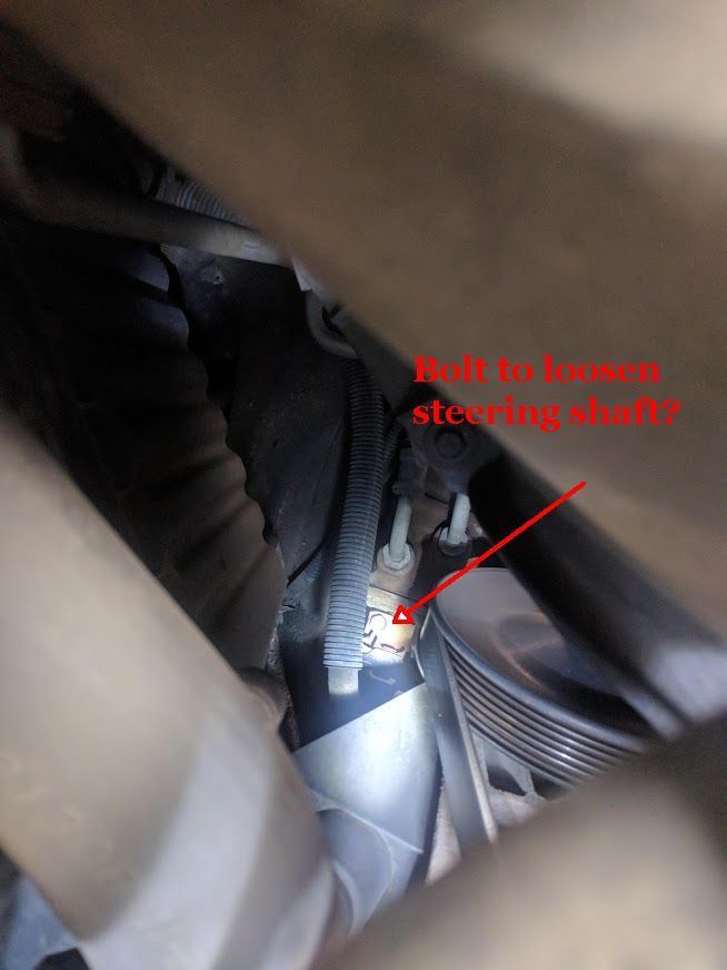

It is this one bolt?
Old Nov 4, 2018 | 05:54 PM
G0LFADD1CT's Avatar
Joined: Oct 2008
Posts: 325
From: Pasco,WA
G0LFADD1CT is an unknown quantity at this point
Yuuup

If I remember correctly the steering shaft has a flat spot for the bolt to slide past it....there is no moving it over a few teeth unless the securing bolt is left out.
