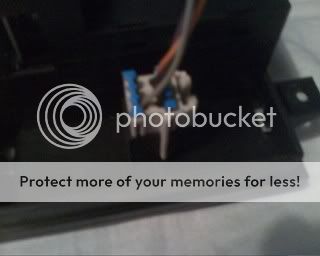

Do the fog light wires go?
Okay, so I bought a new headlight switch control panel, but one that has the factory fog light at the bottom. I also took with me the harness for the fog light, assuming my Blazer without factory fogs would not have it.
Here is the harness I speak of:
I was surprised to find that my Blazer has the harness, despite not having factory fogs. It was just plugged into a blank spot.
Now my question is, does anyone know where they put the other end of the fog light wires on Blazers that never came with them.
It would be awesome to find the other end of these, rather than having to run my own wires through the firewall, ect.
Any help is greatly appreciated. I'm not holding my breathe that someone does know where these end.

since my '98 came with them from the factory, i can only guess it'd be in the wiring harness out front. try digging around under the rad support, since this is where they're closest to.
and you do realize that your BCM is gonna need to be "straightened out" before the factory HL switch w/fog light switch will work, right?
*by "straightened out", i mean you're gonna need the dealer to "flash" it (or whatever it is they do) for it to aknowledge the fog light system.

I definitely did not know that!
I have it in right now and the HL and interior light switches work. I figured that when I had a complete circuit the fog would work.
