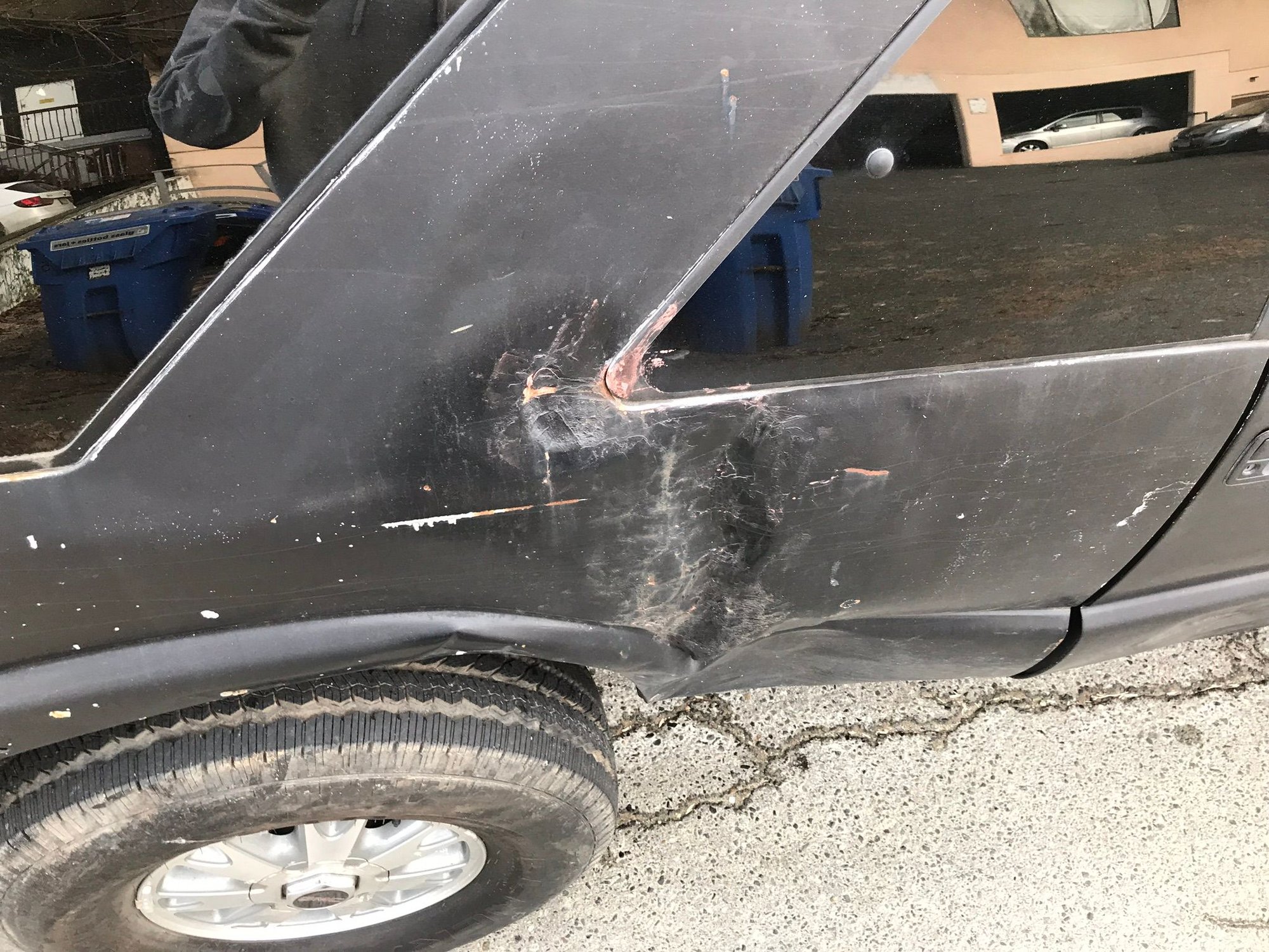

anyway, the thing runs pretty good, idles good, shifts good, has some side damage (tent trailer spun into it) so ill be posting a lot trying to fix that. anyway.
thanks. ill upload pics when i pick it up/
