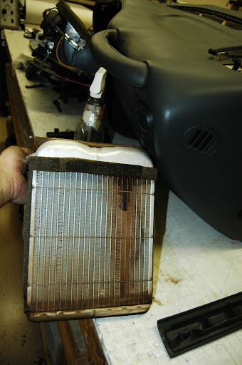

I just went through and replaced the heater core in my 2000 Blazer ZR2 following the instructions AdamCrosier posted in post 19 of this thread. Total time was about 8.5 hours, but honestly it wasn't that bad of a job, just tedious. It took me longer last weekend to deal with rusted and frozen nuts and O2 sensors, and a snapped muffler flange stud, when I swapped my catalytic converter than it did to do the heater core!
In the course of doing the heater core, there were a couple things I noticed or did differently than what's mentioned on here.
1. There are three connectors on the Body Control Module (box at the front of the console, step 24 in AdamCrosier's instructions), a blue, a brown, and a purple. In the 26-page Mitchell instructions that robertr728 posted above, it mentions removing the brown connector, then the purple connector from the BCM. It makes no mention of the blue in the ordering. I don't know why the order of removal would matter if the battery is already disconnected (which it better be!), but food for thought. I did the brown, then purple, then blue.
2. When removing the BCM connectors, check to see if they are taped to the dash. I had one set of them taped to a support right by the BCM, which hung up removal of the dash.
3. To get the dash out over the steering wheel, I removed the instrument cluster. It made for a lot more wiggle room to get the dash contorted out of the truck. Four 7mm screws and one connector.
4. Don't forget to disconnect the "six-pack" of vacuum connectors coming from the HVAC controls to the air blend/heater unit before taking the dash out. They are by the large power connector and airbag connector in step 15.
5. Also in step 15, make sure to get the yellow airbag connector immediately to the left of the main power connector. I got a bit ahead of myself and disconnected the one to the left of the glovebox, only to re-connect it and undo the proper one next to the large connector. My bad...
6. Make sure to route the antenna cable from the stereo out of the radio cavity. Mine was clipped onto the dash and kind of wrapped around in the radio cavity, and hung up the dash when we tried to remove it.
7. Near steps 8 and 9 in these directions, there is a four pin flat connector with thick (12-ish gauge) wires that runs to the fuse box from a place unknown. That also hung me up on dash removal. Look for it near the parking brake release handle cavity after you take that panel off. I don't know exactly where it belongs, but I know it's there.
8. For the "worst bolt" in step 29, I cheated a LOT here. The way I figure it, if I already have to break out the sealant to close up the area around the resistor pack on top, why not make another hole to patch?
8a. I (carefully) drilled a 1/2" hole at about the same level as the the bolthead, and another 1-1.5" or so towards the engine, further away from the AC evaporator. When drilling, do NOT drill anywhere except towards the firewall/back of the truck! If you aim the drill toward the passenger side, you may very well end up drilling your AC evaporator and causing a damn expensive mess, and killing your air conditioning. BE CAREFUL!
8b. I used a 12" long, 3/8" drive extension and a 10mm socket. I put the extension through the hole, then angled it up and attached the 10mm socket to it.
8c. When I felt the bolt getting loose, I used a magnet on an extendable handle and grabbed it with the magnet before it came fully loose. Once it was all the way backed out, I pulled the extension and socket back a bit, let the magnet hold the bolt, and pulled the bolt out with the magnet.
8d. When reinstalling that bolt, I put the magnet on the socket to magnetize it, and then put the bolt into the end of the socket. I had to use my fingers to guide the bolt into the hole, but it was pretty smooth sailing.
8e. To patch the hole, I'm going to use some weatherstrip glue or rubber/contact cement and a piece of thin black rubber to patch over the hole. I was going to use some thin sheet styrene I have at work, but I've decided I want something more flexible/pliable to deal with the temp shifts and differential between the hot engine bay and (potentially) cold evaporator housing. So, an update is forthcoming on this, but I don't anticipate a problem.
What to expect your truck to look like:
Pile o' parts removed:
The HVAC unit with the heater core removed:
The culprit:
Hope this helps someone who's going to tackle this job. And, thanks to everyone on here for all the helpful information, and especially AdamCrosier, whose step-by-step directions were irreplaceable for me on this!
