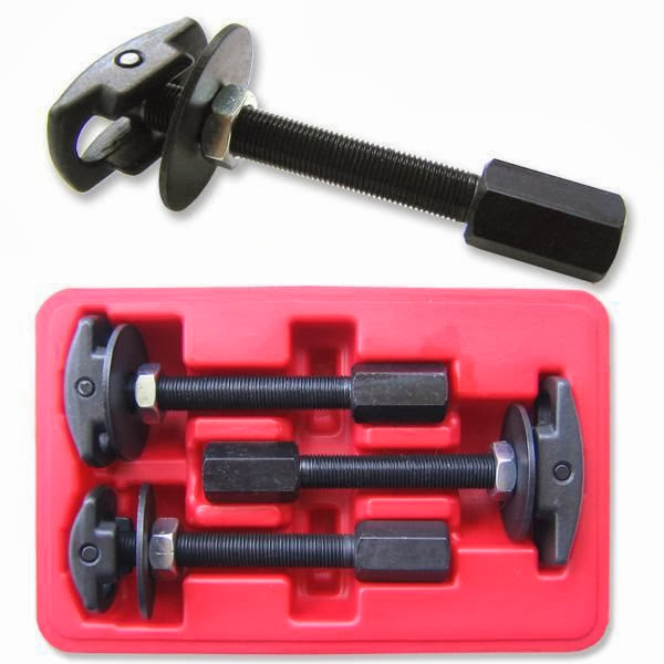

To remove the old seals i used a Lisle seal puller
I used this to remove the bearings but i would recommend a true bearing remover
Bearing remover
