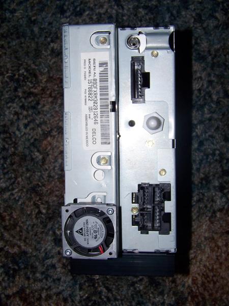

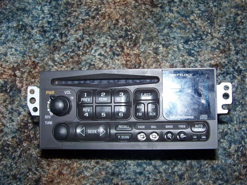

Here is how my 01 looks. Hope this helps. It's also for sale
Attached Thumbnails 98+ stock CD player work in a 96 Blazer?-picture-001-medium-.jpg   98+ stock CD player work in a 96 Blazer?-picture-002-medium-.jpg

Wow that is out of a 01 i got one out of a 98 and the plug and the stereo look different
