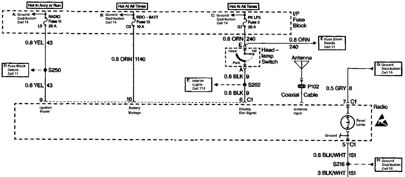

Posts: 41,341
Right in the first post GB!
Originally Posted by blazinup101
I have a 96 blazer
To the OP, have you tested for +12V on the orange wire? Sounds like you have, but I just want to make sure. Also check the ground for good continuity.
Here is a schematic showing the power side of the radio:

Posts: 41,341
Based on the wiring schematic I posted above which is for your truck, there is no inline fuse.

blazinup101
He's right. I guess on the Gen 2 Blazers they did away with the in-line. I was quoting from a 94 W/D (last of the Gen 1). Comparing my W/D to this one there are a few differences in the power circuit. Not big ones but enough to screw you up. Didn't mean to steer you wrong.
