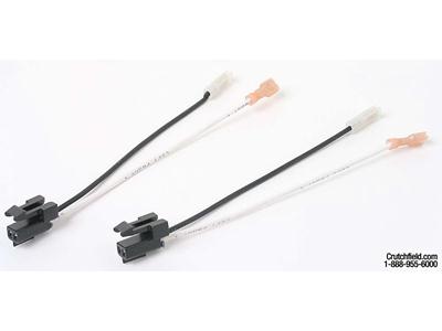

These are what you need for the front speakers, where you get them from is up to you, but the connector end is the main thing.

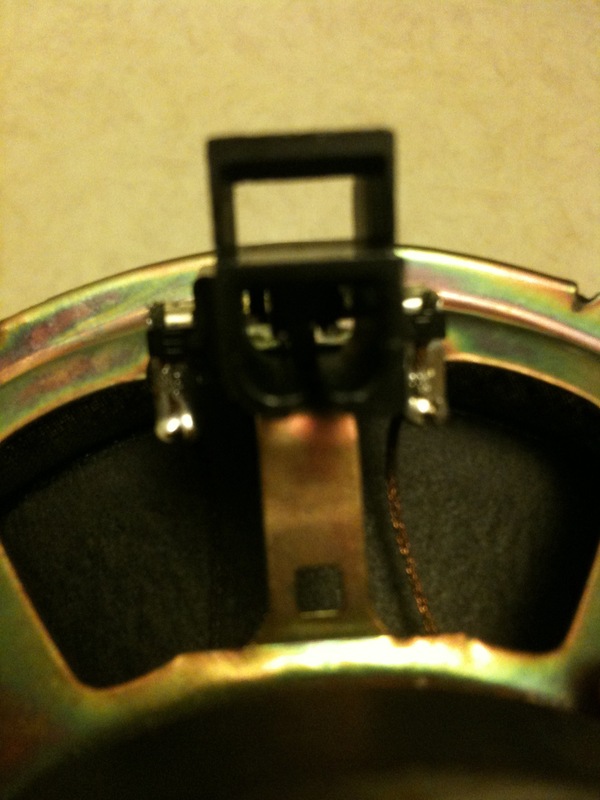

The back of the factory front speakers have a non-typical connector instead of a positive (+) and negative (-) terminal to connect lugs to.
(see pics below)
side view of same connector...
sorry for the low quality picks but the harness you would buy for the front speakers would replace this connector on your new speakers. Otherwise, you would have to reach in behind the door, clip off the factory connector and crimp on spade connectors. On mine, I had very little extra wire to work with if I would have gone that route. With the harness for the front, you connect the spade connectors to your new speakers (they are designed to only do on one way, no worries about which is positive and which is negative) and connect the two connectors together. Takes all of two minutes this way. No cussing, no worries about polarity and nice clean install.

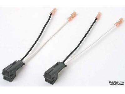

This is what the connectors for the rear speakers look like.

If you opt to reuse the connector on the rear speakers, make sure you pay close attention to which is positive (+) and which is negative (-), color coding is not typical. If you aren't comfortable with that then consider purchasing the rear harness.
