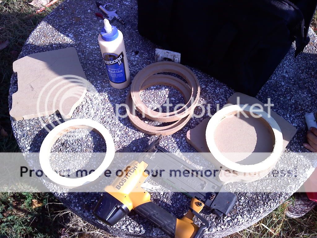

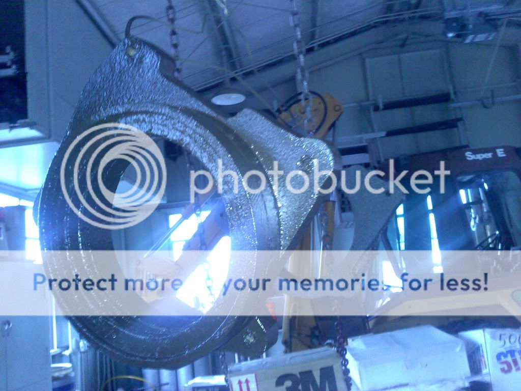

Absolutely, although I think I need to explain in a little more detail the difference between the door panel and the door card, as far as my definitions are concerned. The door panel I was referring to was the sheet metal of the door itself. Where the factory speaker mounts, the window motor/crank mechanism mounts, the actual door. The door card is the plastic panel that covers all that stuff up and makes it look good, as you had shown in your picture example.
On the door panel there are holes in the sheet metal that allow access to the window tracks, window itself, door operating mechanisms, etc. Those are the holes I'm referring to when I talk about covering them with a piece of sheet metal. Then cover all of that with the poor man's sound deadener (Peal 'n Seal) being sure to cut holes for where the plastic tabs and screws go to mount the door card and things like that.
Something like this:
(Don't use screws though!!)
and
The door card, like you had pictured, is what I was talking about with the carpet padding. Cut the padding into small pieces that take up the deepest parts of the recesses in that door card. Then add another layer cut a little larger to fill the entire space above the first piece you put in. Keep doing that until you have as much covered as possible without it sticking out above the highest points of the door card. The highest points are the points where the card touches the panel, so obviously the padding cannot be thicker than that, or covering those points or it won't go back on.
Something like this when it's complete.
RAAMAUDIO should still have a tutorial on covering the holes in the door panel, and treating the door panel with their products. It should give you a good idea on how to proceed with your project.
Originally Posted by BlazerJenkins
Also do you know the actual speaker size? I've seen mixed sizes. Some places say 6 1/2, some 6 3/4, and I think I've seen people say 6x9 as well.
The reason you see the sizes mixed like that is because both will fit. The factory speaker isn't technically either size by the standard. Most 6.5" speakers fit without too much trouble at all. For the most part 6.75" will fit but they can be challenging to find good ground for the screws to screw into the factory plastic. I generalize it like this because the frames that manufacturers use in the speakers vary greatly. There's no uniform and exact measurement they have to go by.
Which brings me to another point I missed on the installation. The factory plastic mount is a flimsy piece of crap, they all are in every vehicle. The best solution is to make one. The more solid the mounting baffle the stronger the bass output and the cleaner the midrange is. I made mine as pictured. I cut out the base of it by tracing the base of the factory plastic one. I could then have used fewer rings to stay behind the door card, but I cut out the factory speaker grill and built mine to protrude slightly past the door card.
Hope this helps explain everything.

I used a jigsaw to cut out the base and a router to cut out the rings. A jigsaw could be used to cut rings too though, that's no biggie, but a circle jig on a router is a must for anyone who's doing a lot of stereo work.

Mine were just made from MDF, which is a popular material for building subwoofer enclosures. Plywood would definitely work fine as well just be sure to cover it with something (paint, rubberized undercoating, bedliner, fiberglass resin, etc.) to protect it from the elements. I used three layers of 3/4" thick MDF (the base and two rings). You can buy 2ft x 4ft and 2ft x 2ft pieces of plywood at Lowes and Home Depot so if a person wanted they could mix thicknesses to get them right up next to the door card without rubbing.
