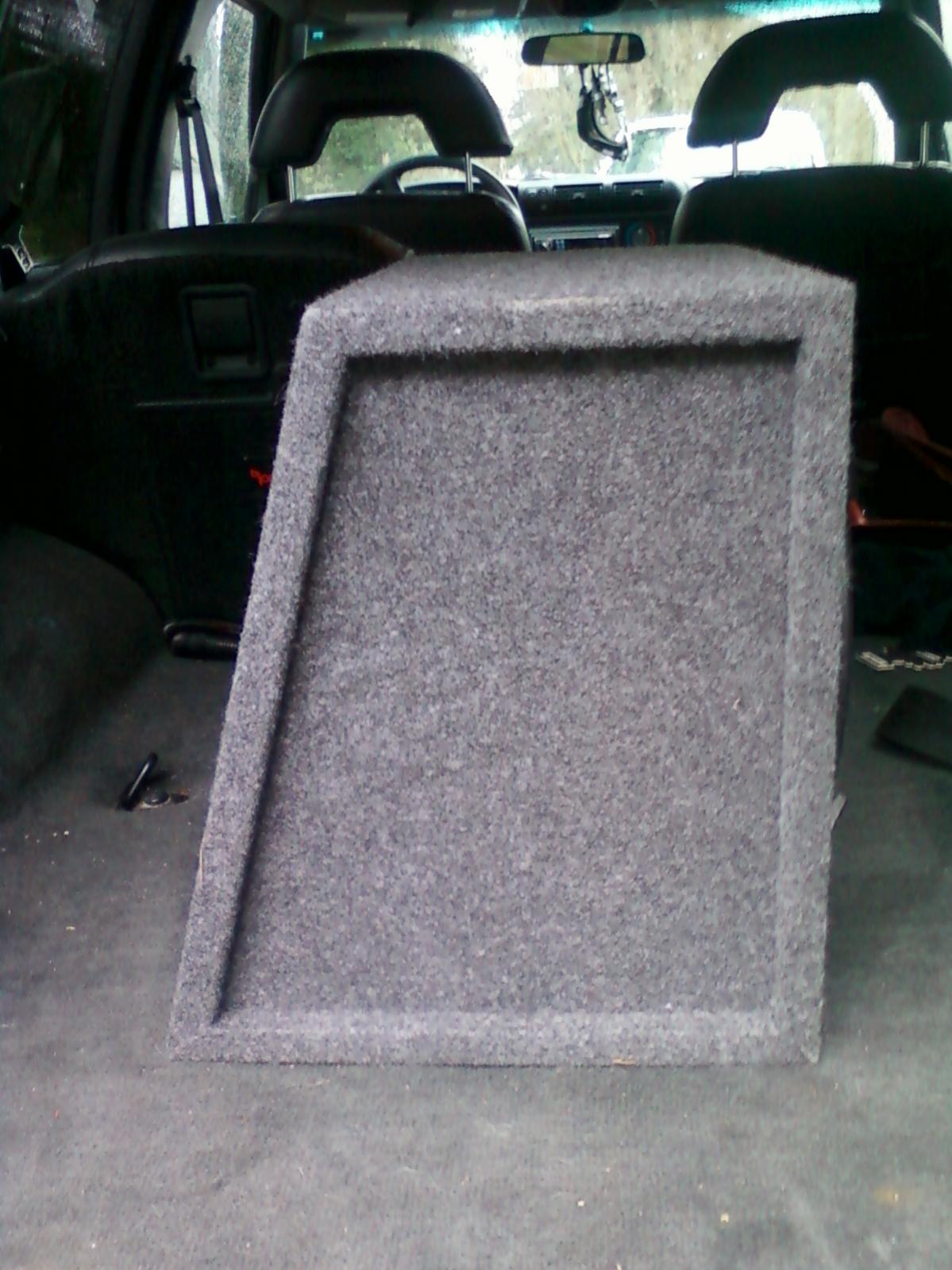

changing the box does make sense. i dont know what kind of kicker i have because i bought it from a friend i just know its older. but i will post a picture of it here. also i had car toys did all the install and they told me i didnt really have a choice as to were my amps went. so they put them on the back of my seat and i have never seen that done befor. i appreciate the replies

that is most definitely a prefab enclosure. Take the sub out and look for the model number.
