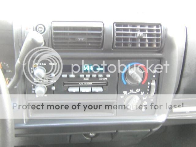

Hello,
I would like to know if anybody knows if it would be possible to install a Pioneer Avic D3 in a 1996 blazer LS.
Thanks
Also, can you give me a good website with parts, and interior accessories for a 96 blazer LS.

Sure you could do it, but you are gng to have to make your own brackets, probably could get the metra 02-4544, that has most of the GM brackets in it. you will lose the pocket, and have to fab up something to fill in the rest of the space. I am doing a double din in mine with fiberglass. I bought the actual dash kit for my truck,(an extra one) that i could cut up and then glass over top of to make it look nice. Probably could be done with some creative use of brackets and a sheet of black abs plastic as well.

I could careless about the pocket. I just want it to look nice!

I am sure I could modify the dash to make it fit nicely.. But the only problem is... when the car is in drive the shifter is in the way of the radio.. it will be a pain to hit the buttons.
