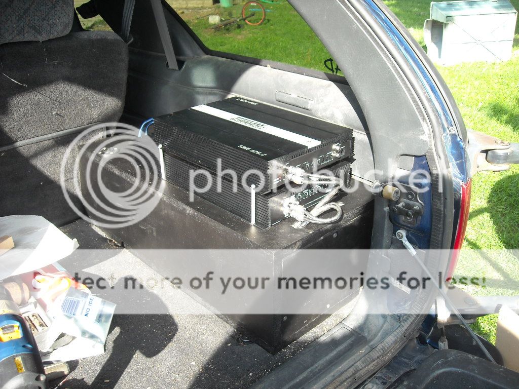

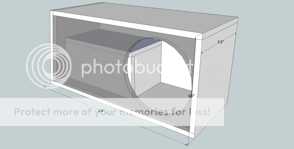

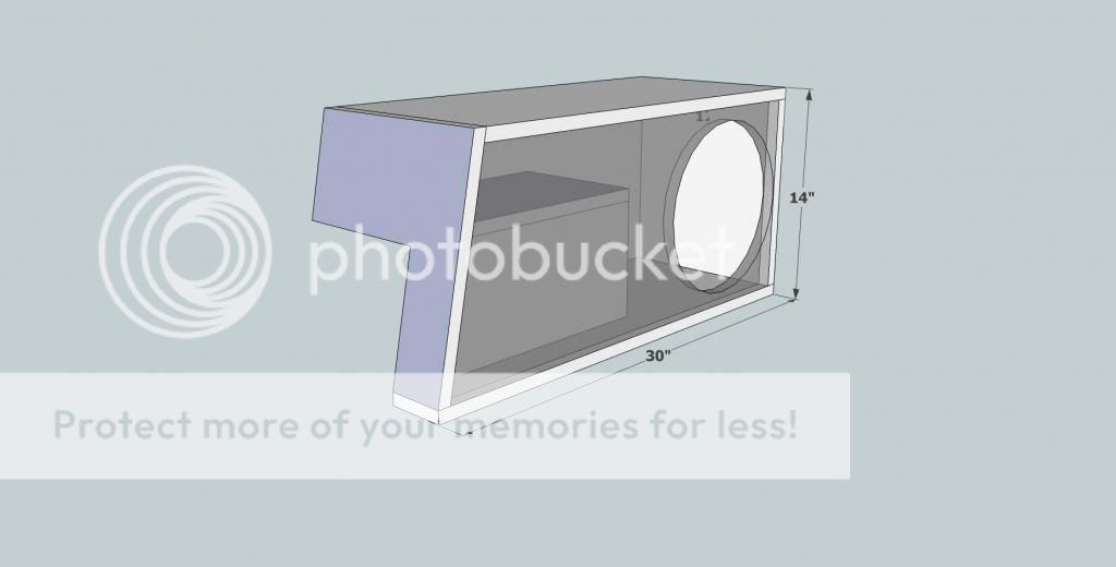

Well, I went by the design on my amp rack and believe it or not It's possible to fit a sealed enclosure for a single 12 in that corner. I've got to take a few more measurements in the rear to see how everything would actually fit up, but it looks pretty promising. The enclosure would net right at 1cuft of space and would be perfect for most subs sealed.
Here's a pic of my amp rack for reference on the fit in the location.
Here's a couple of pics of the design on the enclosure.
So if you didn't mind it being above the window line then it's doable without fiberglass. I think even if you were using figerglass it would still be above the window line, there's just no way around that.

Well I was finally able to get to measuring things out for more certainty and 14" height is below the window line! The corner of the enclosure that would be in the corner of the truck will need to be rounded all the way around and the fit would be extremely tight but it would fit.
I can draw up and give you plans for it if you're interested.
