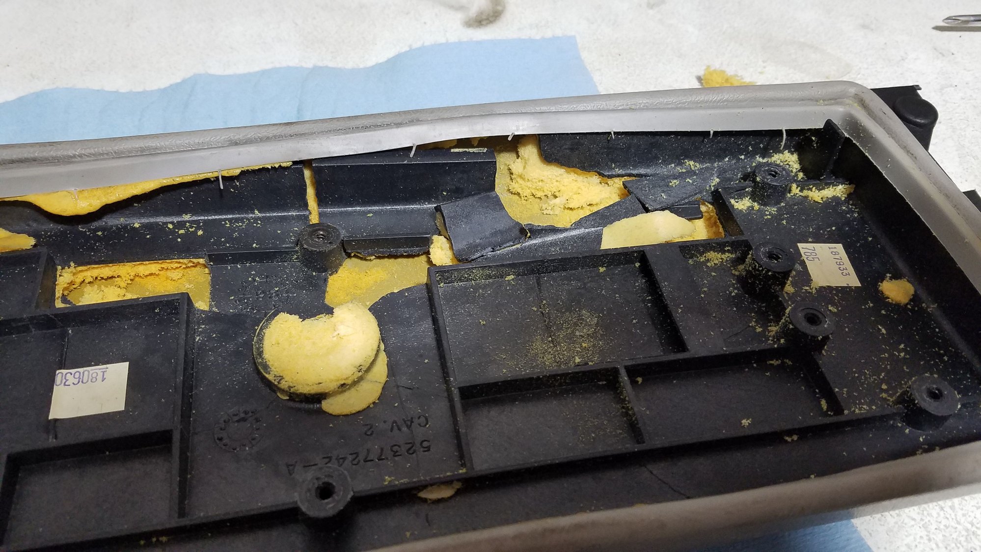

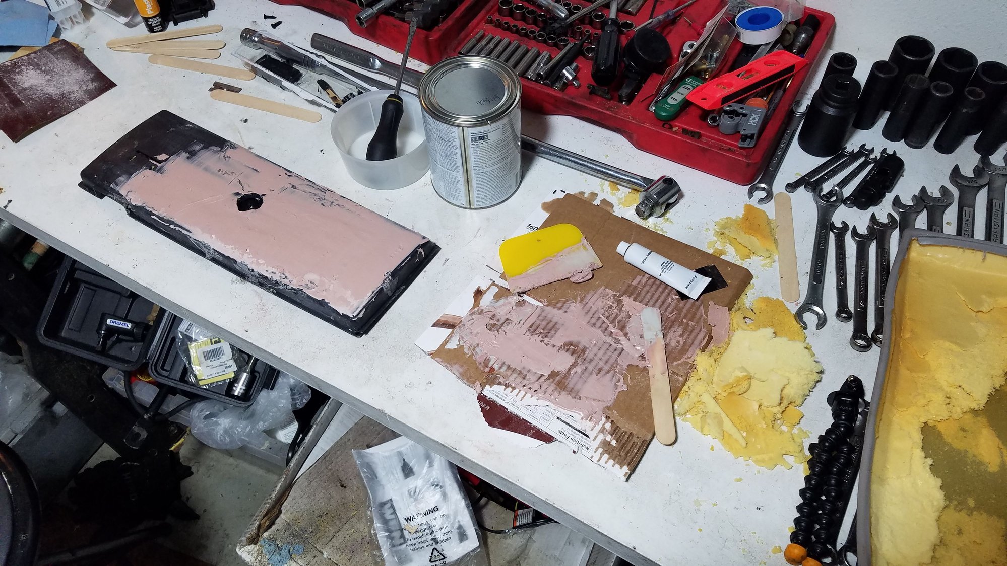

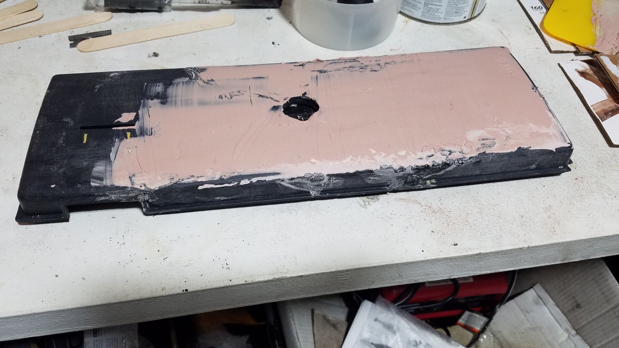

Good Tip lol. I've currently got the console lid torn apart, and almost have the base back together to where I'm happy with it. . . . it was in about 8-10 pieces when I started. Going to skim the top with bondo to make it smooth and give it a little extra support. Right now I'm looking at trying to reuse the OE rubber/vinyl top but the foam is pretty destroyed.

Almost done with the console lid. Just need to get some new foam, and contact adhesive to glue it back together.
I did sand the top down a bit but didn't take a picture. It seems pretty sturdy now. . .I was going to get more epoxy and fill in some of the voids on the bottom of it, but I don't think that's going to be necessary.

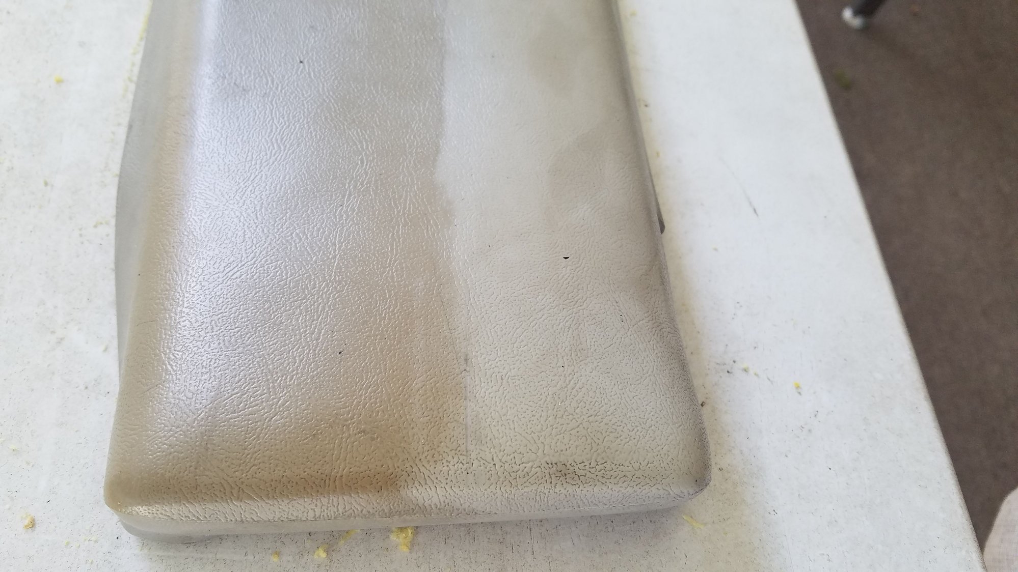

Here is a picture of the cover after I hit half of it with the Peroxide cream and let sit in the sun for a while.
I've done the whole cover now and it looks much better. . .definitely got rid of the yellow/brown discoloration that I couldn't clean off. It's a little splotchy in places where the saran wrap bubbled up, so I'll do one more quick pass on it.
I put it all back together to test fit, and put it back in the car. . . it's much nicer feeling now, even without the foam. . you can lean on the console and it's not total mush.

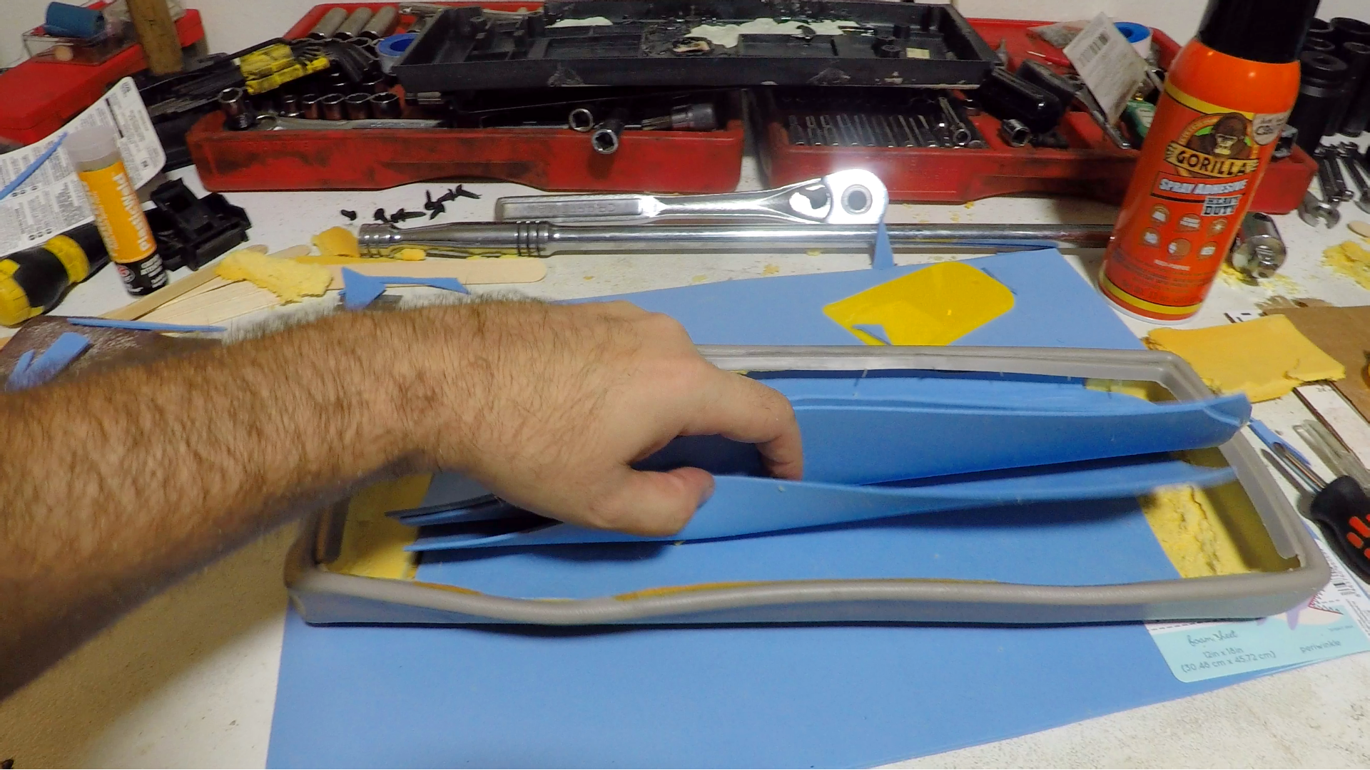

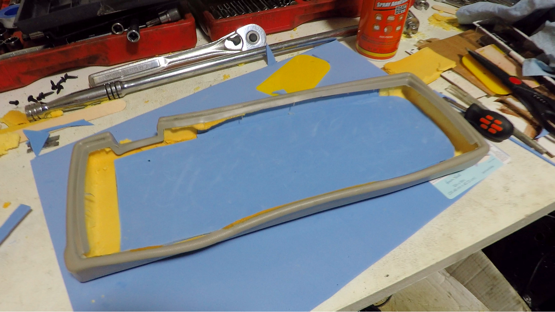

Pretty much done with my console lid now. I still need to go buy a hinge and figure out how to securely attach it to the plastic, to fully restore the open/close operation.
Ended up cutting most of the old foam out. . . I left a bit at the front and the 4 corners. Then I cut 4, 2mm foam sheets to fit. I glued the sheets down to the cover one at a time, then reinstalled the cover over the base.
I'll post a video of the whole process tomorrow.

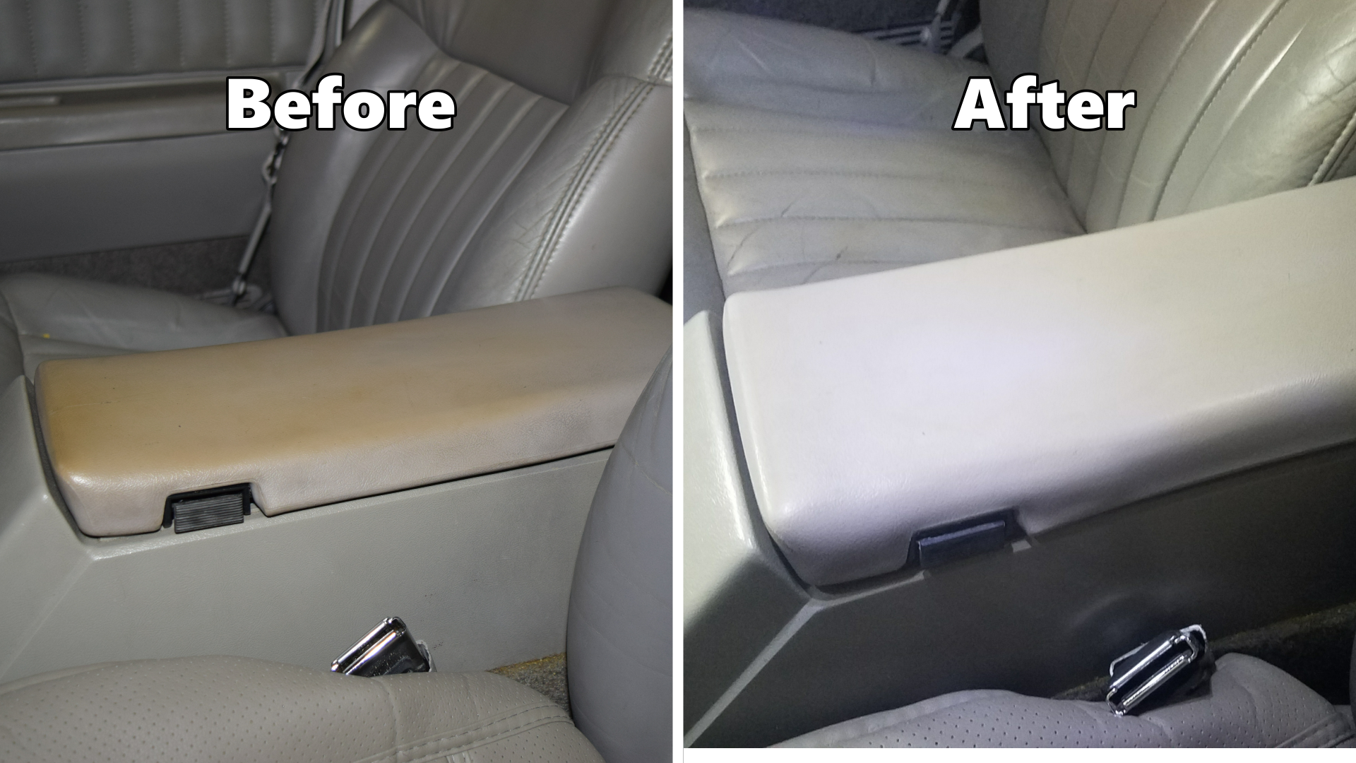

Overall I'm pleased with the results. . . I didn't realize just how much the Peroxide Cream did until I made before/after picture. Huge difference!! I'll definitely be using that one a few of my other interior parts that have yellowed a bit. As far as the plastic base. . .I'm not sure how long my epoxy repairs are going to hold up, as 2 small cracks opened back up when refitting the cover. I put another layer of epoxy in those areas, so we'll see.
