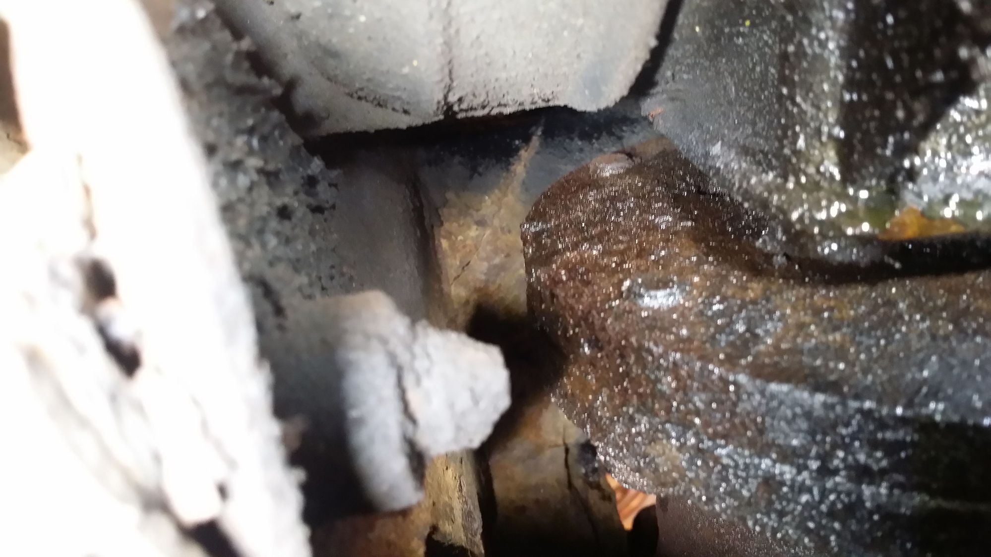

Well a little update and its bad news. I found a crack in the transmission case.:icon_evil:
When the transmission was in the old blazer it had a tiny leak from the transmission cooler lines, so when I took it apart I noticed both lines were plenty tight enough so I thought it was leaking around the brass adapter that threads into the transmission which the transmission cooler lines thread into the brass adapter. So I wanted to check to brass adapters to see if they were leaking, removed the bottom one no problem, when I went to remove the top one it was really tight, so I removed it put some sealer on it and when I went to tighten it I noticed something was wrong and a close inspection I could see a hairline crack. Check the pictures out. I went from having a good time to seeing red.
https://cimg9.ibsrv.net/gimg/blazerf...89b0432492.jpg
the crack is right above my fingernail, right on that casting seem.
So do I try to tig weld it? Im going to pass on tig welding it, I could but since I have another transmission Im going to pull all the new guts out of the cracked transmission and put those into the good case thats not cracked.
And check this out. Both transmissions are the same year 1995, suppose to be the same. Well it seems funny where the one transmission case is cracked it just so happens to be different between the two. Check out these pictures.
https://cimg1.ibsrv.net/gimg/blazerf...8c40456952.jpg
Cracked case
https://cimg2.ibsrv.net/gimg/blazerf...e1253d525b.jpg
Not cracked, notice no casting web.
So now I get to take everything back apart and do it all over.

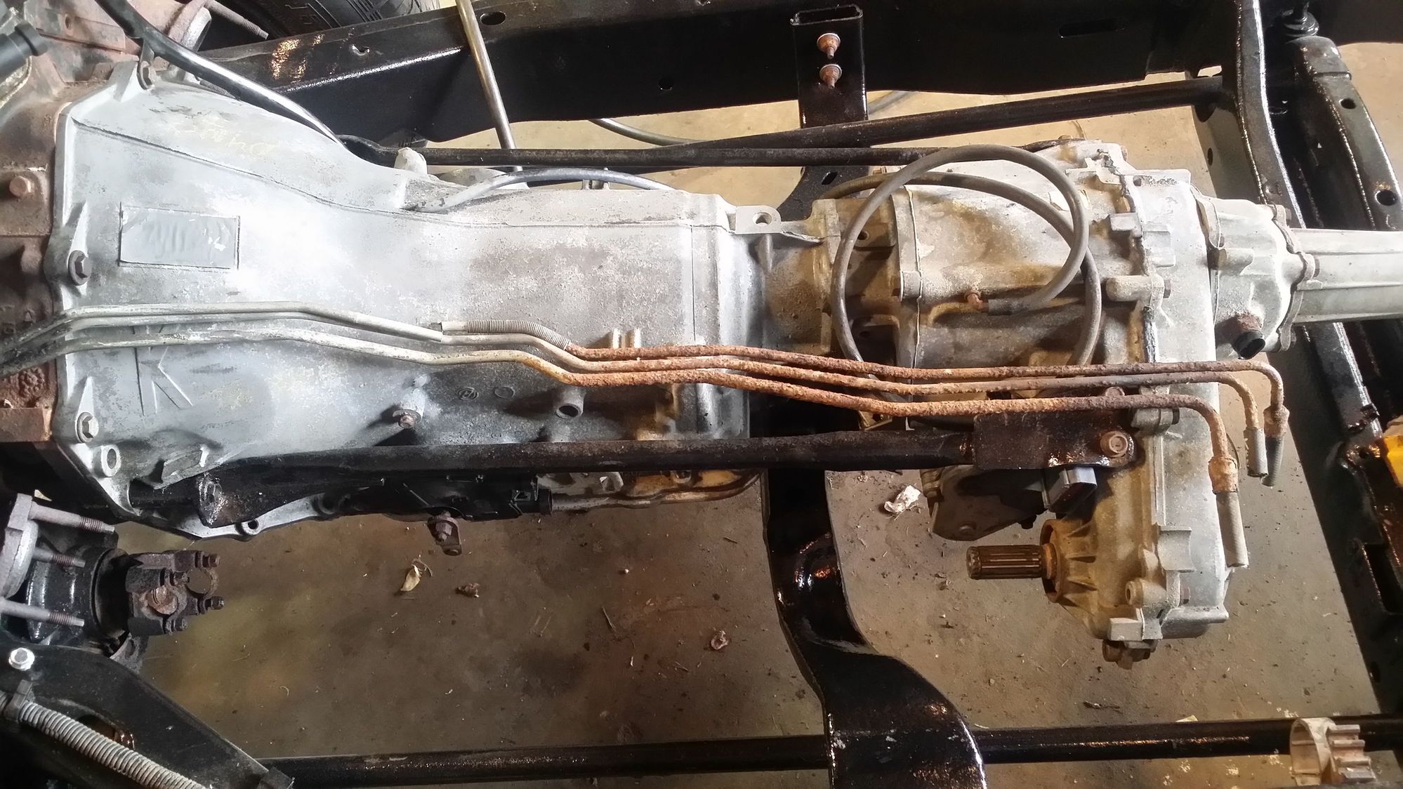

Im back where I was before I found the crack in the transmission and I got the fuel lines done, transmission lines done, power steering lines done, rear brake line done. Im almost ready to set the body back down on the frame.
https://cimg0.ibsrv.net/gimg/blazerf...9ceda79163.jpg
Old fuel lines
https://cimg1.ibsrv.net/gimg/blazerf...68f44d510b.jpg
New fuel lines, nylon with quick connects.
https://cimg2.ibsrv.net/gimg/blazerf...0355a09bab.jpg
Switched all fuel lines to nylon, no more RUST
https://cimg3.ibsrv.net/gimg/blazerf...e7ce8b8ce7.jpg
https://cimg4.ibsrv.net/gimg/blazerf...68241e418b.jpg
Used copper nickle for the vent line.
https://cimg5.ibsrv.net/gimg/blazerf...9b5438c626.jpg
Stainless steel transmission lines from Summit Racing. Notice the nuts are not stainless. Why would they put regular nuts on a stainless line, makes no sense to me.

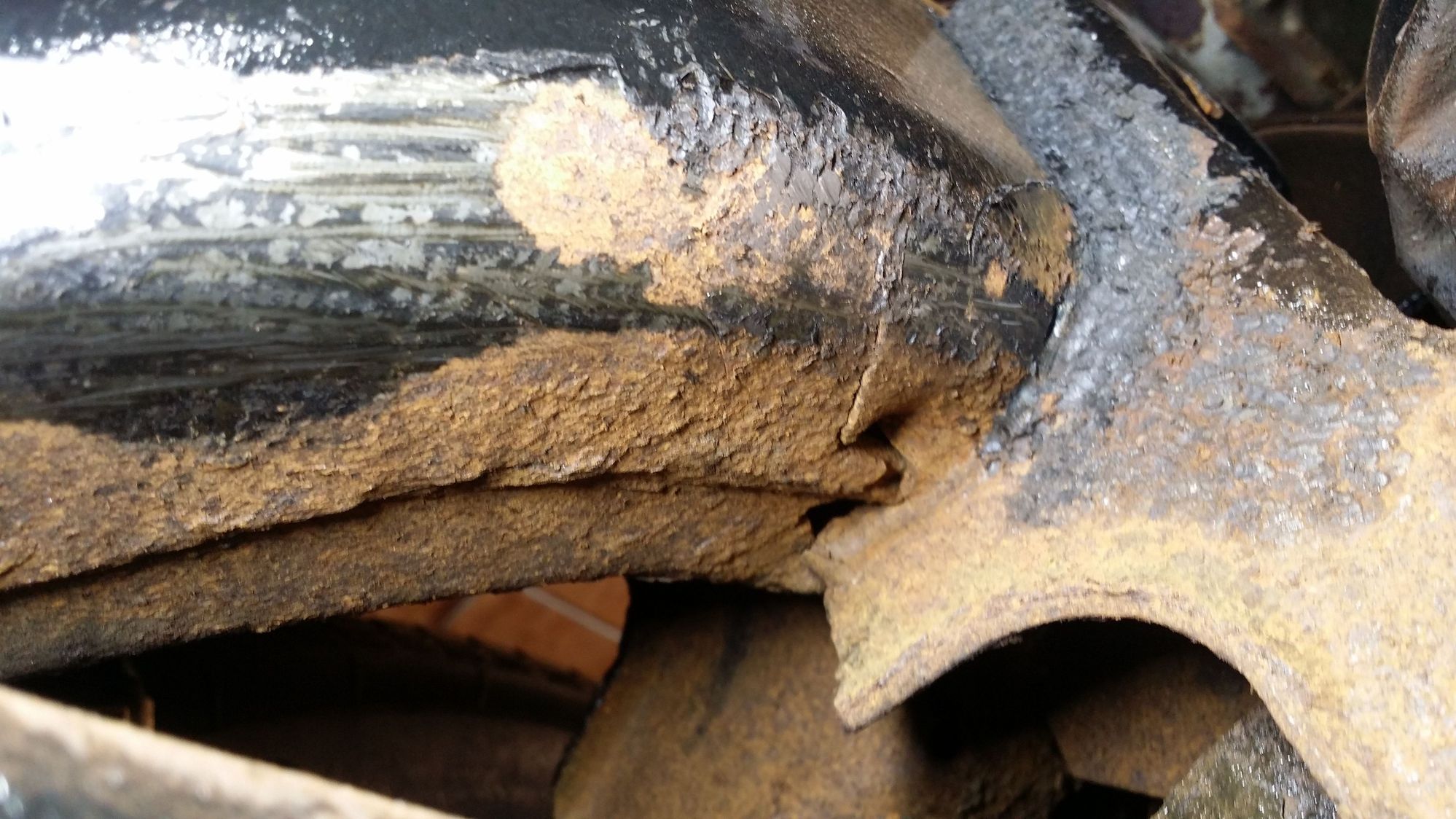

Well another pissed off moment for me. So I got to put the body on the frame so this means once again I could lift the frame body all at once on the lift. So I have it up in the air having a look around and son of a mother trucker. THE FRAME IS CRACKED:icon_errrr:
https://cimg4.ibsrv.net/gimg/blazerf...2ea6b1eebb.jpg
https://cimg7.ibsrv.net/gimg/blazerf...fb00ef2c2f.jpg
and on the other side of the bracket
So today I get to remove the front dif and weld up some cracks. I have seen a lot of blazers with the frame cracked around the front dif mounts but man o man how did I miss this crack 50 hours ago.
