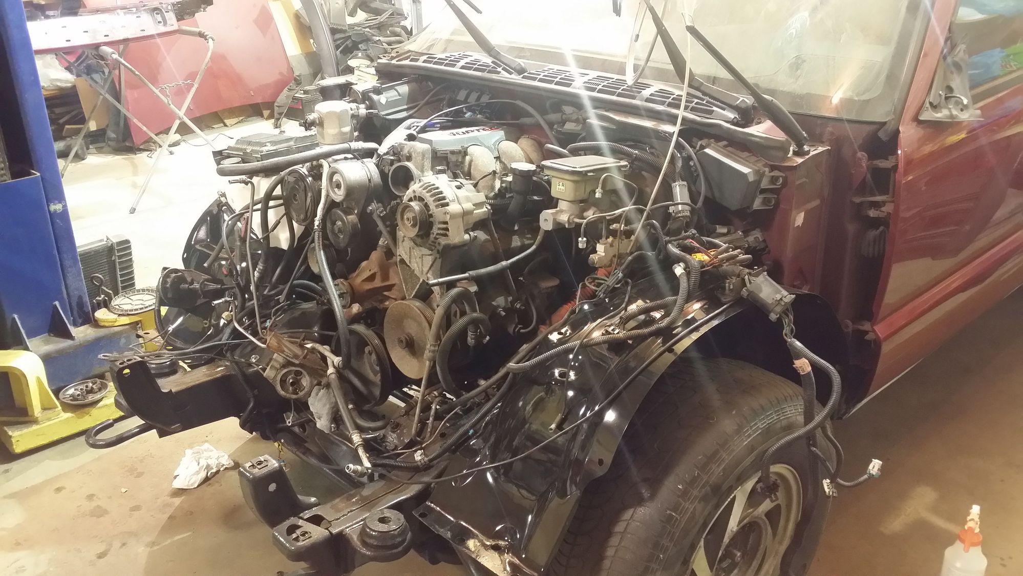

Its been a while... but I have made progress.
So the first thing I want to document is the difference between different 95 ignition systems.
https://cimg9.ibsrv.net/gimg/blazerf...fc5a299716.jpg

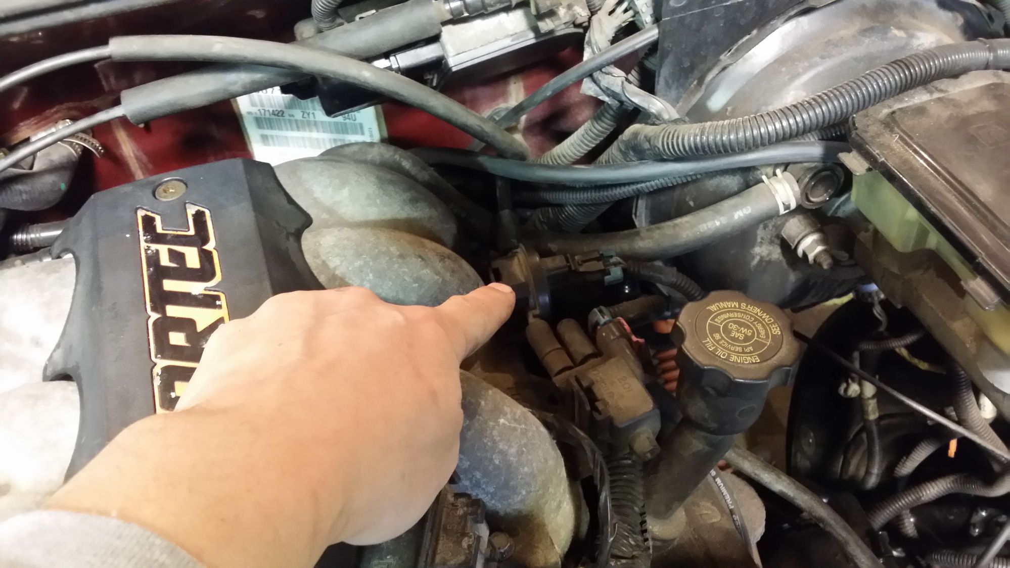

Purge solid switch
https://cimg1.ibsrv.net/gimg/blazerf...4766f084f2.jpg
Not sure what this thing is but the other 95 blazer did not have one.
https://cimg3.ibsrv.net/gimg/blazerf...8cd2f3f2ad.jpg

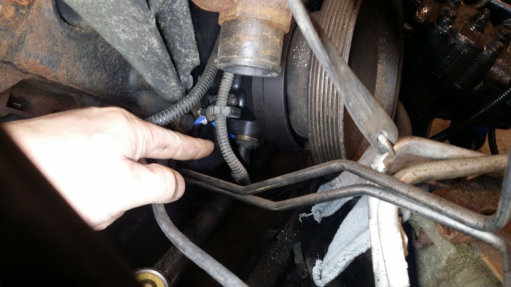

Crank Shaft sensor and reluctor gear
https://cimg4.ibsrv.net/gimg/blazerf...ad20d9cf2f.jpg
Harmonic balancer is different to.
and the distributor, distributor cap, and rotor are all different.
Who would have thought and thanks to GM for changing in mid-year also I would like to thank California for that BS emission differences was a pain at times. But what fun would it be without a challenge?

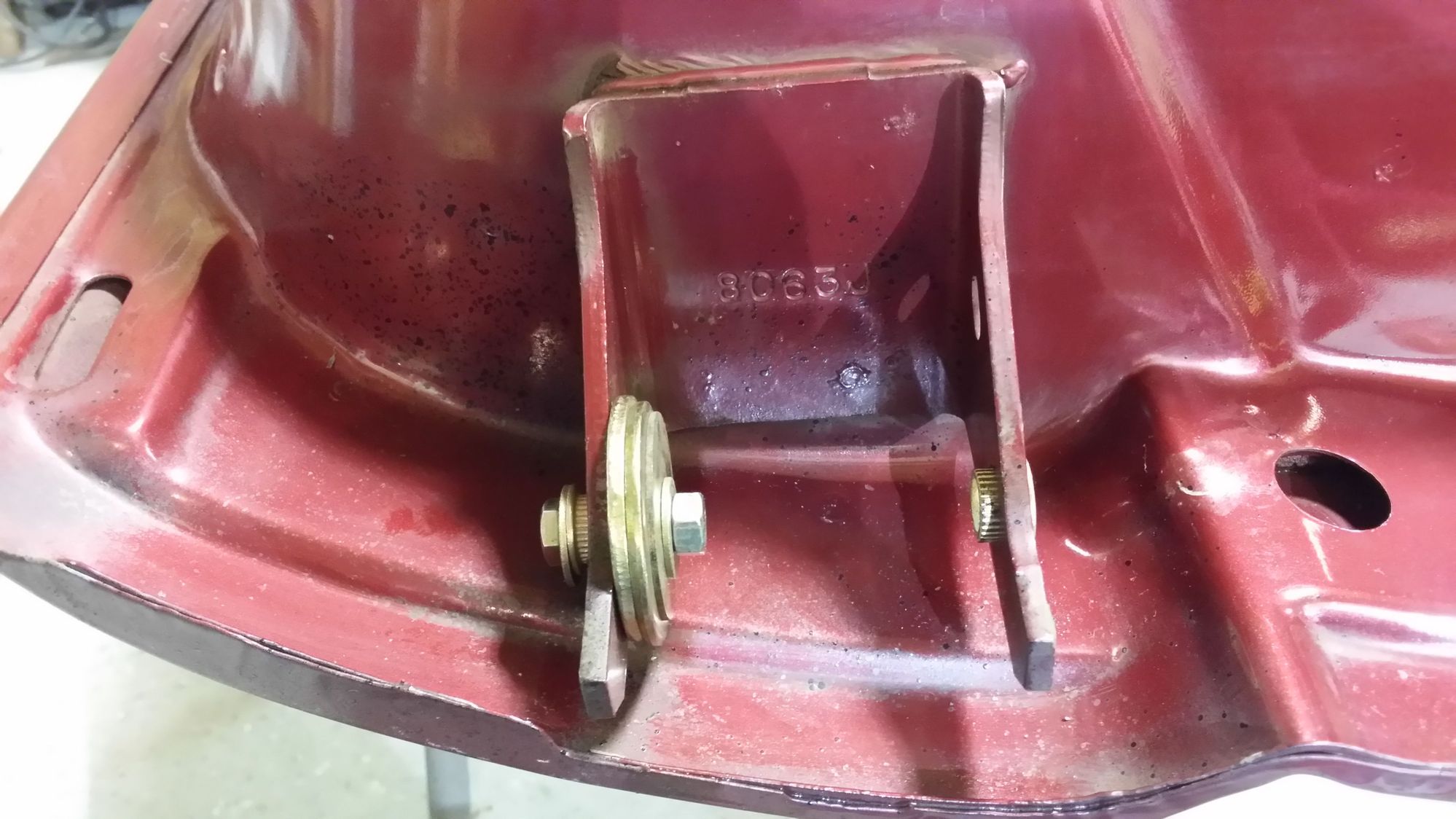

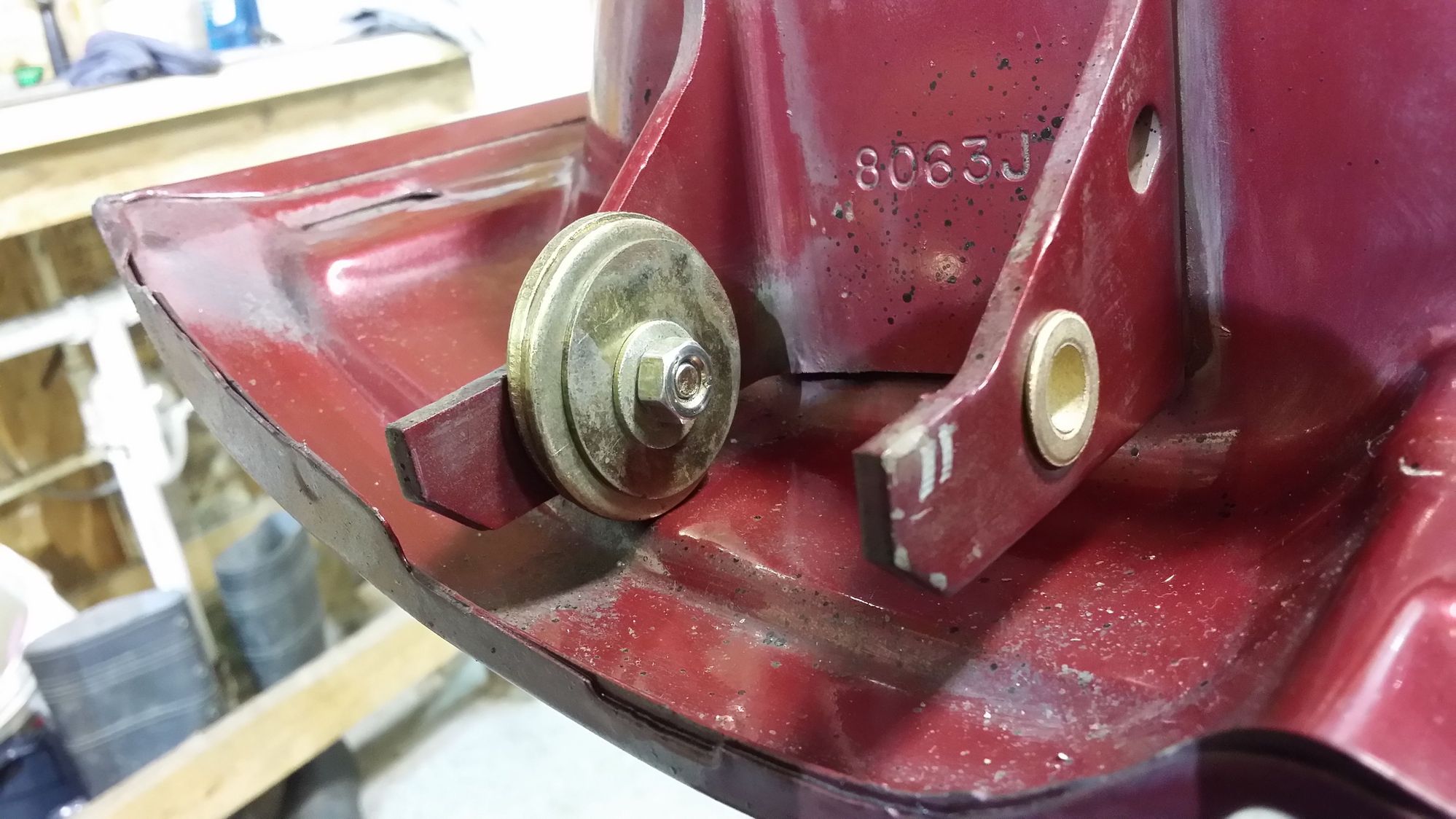

Took the doors off and replaced the pins and bushing. I also degressed the the door jams hings etc. Starting to think about painting so while the door was off time to clean her up.
https://cimg8.ibsrv.net/gimg/blazerf...44c471b67f.jpg
https://cimg9.ibsrv.net/gimg/blazerf...00acd622af.jpg
Also after 20 years of using a punch and hammer to install the door pins and bushing, I finally installed these the professional way. How could I have overlooked this method for so many years? Yeah, Im kicking my self in the butt wtf was I think....
https://cimg0.ibsrv.net/gimg/blazerf...a18e650109.jpg
Use a 1/4-20 bolt and press the bushings in.
https://cimg2.ibsrv.net/gimg/blazerf...3229bbf683.jpg
https://cimg3.ibsrv.net/gimg/blazerf...3c4b8d2b4d.jpg

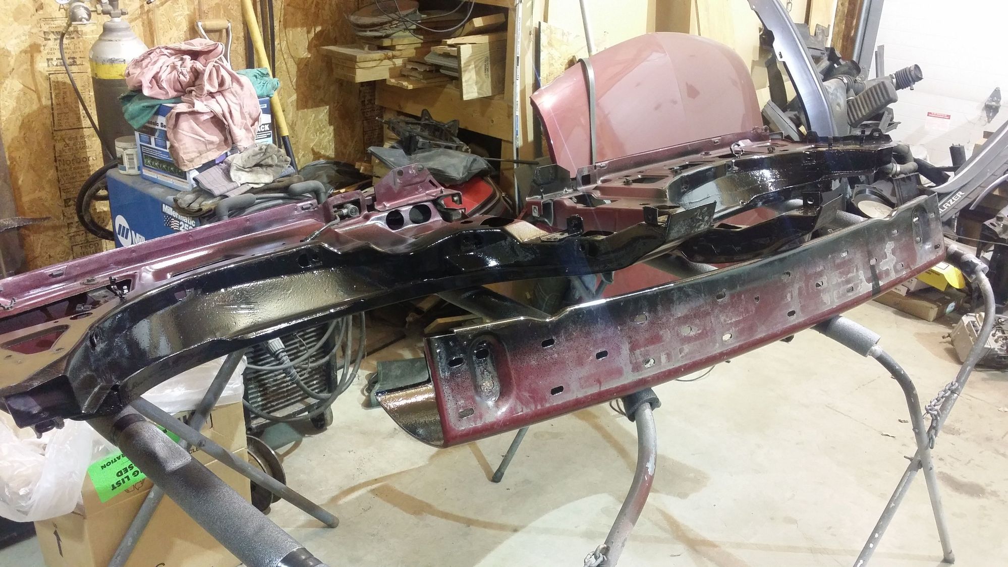

Heres a nice shot of inner fenders on and accessories bolted on. Im pretty impressed with the 25.00 inner fenders. The only extra holes I had to drill was the 4x4 actuator. Everything else lined up.
https://cimg6.ibsrv.net/gimg/blazerf...f275b0c621.jpg
https://cimg1.ibsrv.net/gimg/blazerf...6ceca354d8.jpg
MountainDew Nov 29, 2017 10:27 AM
Painted inside the fenders where the inner fender overlaps before installing. I also did the inside of the rear bumper.
https://cimg2.ibsrv.net/gimg/blazerf...5e7ee4d02b.jpg

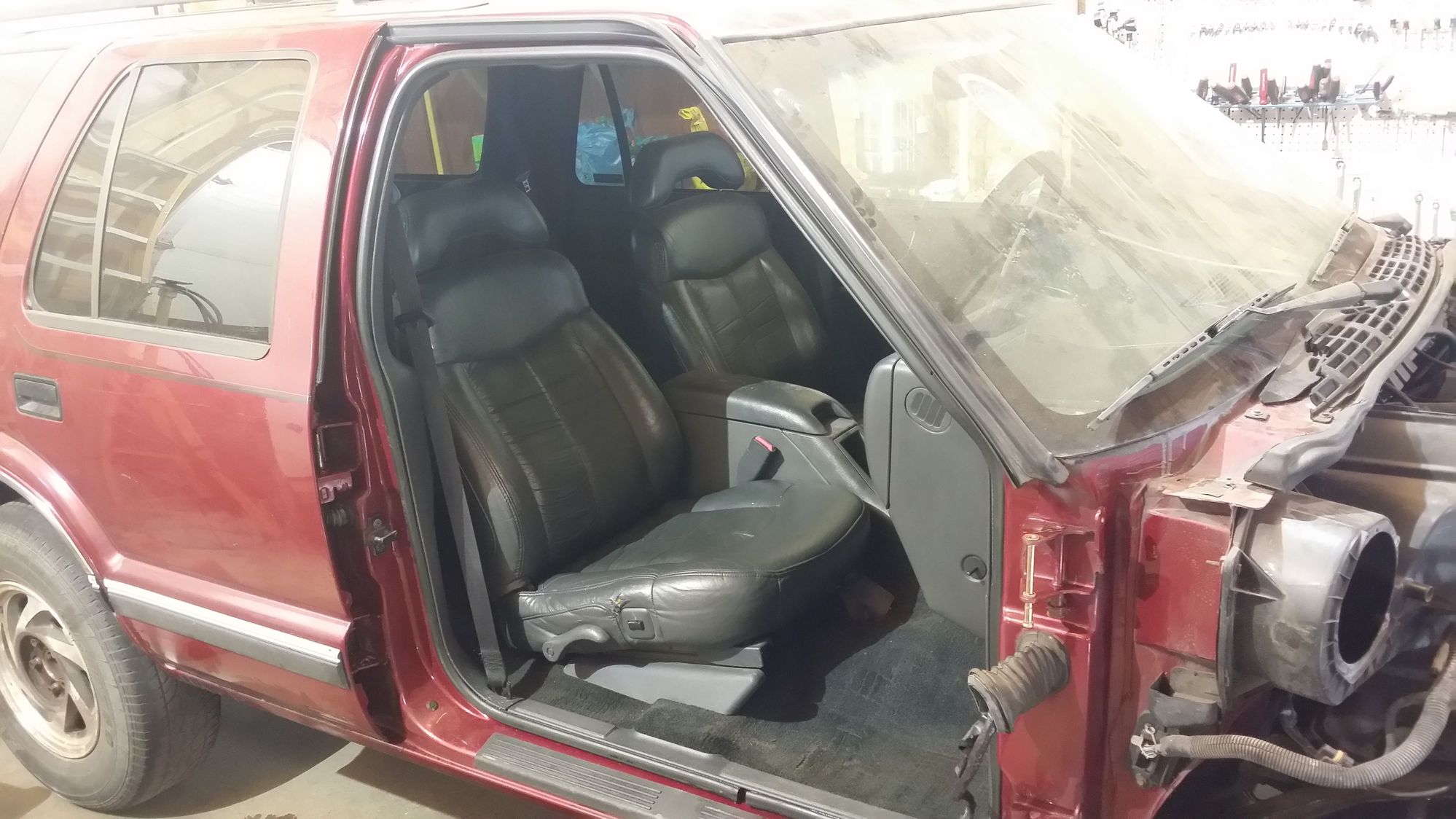

Heres the pisser. Where can I find new leather for the seats?
I really only need the driver side bottom.
