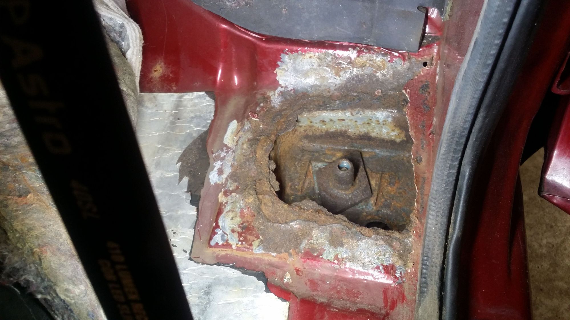

Ugh! So Im removing the interior trim so I can remove the door jam seals so I can back mask and it never fails RUST!!
https://cimg0.ibsrv.net/gimg/blazerf...7a2923cb39.jpg
https://cimg4.ibsrv.net/gimg/blazerf...800f6162d0.jpg
https://cimg5.ibsrv.net/gimg/blazerf...ac55ba2ca3.jpg
https://cimg0.ibsrv.net/gimg/blazerf...85309a7e32.jpg
Treating it with Corrseal.
So tomorrow I will weld a patch over it.

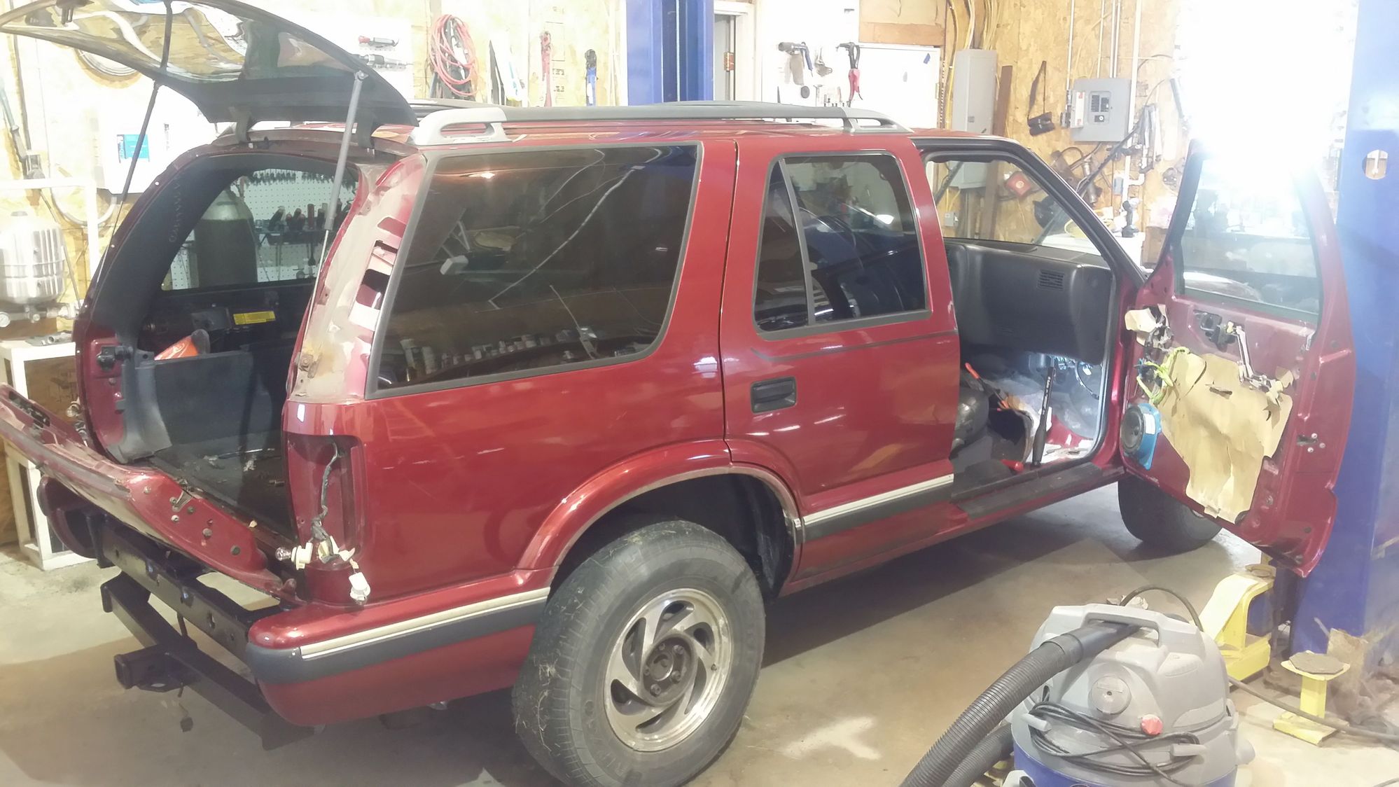

I also have decided to take all the doors off and paint the doors , hood, front bumper, rear bumper, and possibly the rear hatch all off the Blazer. I started thinking about it and since I have to paint the jams there would be no way to paint the pillar that divides the front and rear door. Even if I could paint it Im nervous that in my old age I will be to slow to make it all the way around the blazer without having dry spots in the clear. So I think taking the doors off is the only way. It's going to really test my skills, if it wasnt a pearl it wouldnt be such a big deal.

That rust hole in your floor is in a place where i would not expect it. Isnt that where your front body mount bolts into? Nothing a little piece of sheet metal and a welder cant fix im sure. I didnt know that was a spot that could rust like that.
error_401 Dec 5, 2017 10:09 AM
I fear about my 94 to have rust in the same spot.
Actually it could be easier a fix than I thought to replace the bracket which sits on the frame bumper.
I have not thought about cutting in from the top, but seeing your picture started an idea on how to fix that.
For the A-pillar and the light rust inside, I'll either drill one or two 1" holes from the inside to properly spray it with corroseal or such and/or have it treated with a corrosion prevention wax, simply over the rust.
yeh man it is odd considering the underside is solid and it only rusted inside the support beam. So from underneath, you see a nice solid support beam- body mount.

I got all the doors off tonight, I also got a new addition to my paint gun arsenal. DeKups by DeVilbiss. No more cleaning the cup out, I also can have to 34 oz cups mixed and ready to spray and with this system I can spray upside down and the gun wont run out of paint or sputter.

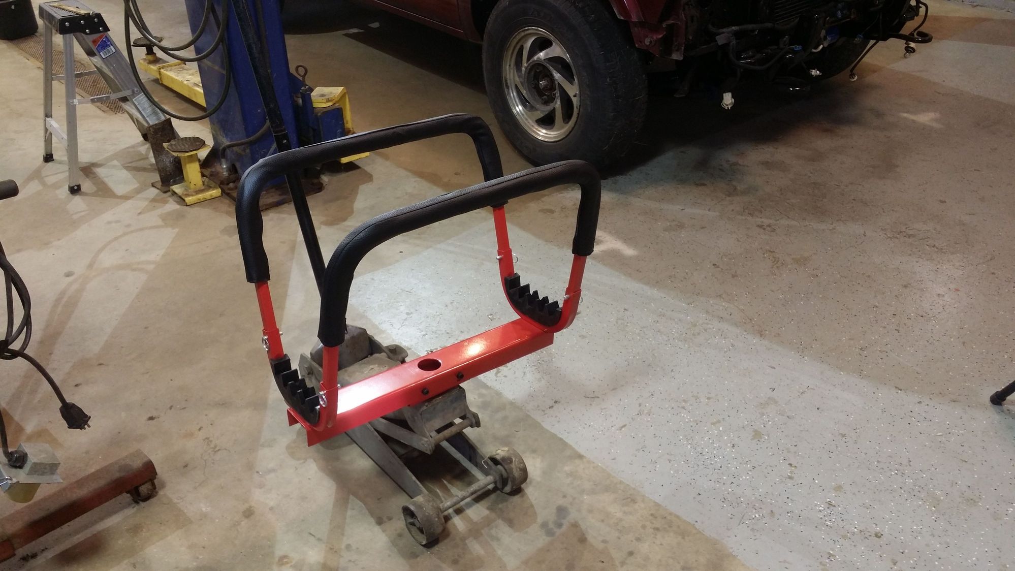

So easy to take doors off with this handy support

Where'd you get that door strand for the jack? And how much was It? That would be super handy around the shop.
