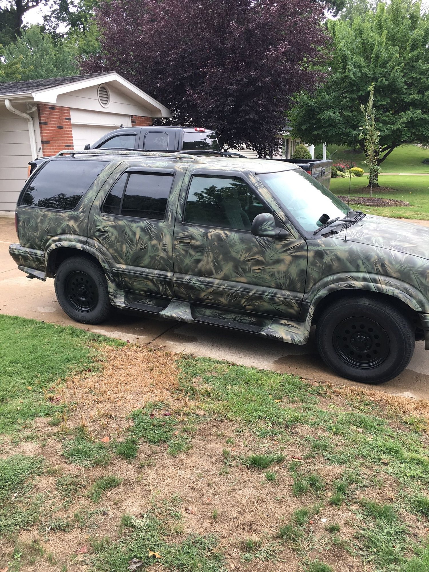

I’ve got a 4 door I hunt with. Had new tires so I’ve not messed with suspension. I couldn’t bring myself to spend 20k on side by side.
Plasta dip base black then regular spray paint lol

Cool paint job!
