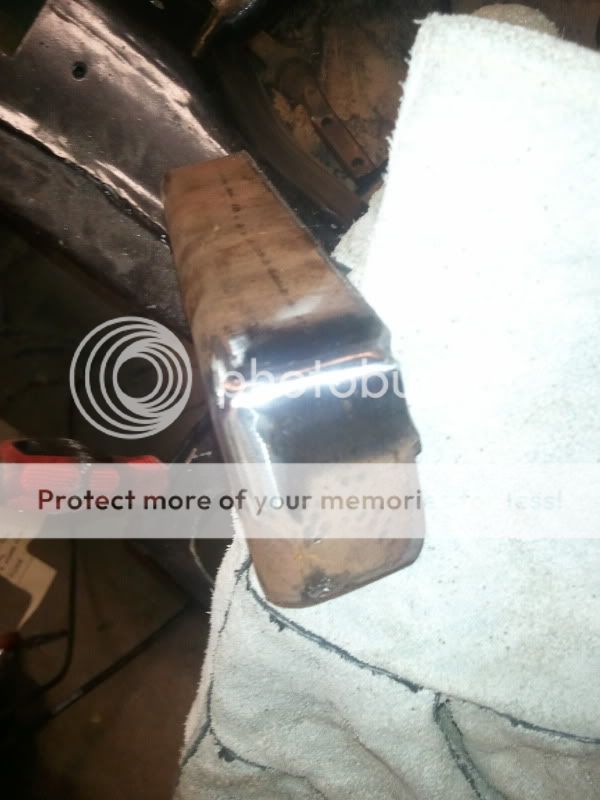

I got a piece of steel and welded it in place and grinded it down.
I got the plate for the a/c notch welded up now to weld it into the frame but I'm going to do a test fit with the engine and trans

Glad to see this coming together after such a long time lol. Keep up the great work.
NICE WELDS!
