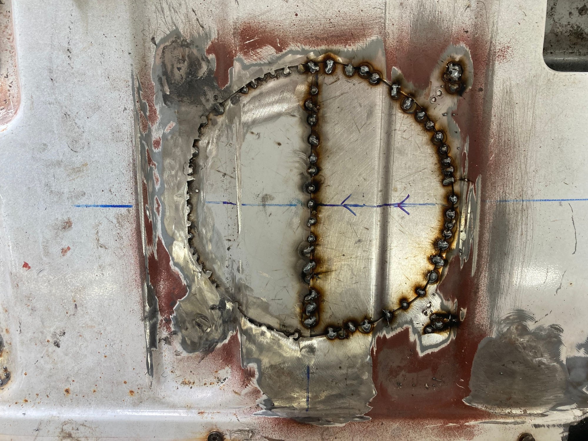

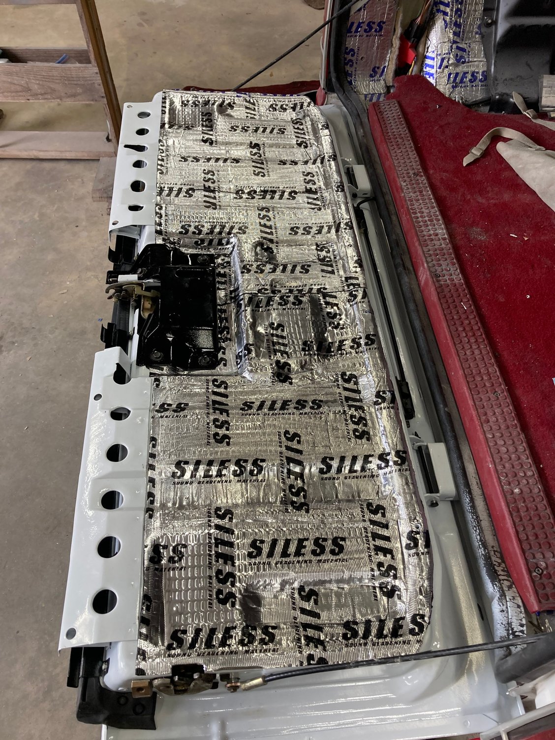

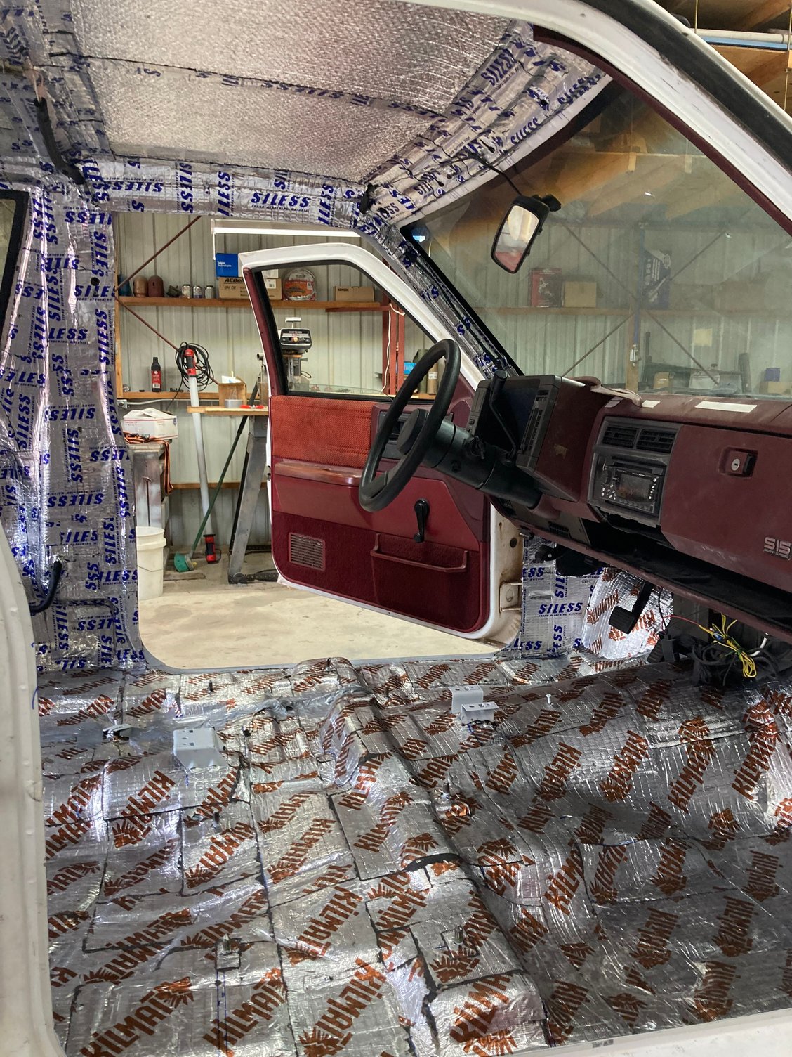

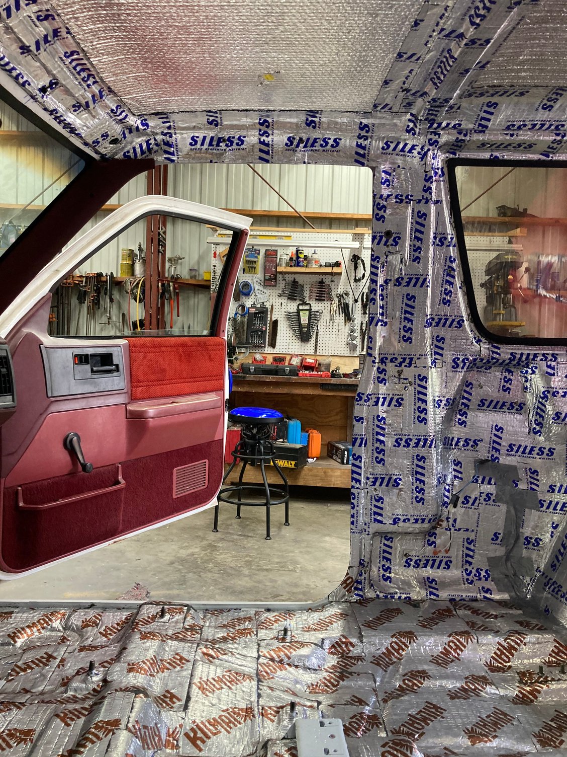

Sound Deadening installed, speaker holes in tailgate welded closed, body filler and paint followed by sound deadening. Complete carpet installed since the pics taken, front seats are installed. Carpet had jute and mastic padding for additional sound deadening and heat resistance. Before in installed the sound deadening and install 8-32 Rivnuts for all the body panel srews.
