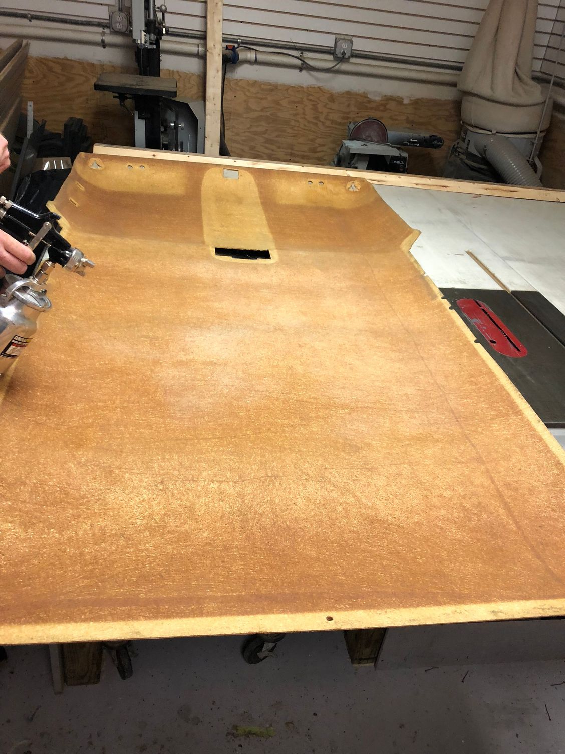

The headliner will be recovered in new black fabric and installed tomorrow along with the overhead console, sun visors and a-pillar covers.

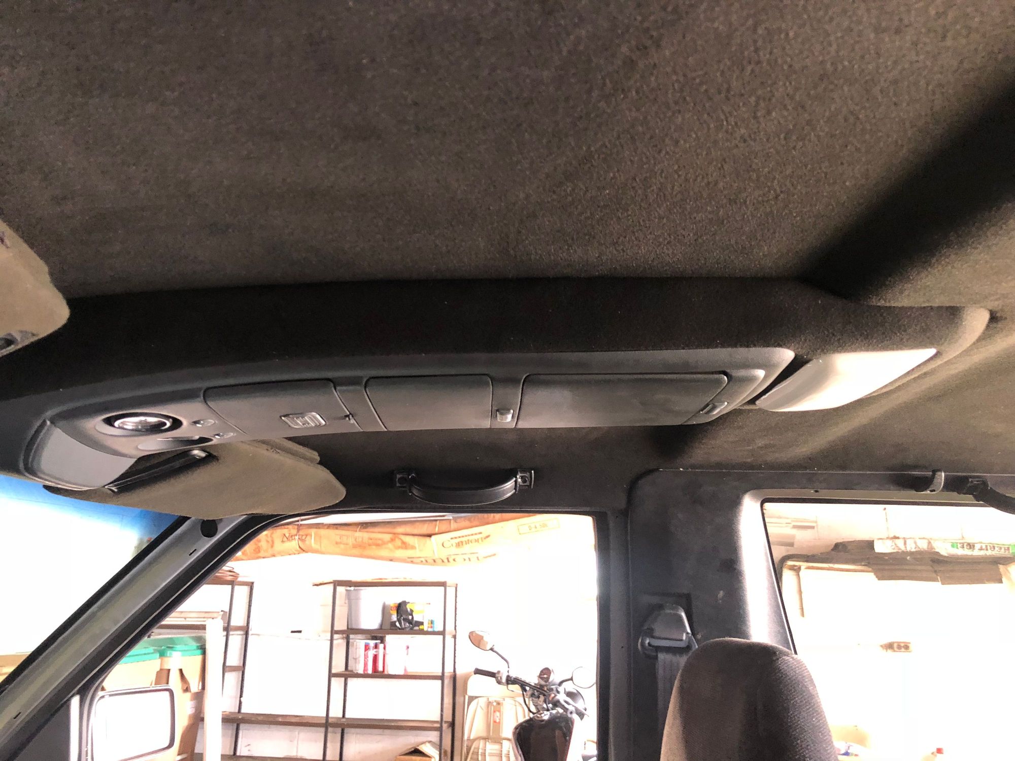

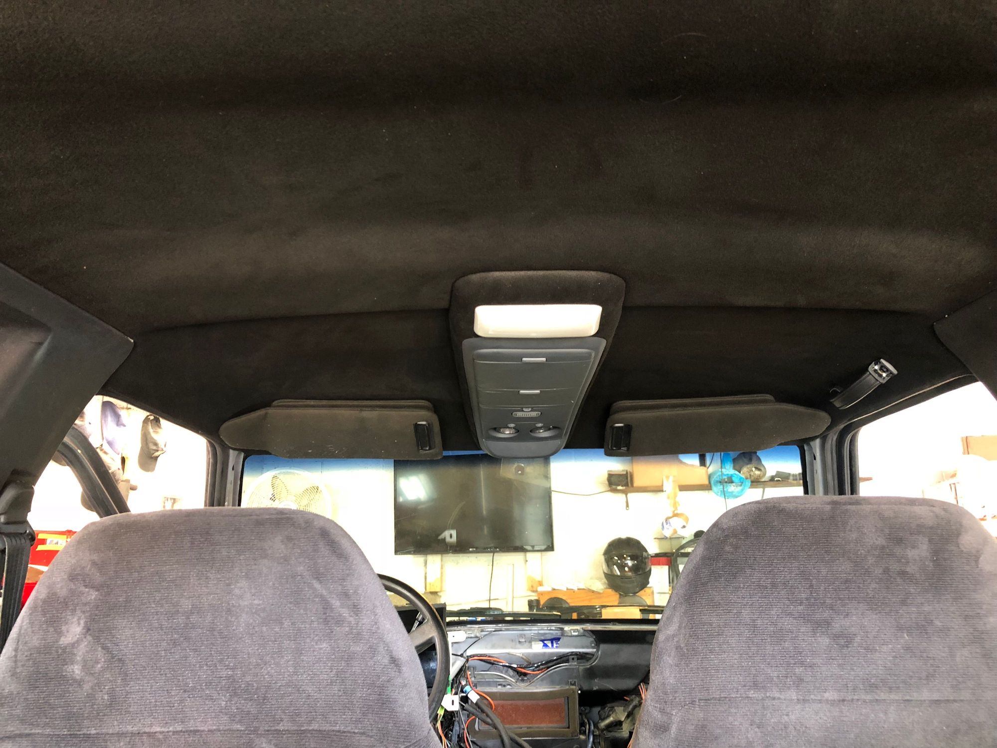

Also didn’t get the headliner wrapped today but no fear, I’m off work for the next two weeks!

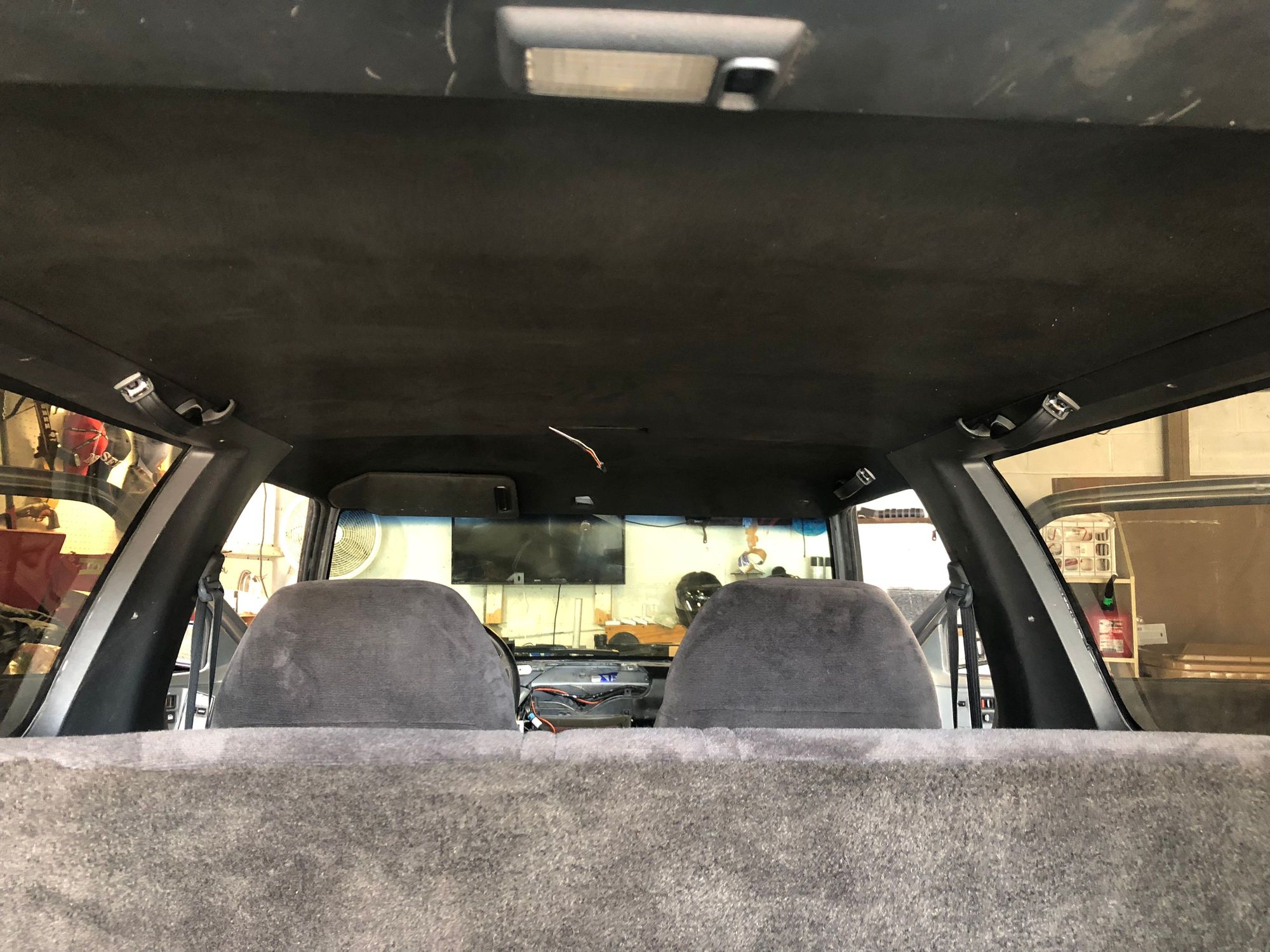

KnightBlazer Jul 25, 2018 12:50 PM
Nice work. . Driven it yet?
Going to be luxury now with all that sound deadening. . making me jealous. Lol every time I put a little more insulation in mine it just makes the parts that still rattle that much more obvious/annoying.

KnightBlazer Jul 25, 2018 03:54 PM
Well headliner looks great. . again I'm jealous lol. Hopefully putting the rest of it back together won't be too bad.
