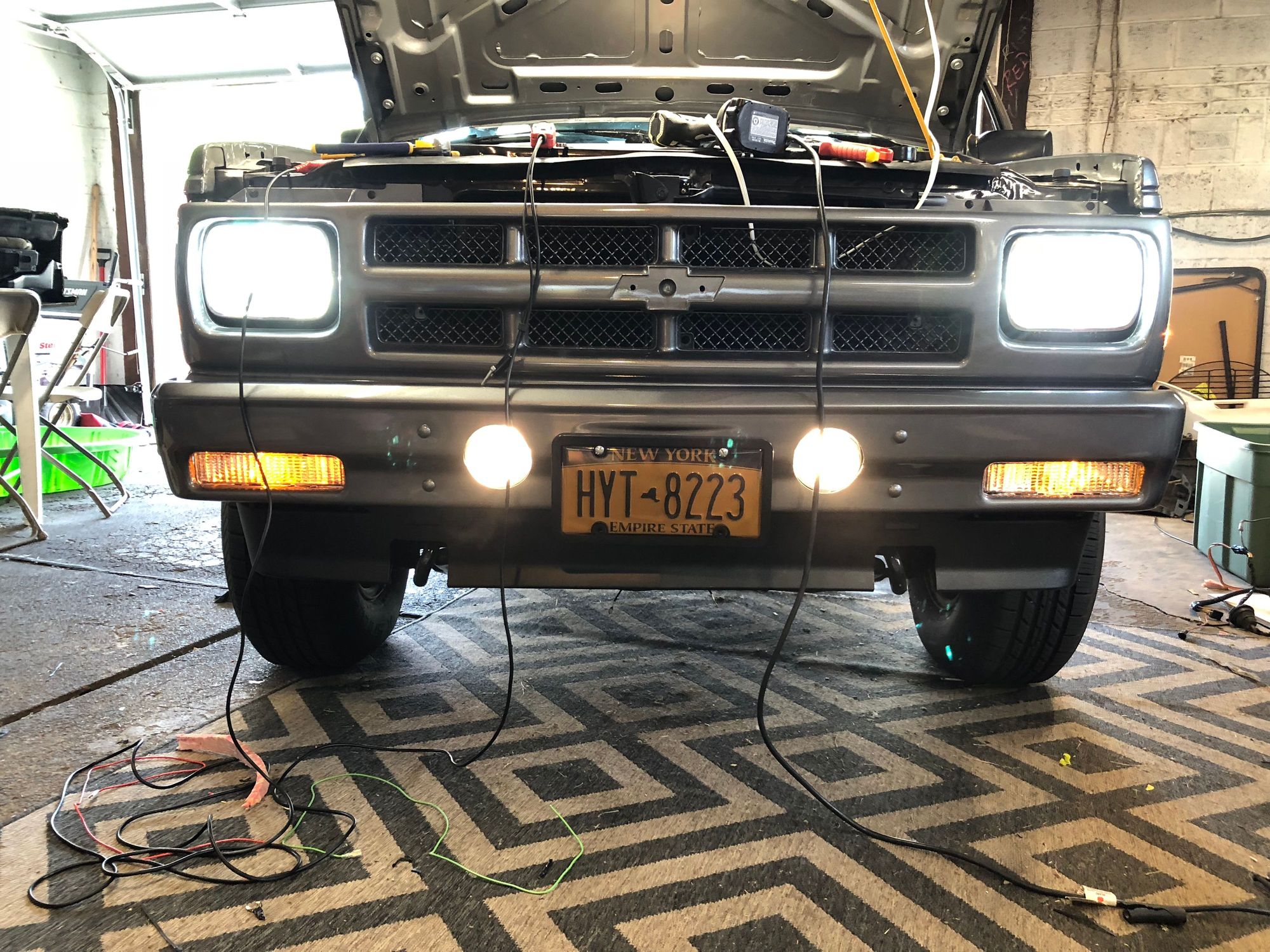

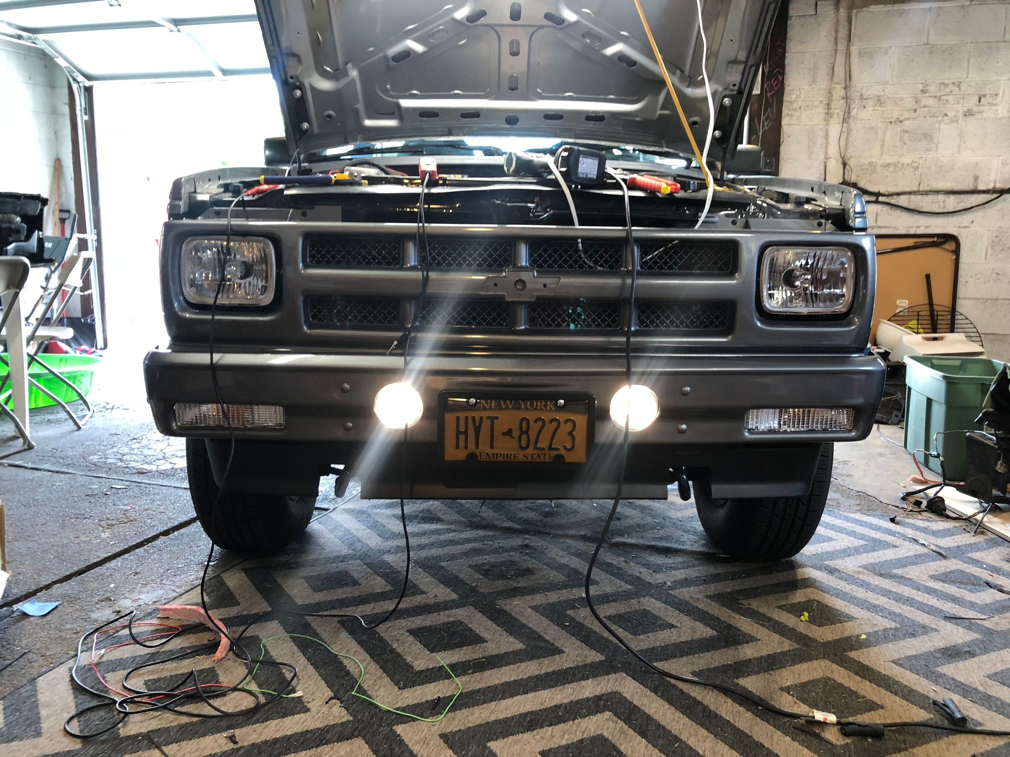

I got annoyed at the dashboard, vacuum hoses and getting it all in place so I can connect all the switches and put it back together. Hard to do it without a second set of hands and eyes to see where to route things as close to factory as possible. Even with the full service manual, running the wires and hoses and vacuum tubes is a pain in the butt. If anyone has any suggestions, I’m open to them.
So, I took a break from the dashboard and HVAC to wire up the fog lights.
johncharles Jul 27, 2018 02:29 PM
https://cimg1.ibsrv.net/gimg/blazerf...1d28d1588.jpeg
https://cimg3.ibsrv.net/gimg/blazerf...7f683ee80.jpeg
I will need to get LED bulbs for the fog lights to match the headlights.
