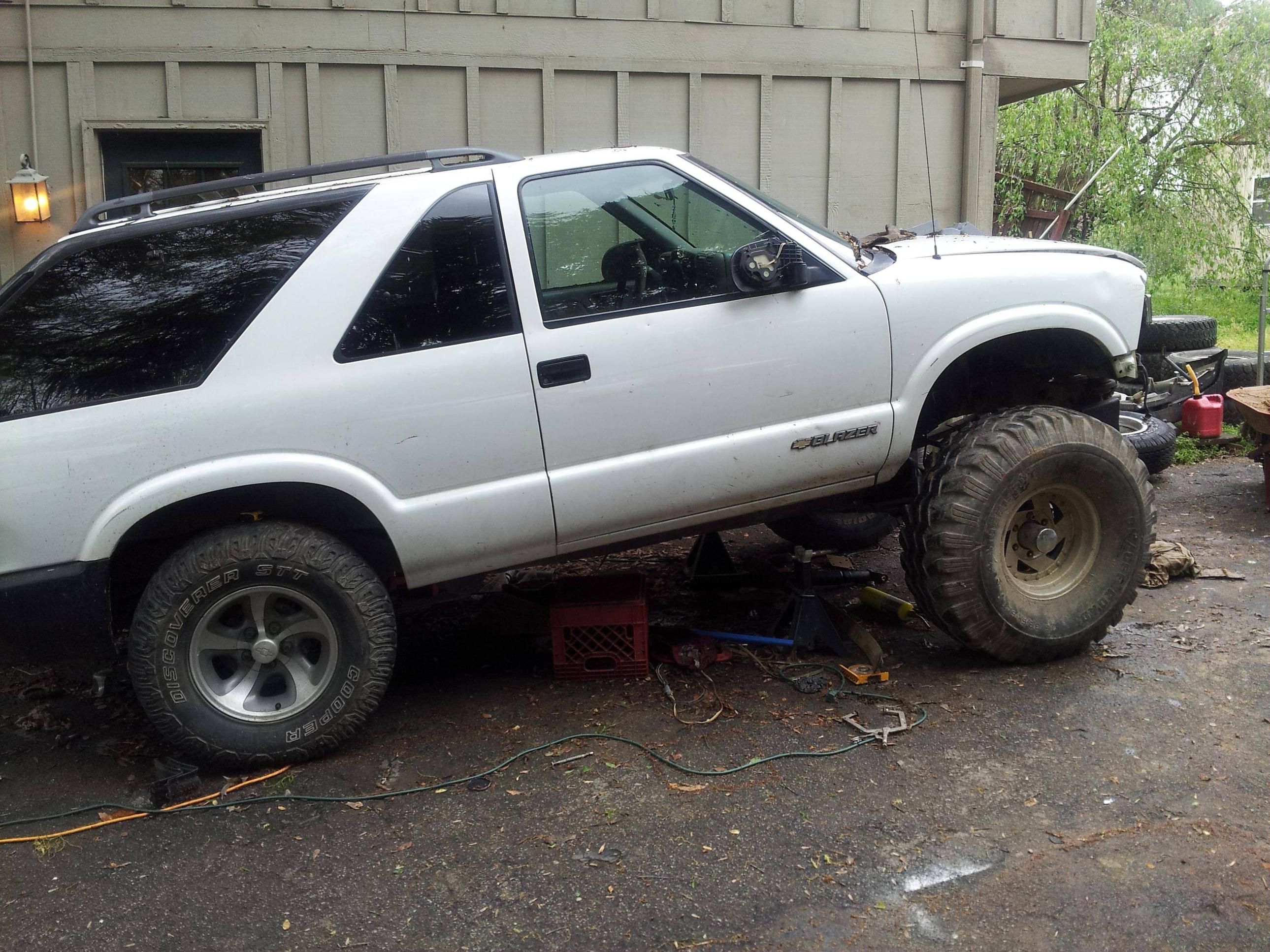

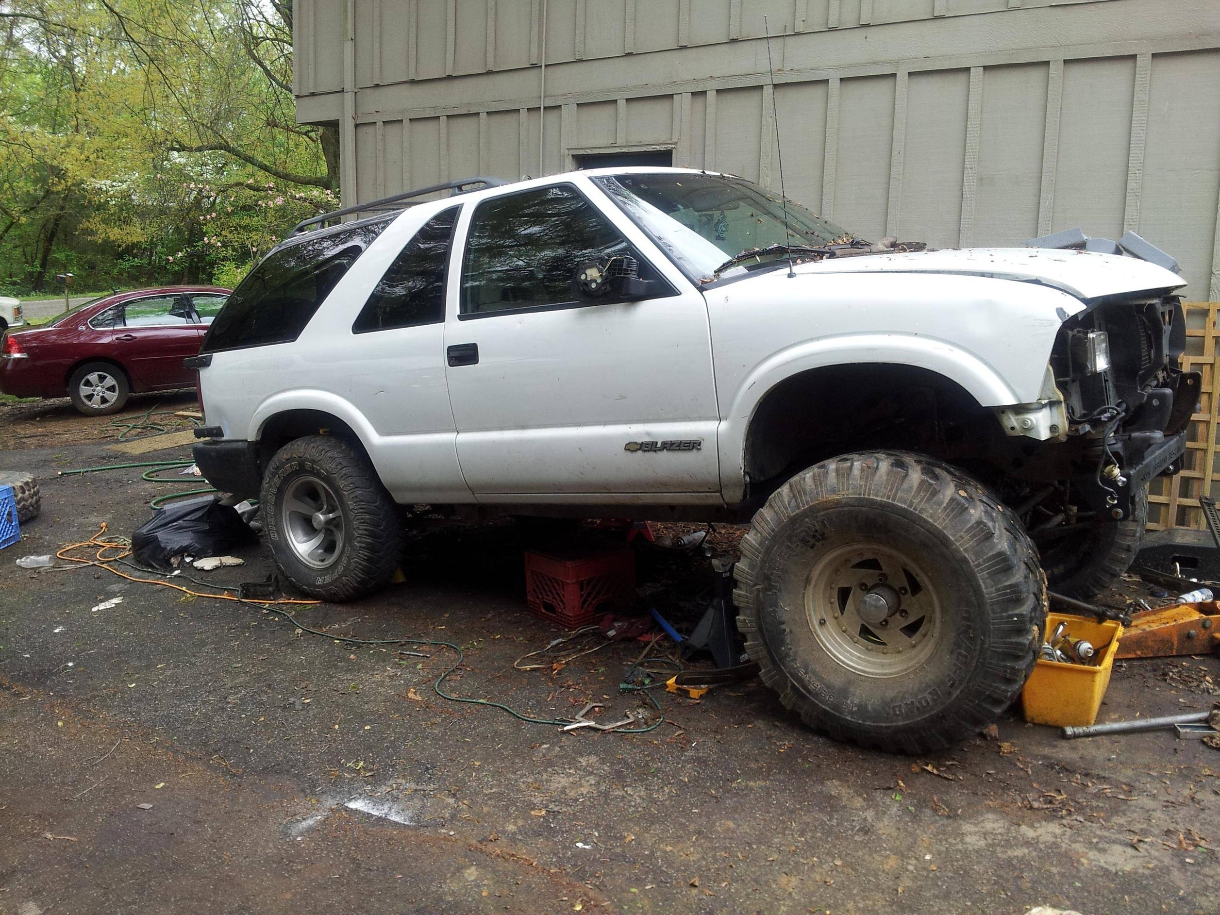

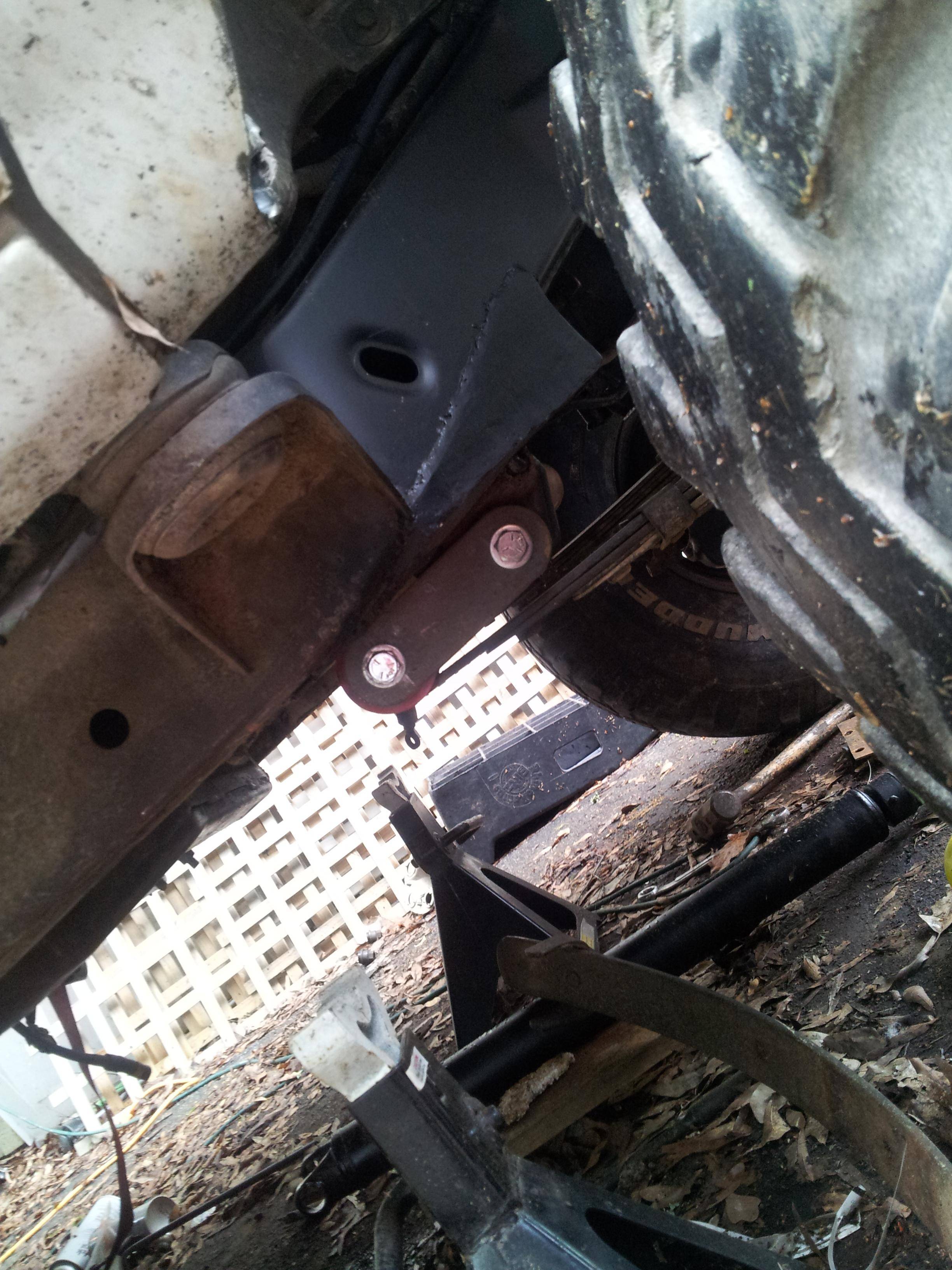

Here it is sitting on 38s... I plan to have everything done This Sunday finally got caught up on everything, and buying wheels next paycheck what backspacing should I get... I like how these look but my truck will get messy as hell on wet road/offroad. Also have to redo the shackles on the front after removing a leaf its sitting on the frame.

oops. At least its only tacked in. Moving the shackle mount back 2-2 1/2" should fix it right up!
Looking good!

check your full turn left and right as the truck sits now. if you get rims with less offset so the wheels are tucked under more the tires may hit the frame or other parts underneath the truck. my tires stick way out too it sucks, one mud puddle and the side including the windows is completely covered in mud and you cant see anything. thats pretty much why i cut my roof off, i got sick of not being able to see.
also look at the plus side of that. the tires sticking out past the fenders will protect the body from damage, the tires bounce off trees and rocks where as your body will just dent

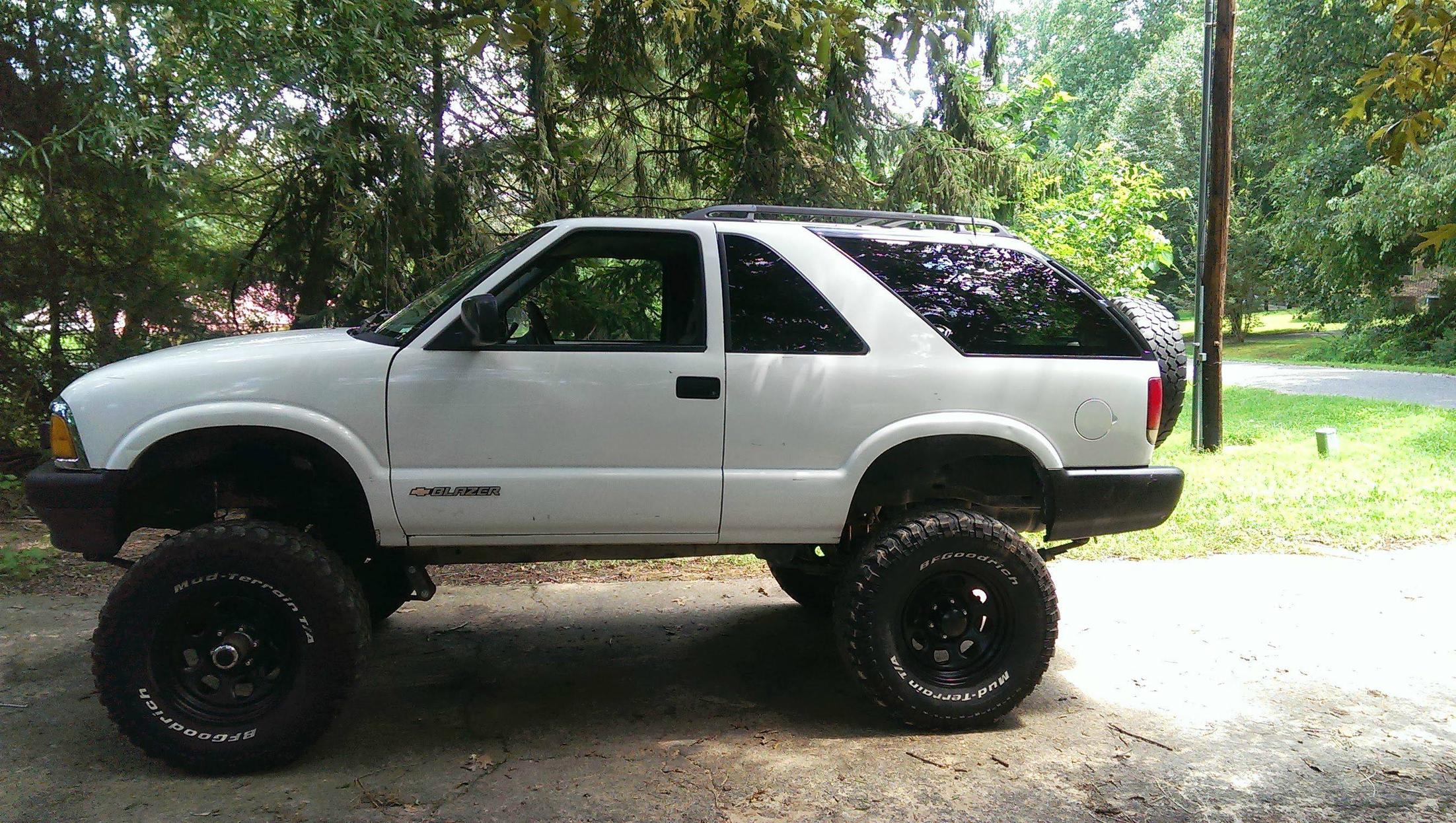

Hey Guys, She is finally almost done just need shocks, drop pitman arm, and my exhaust re routed.

The only problem atm is that my front springs are way way way too soft compaired to the rear... what would be the best way to fix this other than adding leafs because i dont want anymore lift in the front. Thanks everyone for all the input, and help.
