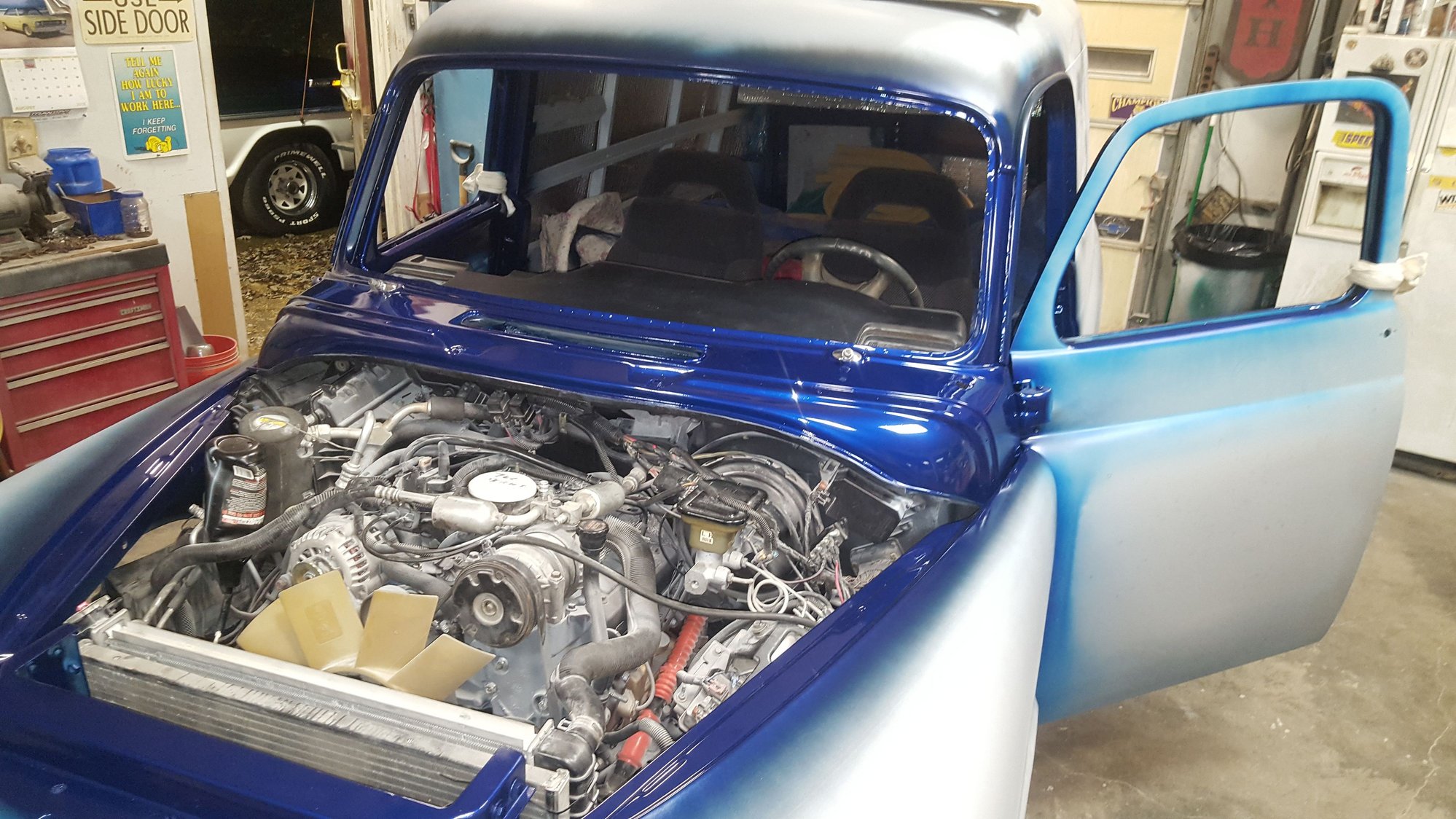

Default mater jim
rear floor pan from 97 jimmy 4dr
bolted to frame, sheet metal added to fit 54 panel truck
s10 rear panels fitting nicely, gotta make some upper panels to support headluner and cover wall space
steam pressure is amazing way to clean carpets

Default 97. mater jim
im very happy to say that after months of waiting for all the pieces of the puzzle to come together, factor in several modifications and much luck.
the windshield wipers work.
using the 97 s10 firewall and the 54 dodge. opposing wipers setup, . they actually have full travel
opposing wipers
now to figure out the headliner and visers

Default mater jim
hood aligned well
craziest s10 ever. 4x4
painted the old dash for a shop wall hanger
fresh 4.3L vortec. had to raise breather 4 inches to clear dual a/c lines
day 1
day 412
back doors
old suspension fell out
