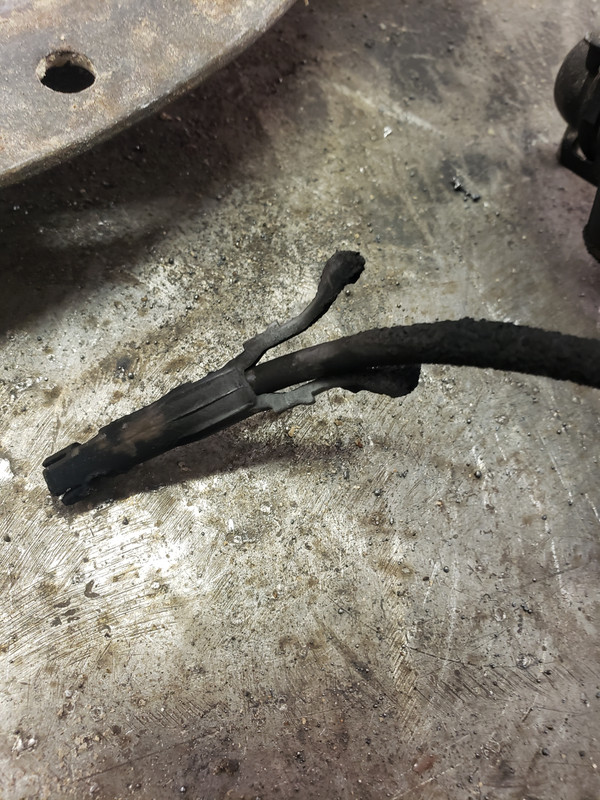

Had to replace the spider.
I got most of the hoses and wires hooked up. I should have it running next weekend.

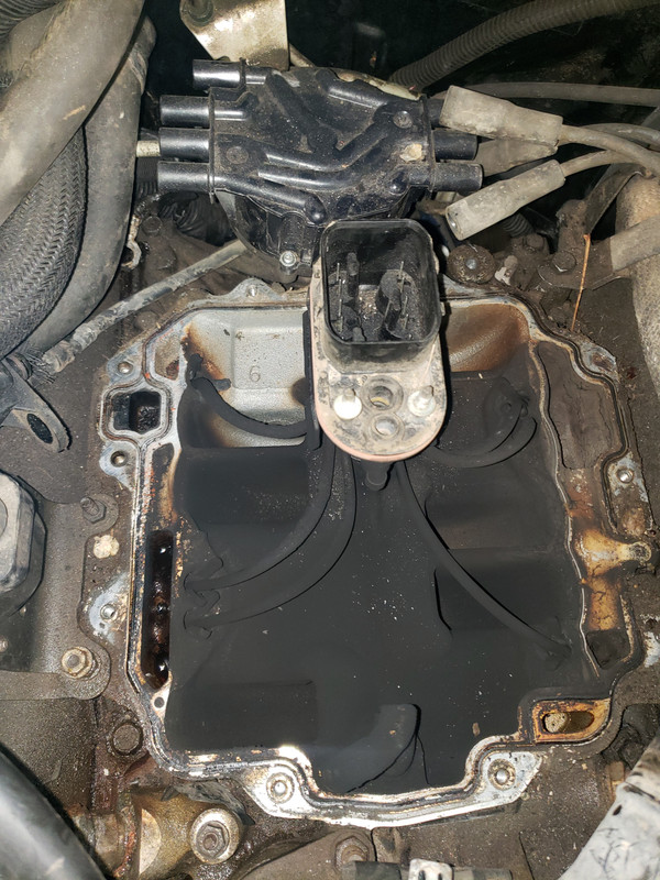

Sorry to hear about the accident, but glad you're ok. WTF happened in your intake manifold?

Tom I have no idea, this is the worst one I've seen. Engine has 210,000 miles and the upper intake gasket came out in pieces. It has had a random misfire for a while.
Old Oct 8, 2021 | 07:06 PM
  #26
Looks like EGR gone wild or something.

Yea there is alot of build up. I cleaned it up and swapped a bunch of parts from the other engine on to it.

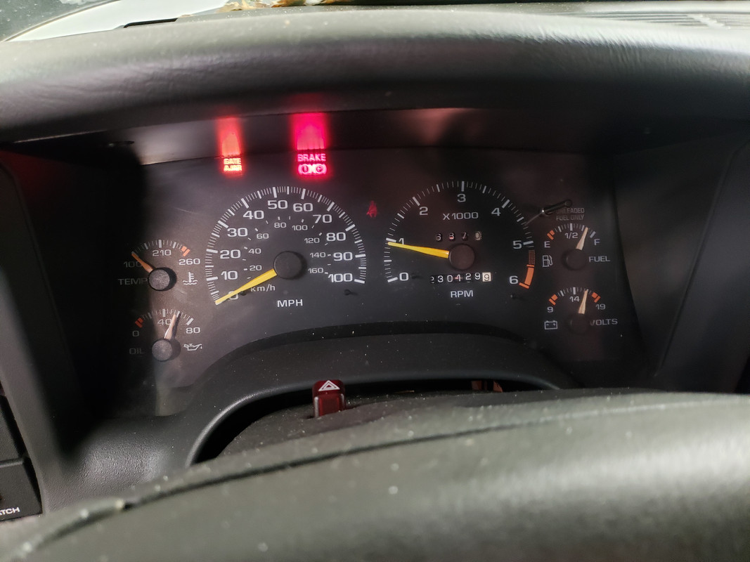

The blazer has left the shop and is home! I have to replace the seals on the oil filter lines but it runs!
