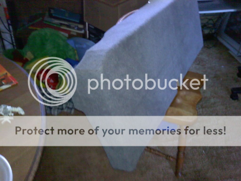

First thing I did was build then enclosure. 4.2cuft net tuned to 32hz with a plexi window.

The pictures of everything between the box done being built and me beginning to prime it are lost. So sorry for the jump through time here.
Now I'm putting the color on. Found out the hard way it's not a good idea to paint in high heat and humidity. Anyone familiar with paint and body work knows of "blushing". I discovered what it was and the pain that it is first hand this summer.
Clear helped "wetten" up the look of the paint which helped with the "blushing".
Voila, finished enclosure. Or nearly so, have lots of clear overspray dust to clean up out of the inside. (the white stuff on the bottom)
