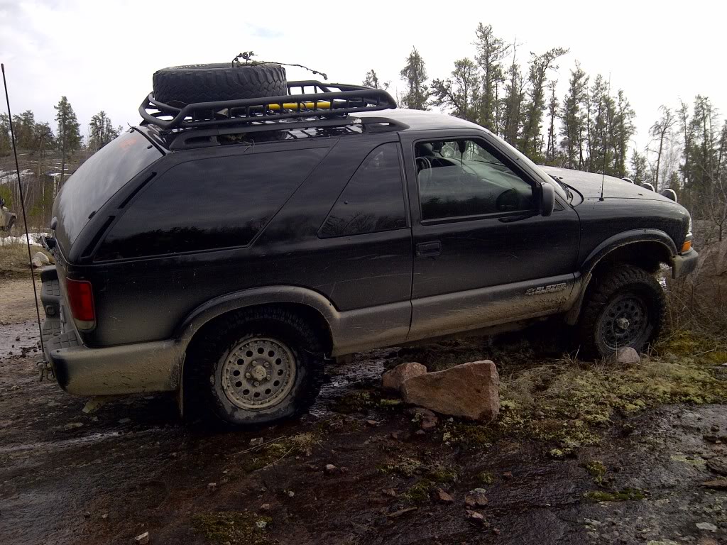

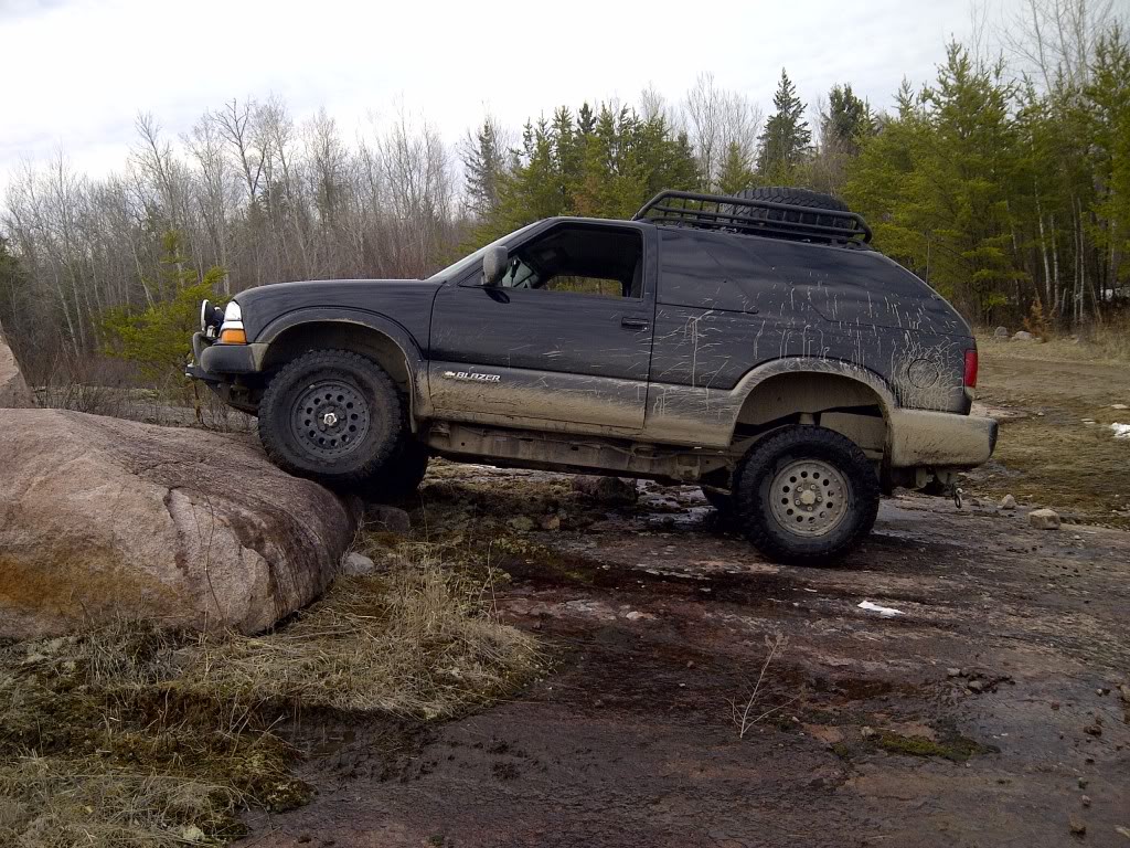

Flexing on 31's
A little bit of mud on 31's

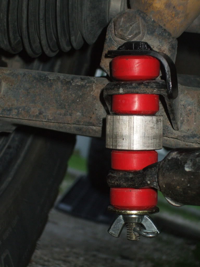

I made up some swaybar disconnects.
I didn't use them much and because they sat so low they got destroyed twice.

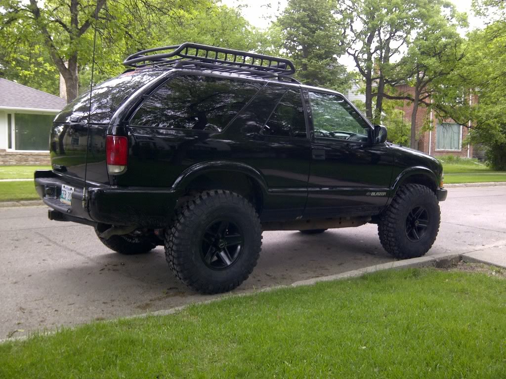

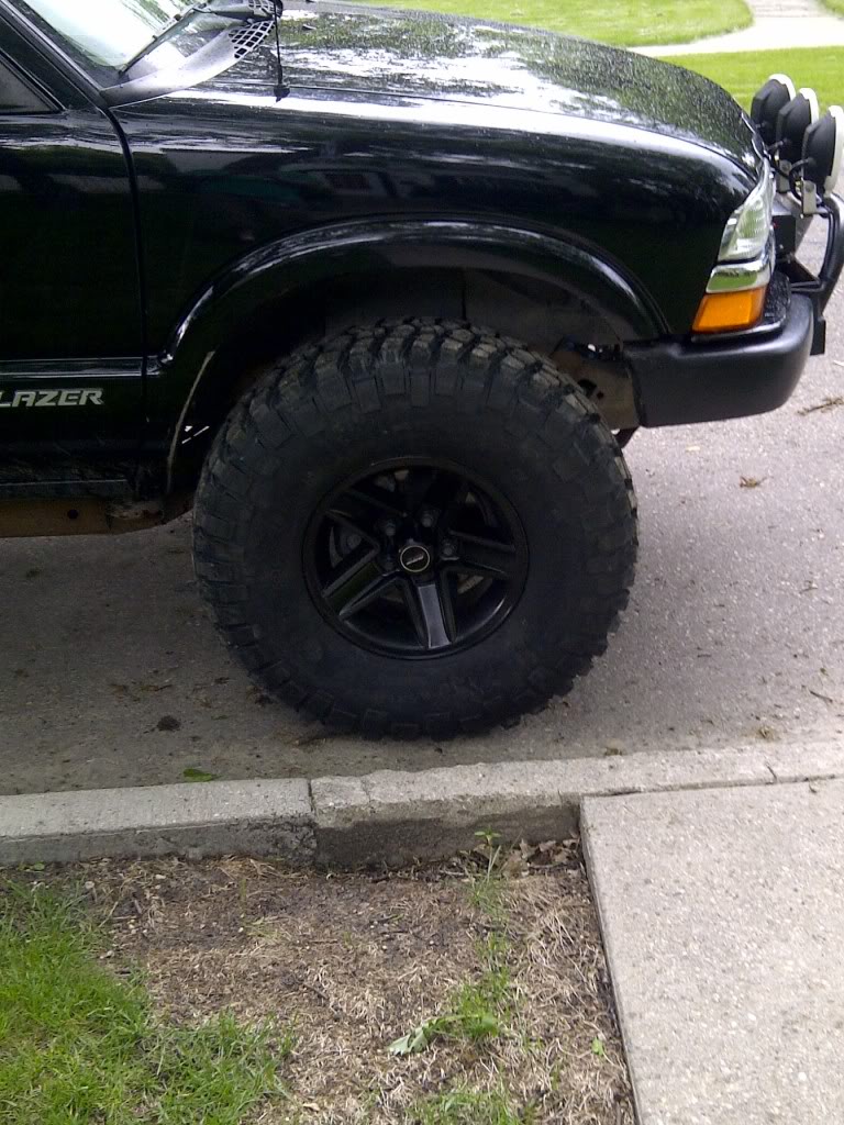

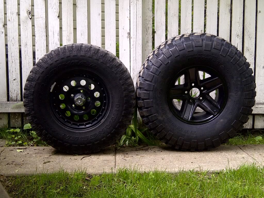

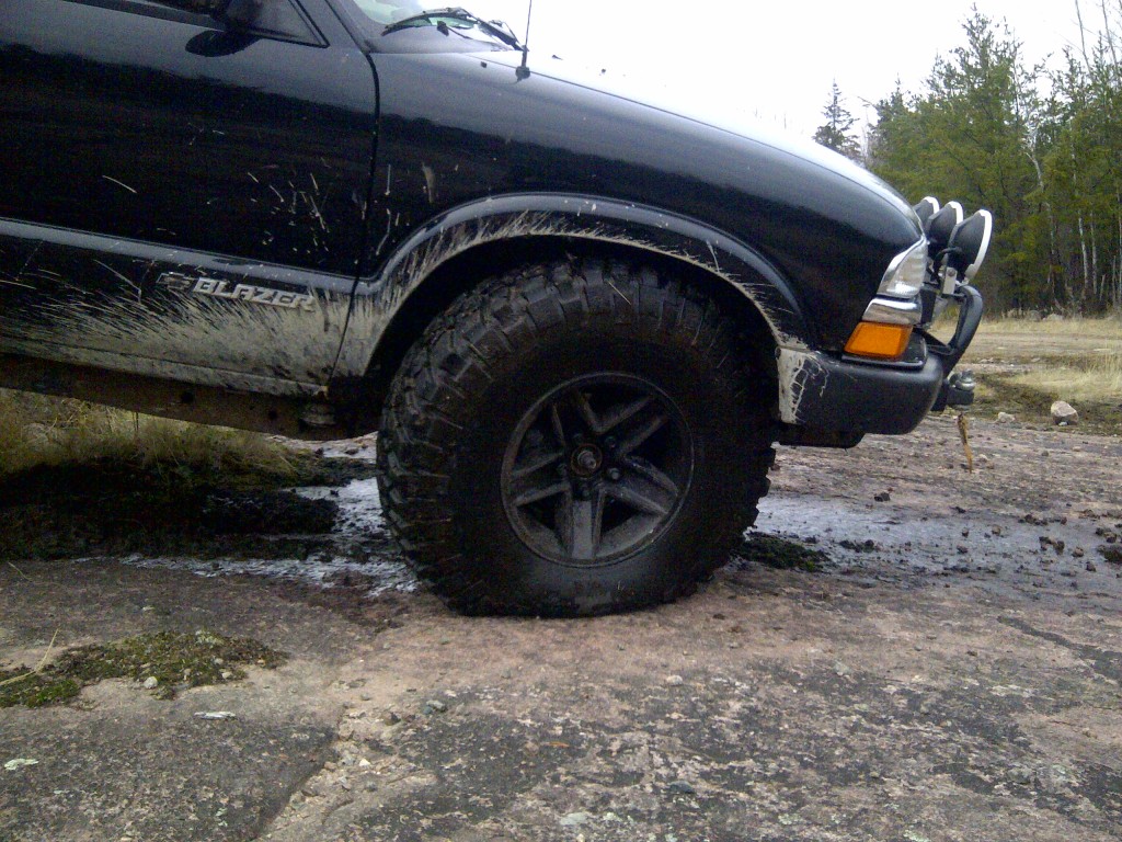

33x10.5x15 KM2's on Z28 rims painted black.
The blazer still had some rake because I only had a slight T-bar crank.
Attached Thumbnails Blaz's 05 blazer-img-20120601-00213.jpg   Blaz's 05 blazer-img-20120601-00222.jpg   Blaz's 05 blazer-img-20120601-00224.jpg

With the wheel turned just right I was still getting a bit of rub on the fender. I also built up the steering stops about 5/16", more is needed. The tires still rub the frame. The frame rub doesn't bother me much so it is not at the top of the list to add another 1/16"weld bead.

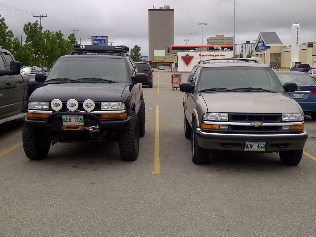

Parked beside a stock blazer.

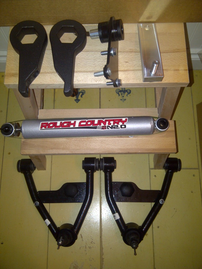

The rake of 2" was bothering me along with the fender rubbing os this was my next purchase.

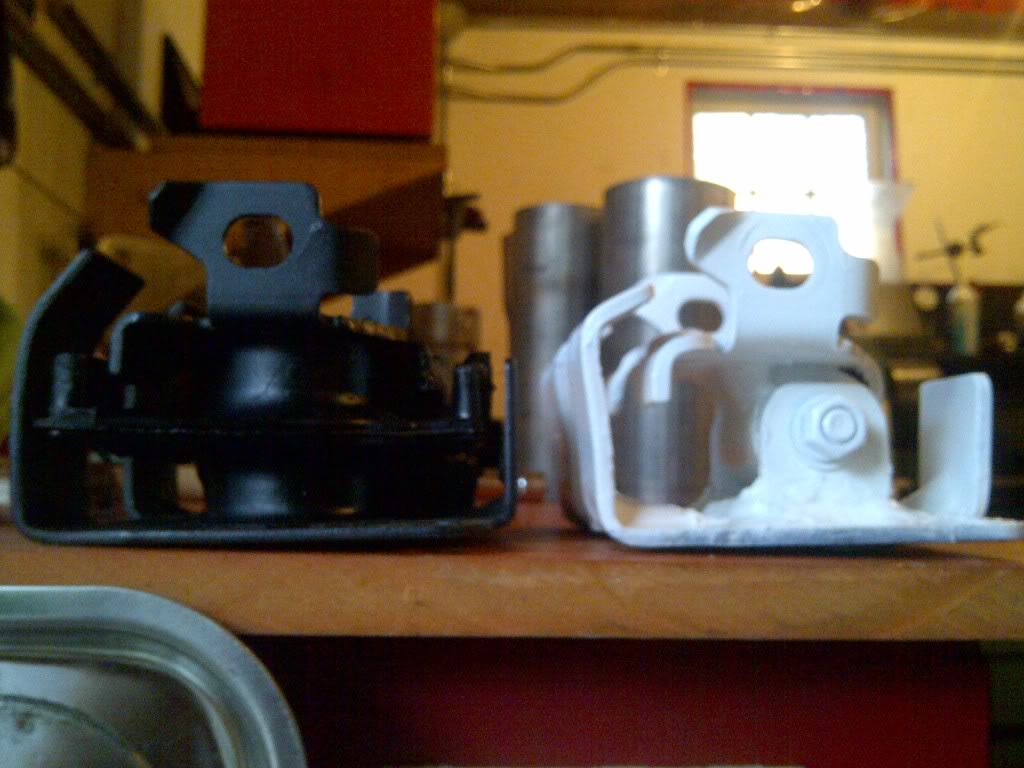

I also had a motor mount go twice so I fabbed one up out of the first broken one.
Attached Thumbnails Blaz's 05 blazer-img-20120618-00266.jpg   Blaz's 05 blazer-img-20120618-00264.jpg   Blaz's 05 blazer-img-20121017-00334.jpg   Blaz's 05 blazer-img-20120806-00301.jpg   Blaz's 05 blazer-img-20120823-00308.jpg

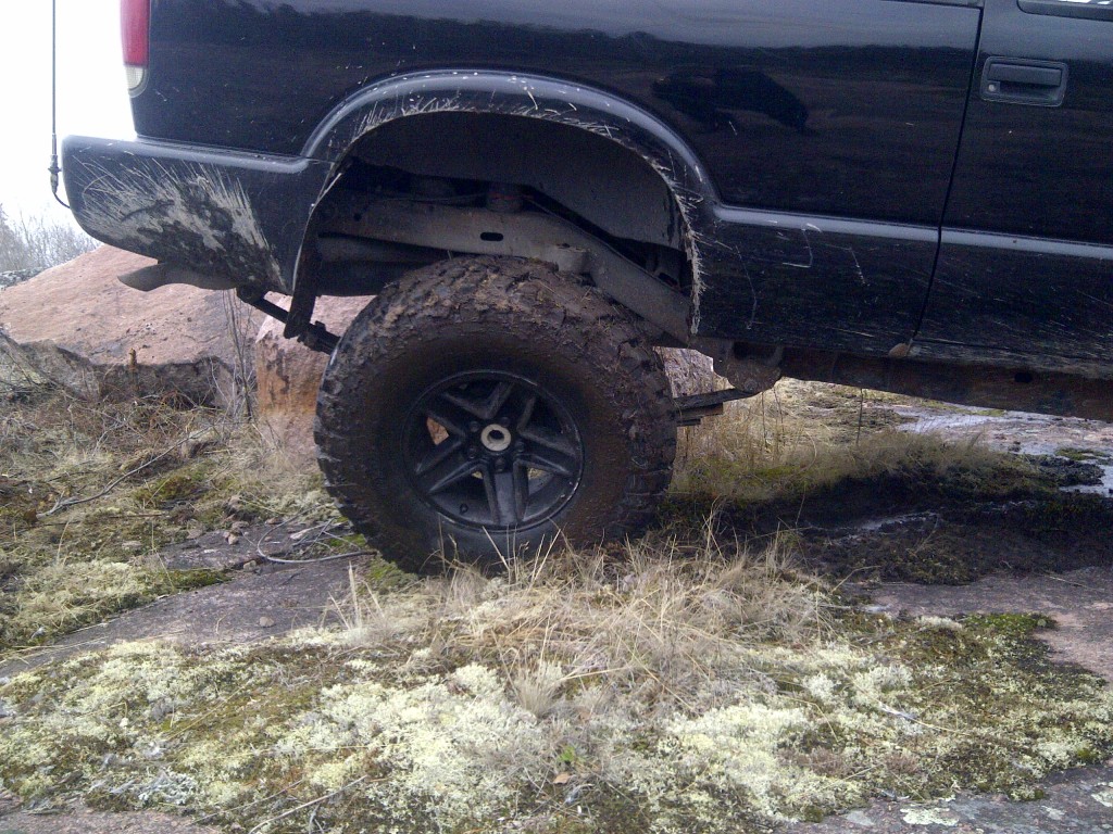

With a whole lot of help from Jared, I was able to install the RC lift.
Link;
https://blazerforum.com/forum/liftin...install-74701/

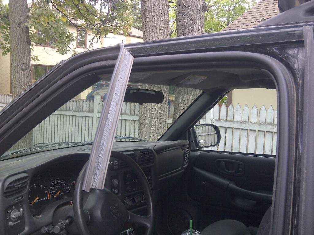

I also repaired the weather stripping.

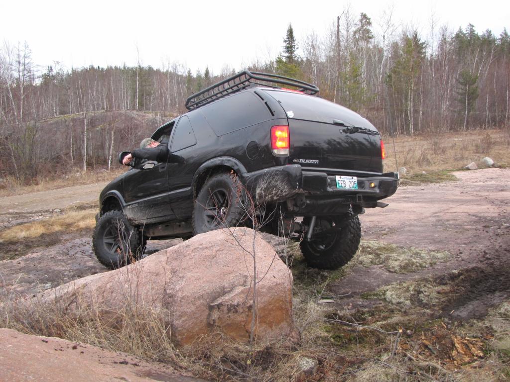

Flexed out the 33's a bit.
Attached Thumbnails Blaz's 05 blazer-img-20120916-00314.jpg   Blaz's 05 blazer-img-20121103-00357.jpg   Blaz's 05 blazer-img-20121103-00354.jpg   Blaz's 05 blazer-img-20121103-00353.jpg   Blaz's 05 blazer-img_2810.jpg
