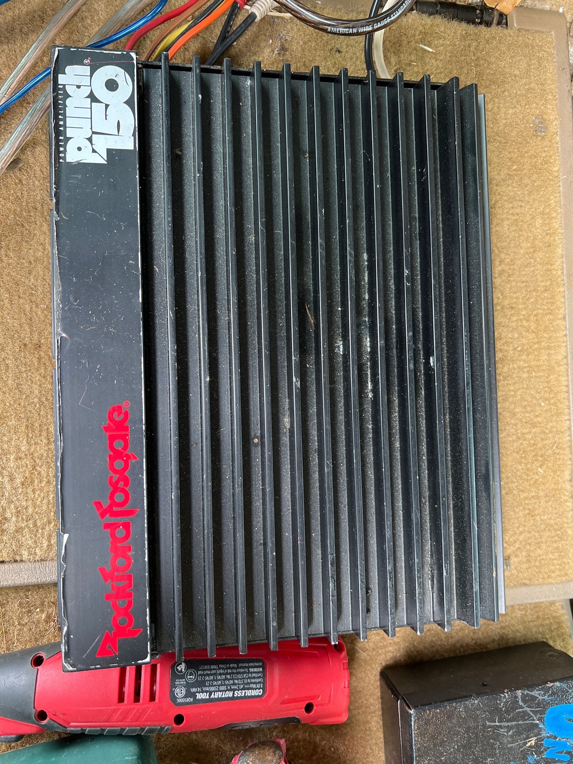

Punch 150 running subs. She’s a little dirty, lol.
