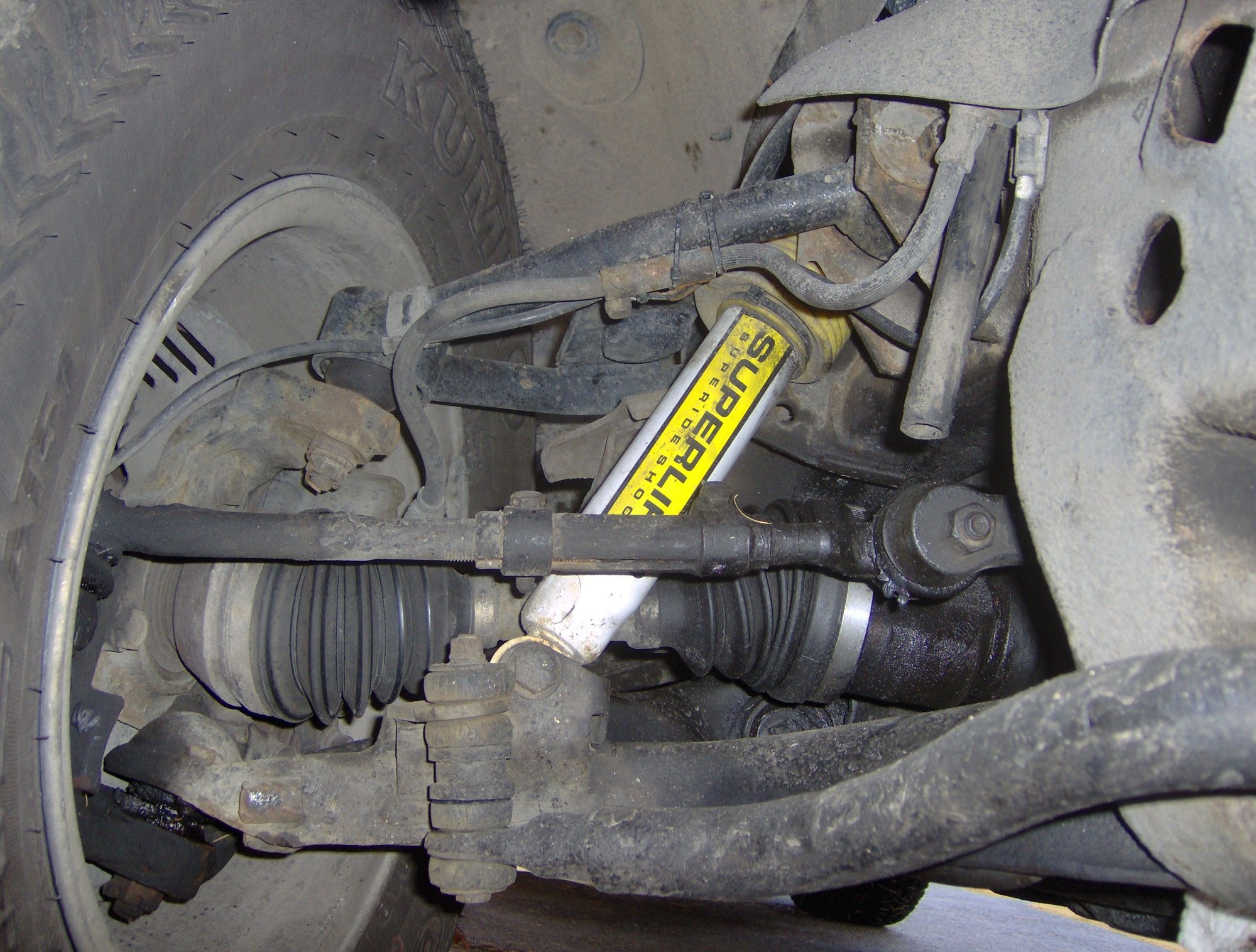

View from front, down low:
Old Nov 17, 2017 | 04:26 PM

front control arms:
Note angle for upper ball joint is about perpendicular to its mounting.
