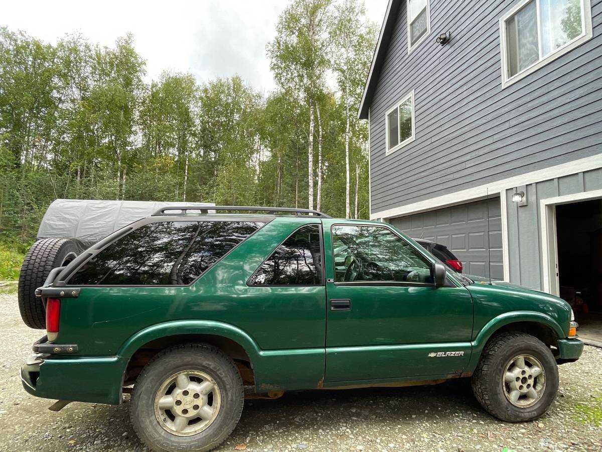

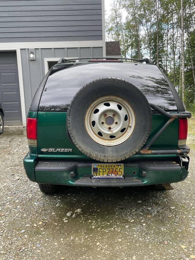

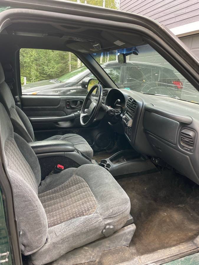

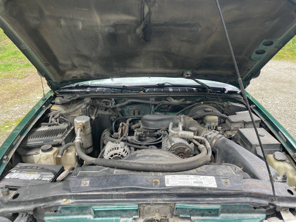

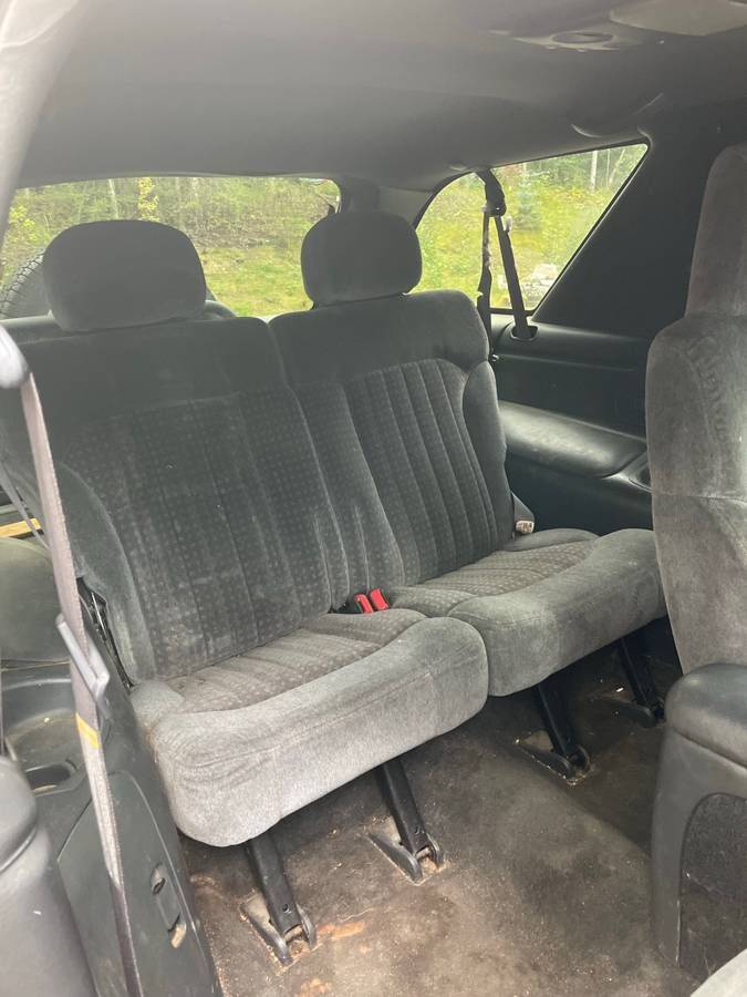

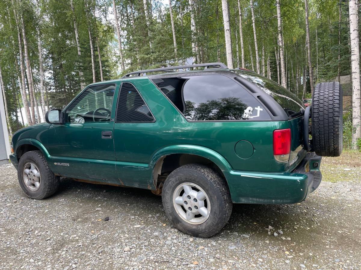

... And for you pic heads out there, here's my starting point.
Not a bad place to start
Say goodbye to the old motor
maybe a 4 or 5 inch lift with some BFGs?
Yes, I see the lower right damage.
I love Jesus, too, but I hate that sticker.
That's going to be replaced, but it's going to stay down most of the time, anyway.
New carpet. New seats, New windshield. New radio / navigation system.

It's absolutely possible, and it's been done many times (not by me). It's a lot of work, though, and it's expensive (which may or may not be a factor for you).
If you want V8 power, but you don't necessarily have to have the latest and greatest, consider swapping in a Vortec 5.7 V8. It's practically a bolt-in. You can use your same engine computer and wiring harness (both with minor modifications), radiator. and almost everything else, too. And you can easily get 300HP out of one of those, without compromising reliability.
