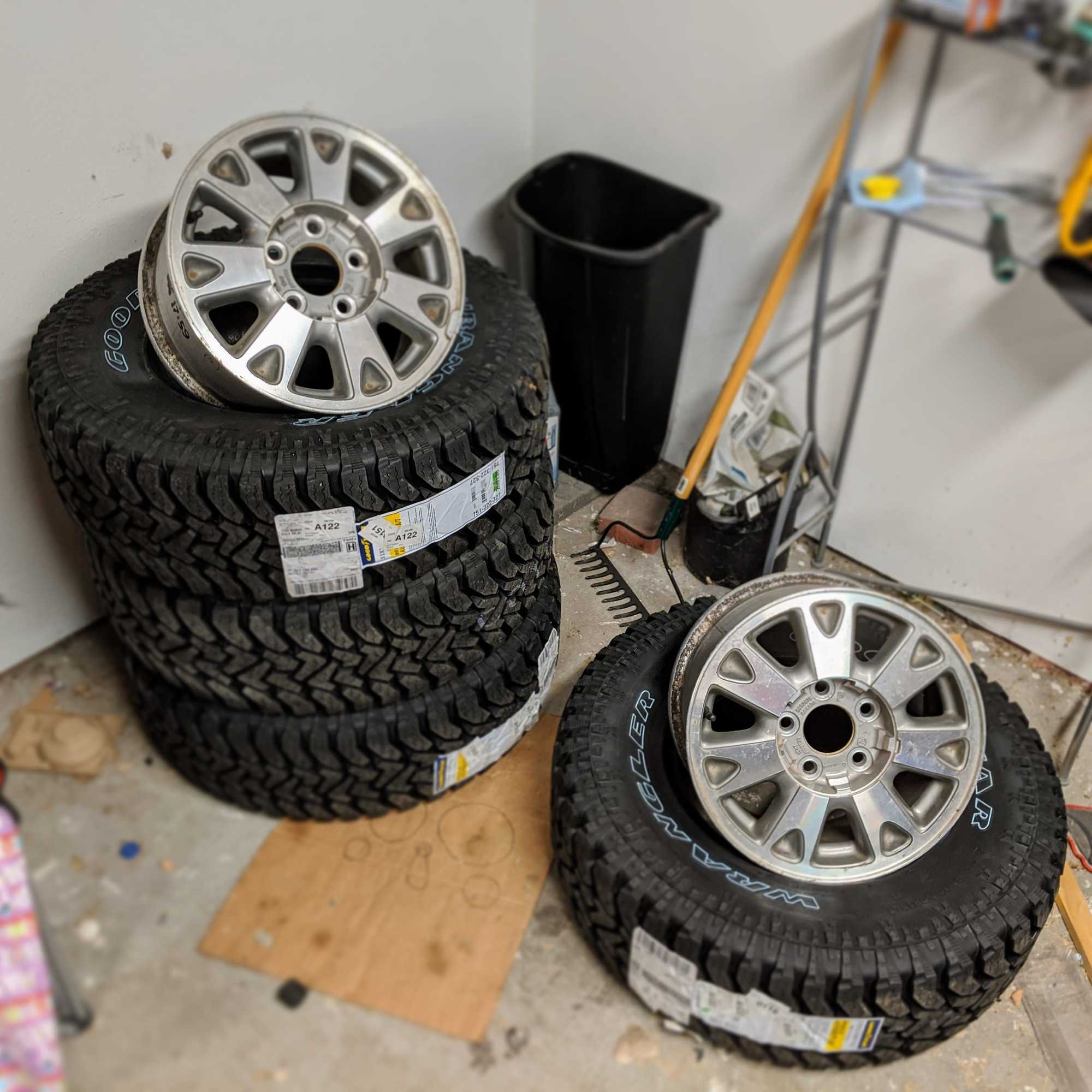

First a little history, I picked up this Jimmy back in 2013 while I was in college with 134k miles, completely stock. For the next 7 years I did a whole lot of basic maintenance and just drove the thing, it has been exceptionally reliable. Took my wife on our first date in the thing, took our second baby home from the hospital, lot of memories.... But after 40k miles the 235/75s were just about wore out and I knew it was time....
Before pic:
Trump stimulus money came in and the 31's were ordered. Went with Goodyear Wrangler Authorities because they're cheap from Walmart. Picked up a PA body lift new in box on craigslist for $50, what a steal.
Body lift wasn't too terrible, I didn't cut or extend the fuel filler hose at all, I imagine that's more required on a 2 door truck. And she's on 31s!

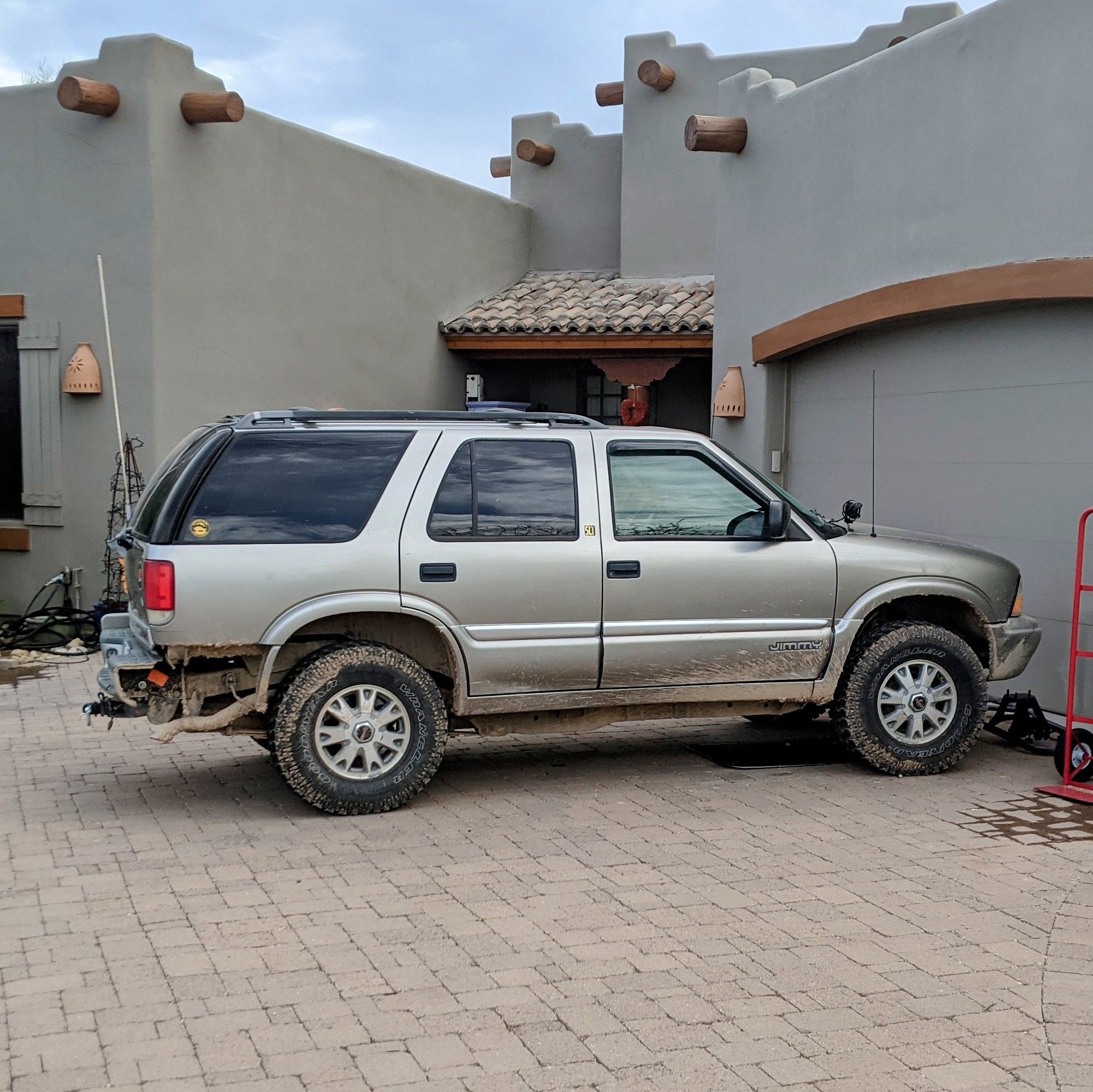

After this I was pretty much ready to hit the trail. Shakedown run occurred on Broken Arrow trail in Sedona, AZ and she did well! I kept up with my buddies overland built Frontier on 33s with minimal complaints!

I did finally get that tire carrier mounted:
Later my buddy upgraded his Wrangler from 31s to 33s so he gave me his spare tire. I also finally got the passenger bumper cap trimmed up to fit around the carrier after 10 months driving around without. The Jimmy also hit a huge milestone. Sept 2022 marked ten years I've owned the truck.
​​​​​​Finally it was time to renew my registration so I went for a custom plate. Officially AT4 Jimmy! At the same time I cut back my exhaust pipe about a foot and installed this tip I had laying around. I think it looks mint.
Took the family out a few weekends ago on a mild trail with my buddies brand new Ranger tremor. 2wd the whole way, just needed to get out of the house and have some fun in the desert without worrying about breaking anything. Stock front bumper is back on. Plain steel one is pretty ugly, I'm gonna get the winch plate mocked up soon and I will probably end up fabbing a new bumper from that.
