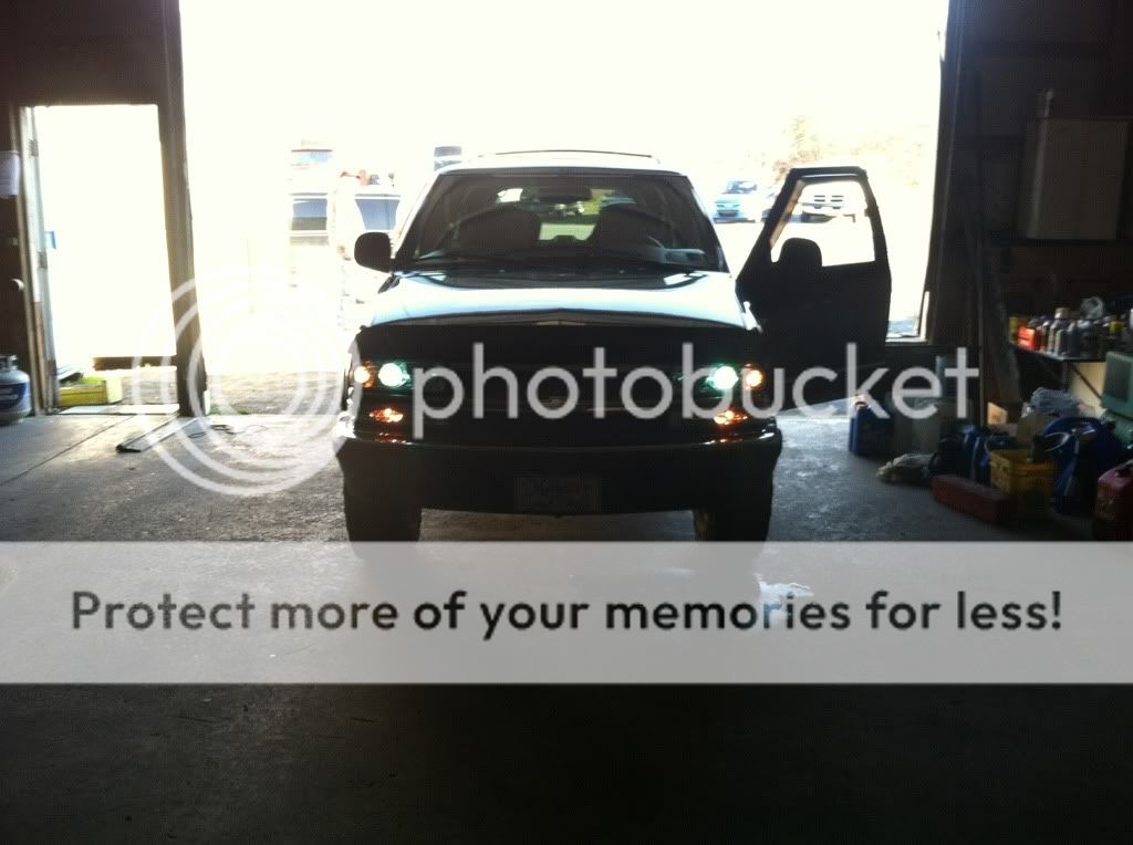

Put the turn signals in and wired up the halo's, I wired them to the little marker lights in the headlight housing, BUT I have this odd "thing" going on if anyone could help me figure it out. I know the little marker lights flash with the turn signals, and when I have the parking lights on the halo's flash as well, but when the parking lights aren't on they don't flash with the marker lights, weird huh? the marker lights still flash, and the halo's are wired directly to the harness that the markers are attatched to.....so they should flash....unless the polarity to the bulbs is reversed when the parking lights aren't on...... But why would GM do something that way?
Anywho, here's some pics.

What a difference that made! Looks good

Even the turn signals are growing on me already..... and for $160 and about 3 hours time (had to modify the passenger side core support because the projector was too deep and didn't sit in the hole) it did make a HUGE difference.
